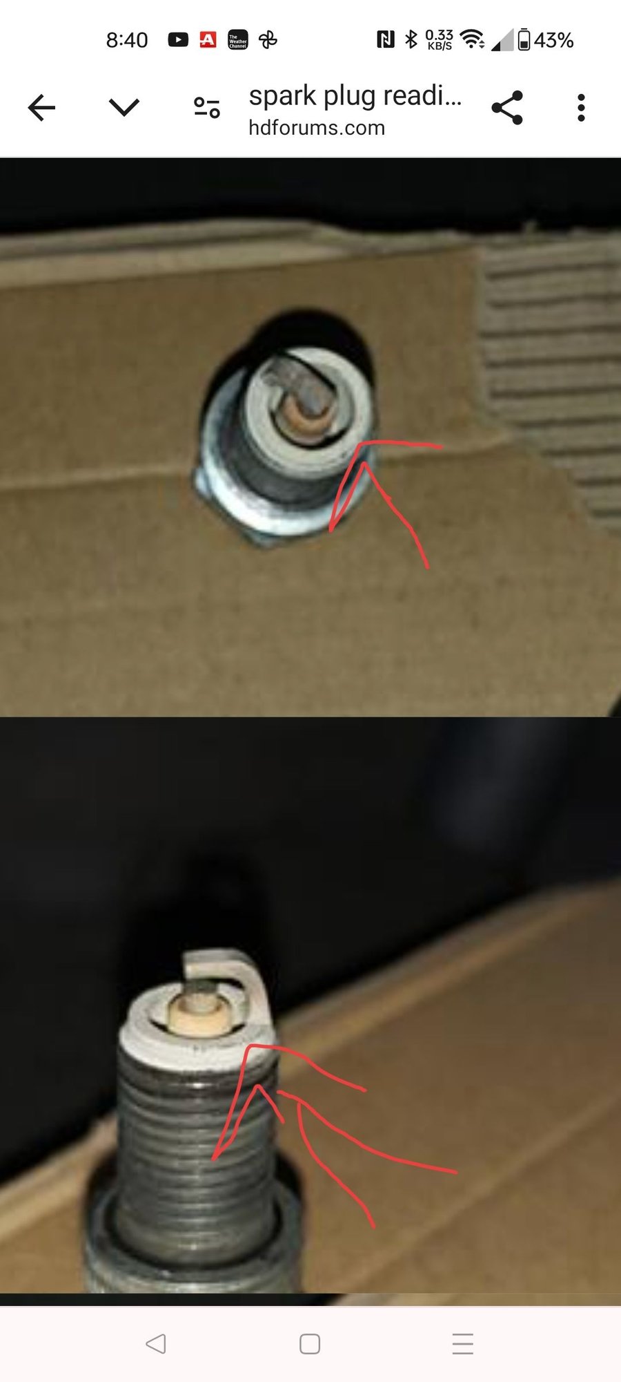

bike runs great..can you tell me if the plugs say the same. over 2k or more miles on these.

Looking down into the plug the porcelain looks good at part throttle and color change in the ground strap indicates good timing.. What I don't like it's how lean it is at idle. Where I marked up the white ring should have some soot/carbon build up not white..

unleaded fuel can burn with little deposits
not uncommon on computer controlled systems
if you look at the gm system, at idle, it leans it out till the point of miss fire and then the computer adjusts, reason why the engine has a miss that you cannot find. it is a little trick they use to pass epa since most emissions are at idle and speeds below 40 mph.
engine condition also plays a part as miles add up. not like the old carbs.
if work has been done and no compensation and the computer cannot adjust then the issue becomes ugly. also failing sensors.

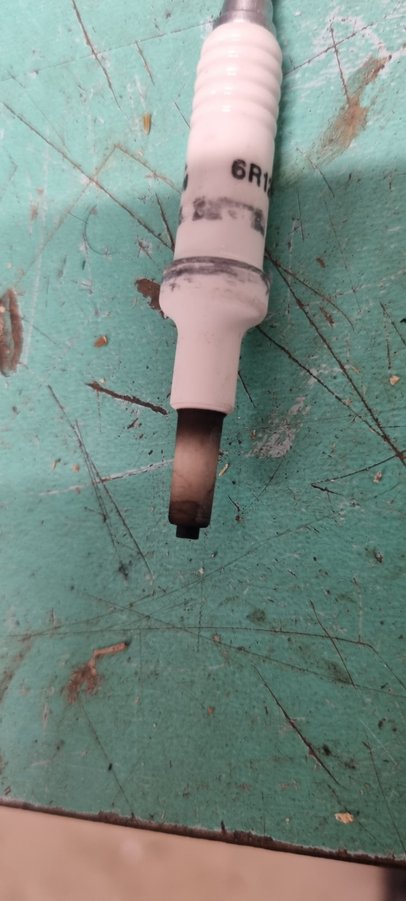

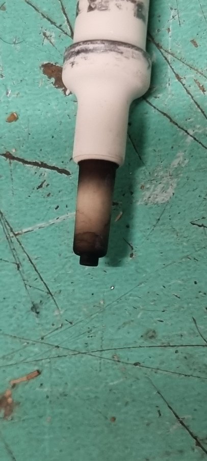

Hey, this is one of the plugs I cut away to check the burn.. As the rpms go up so does the depth of the burn trace on the plug.. Usually at idle you will see carbon deposits on the ring of the thread section of the spark plug.. As heat builds in the combustion chamber it will leave deposits on the porcelain.. The tip of the porcelain would be the lower rpm range, the middle would be above 3000 rpm, mid, and all the way up would be higher temps/higher rpm's.. wot.. The plug shown I thought was a very good example of good AFR'S..

I think they make a tool to do it but I used a hack saw blade, very carefully... The blade will cut the porcelain off your not careful..
This is one I just cut open with a back saw blade.
