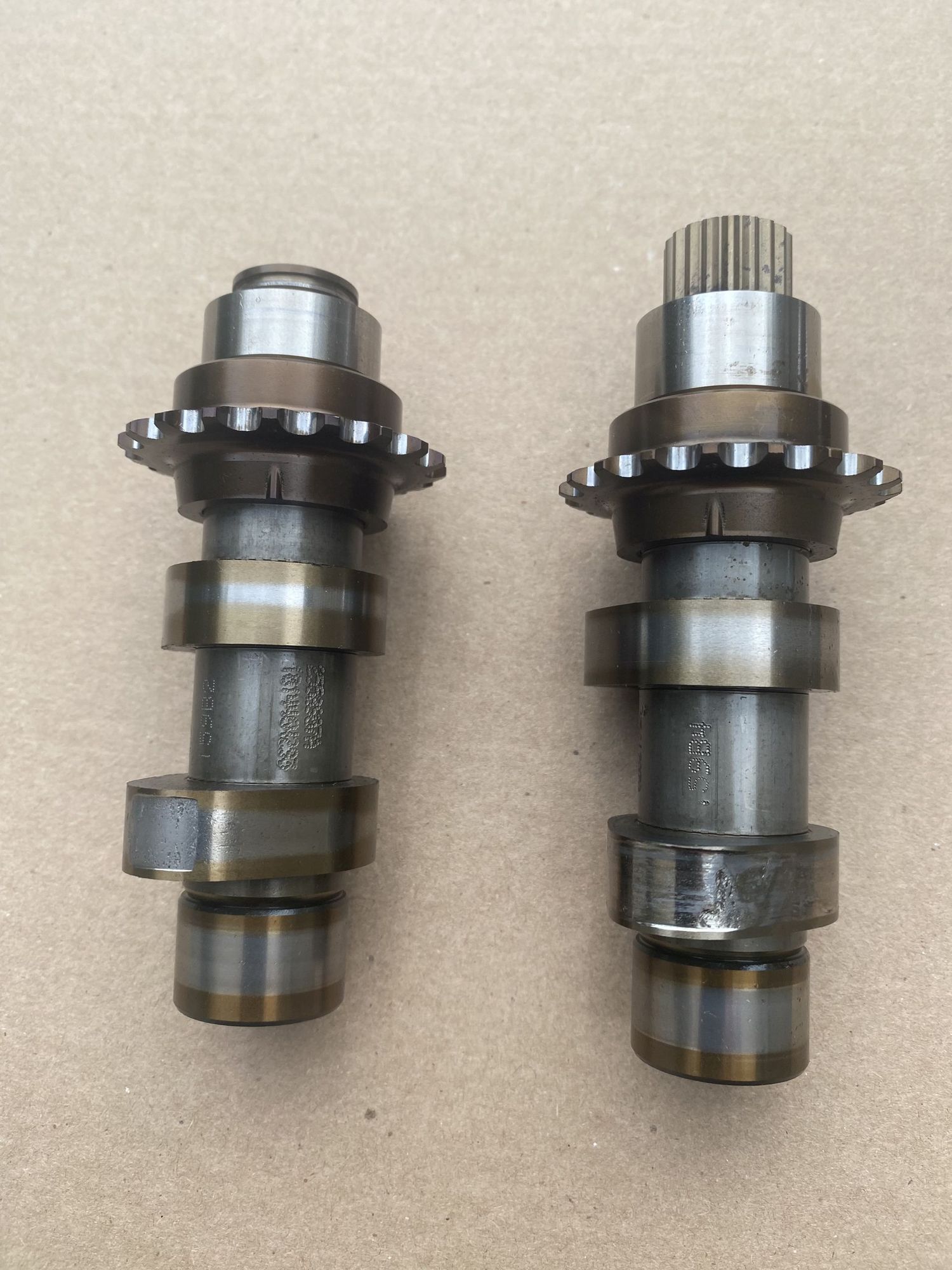

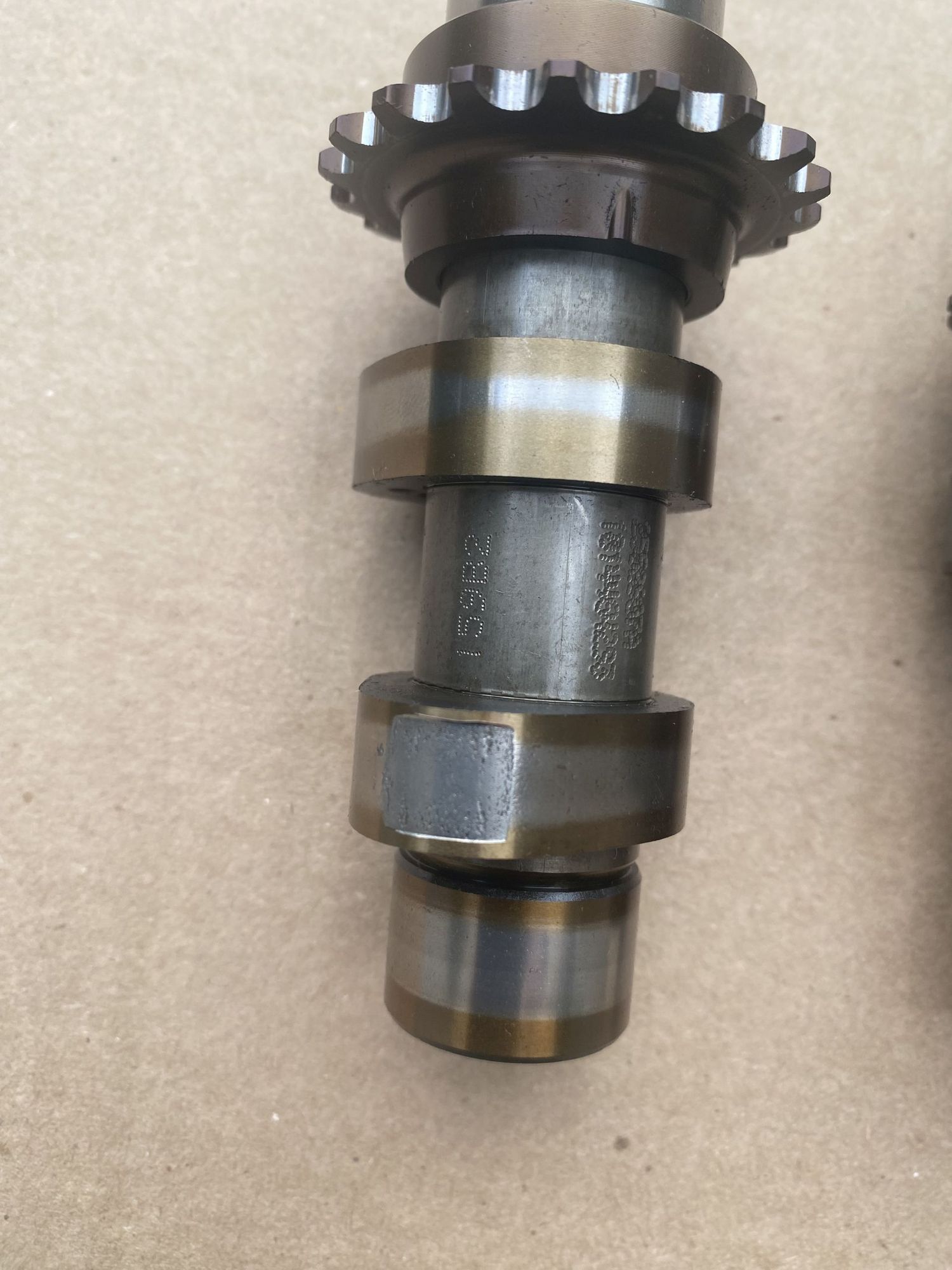

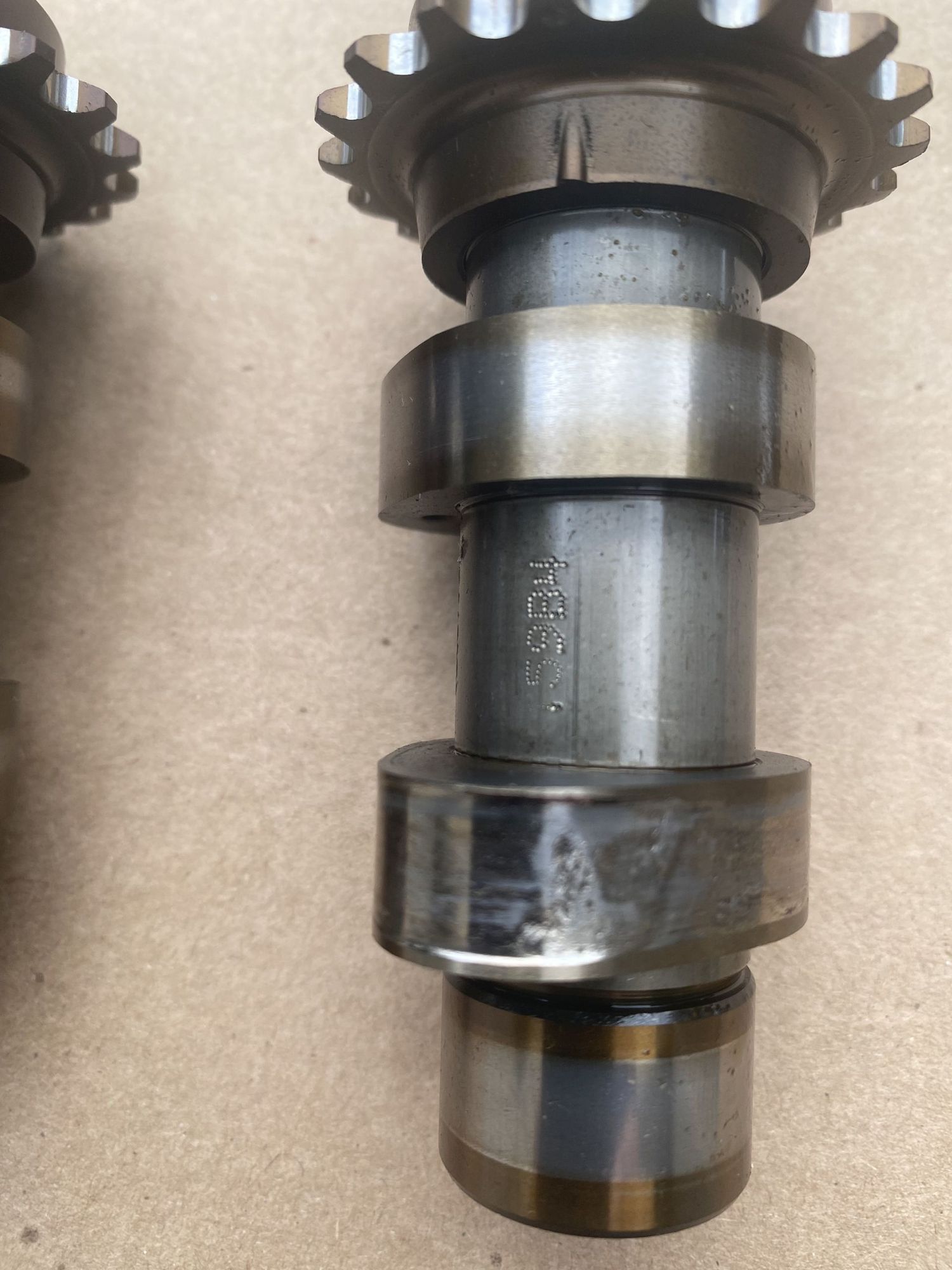

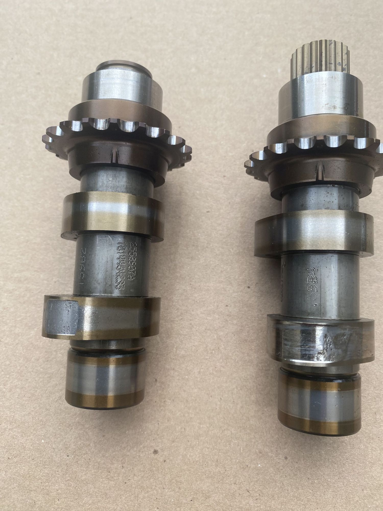

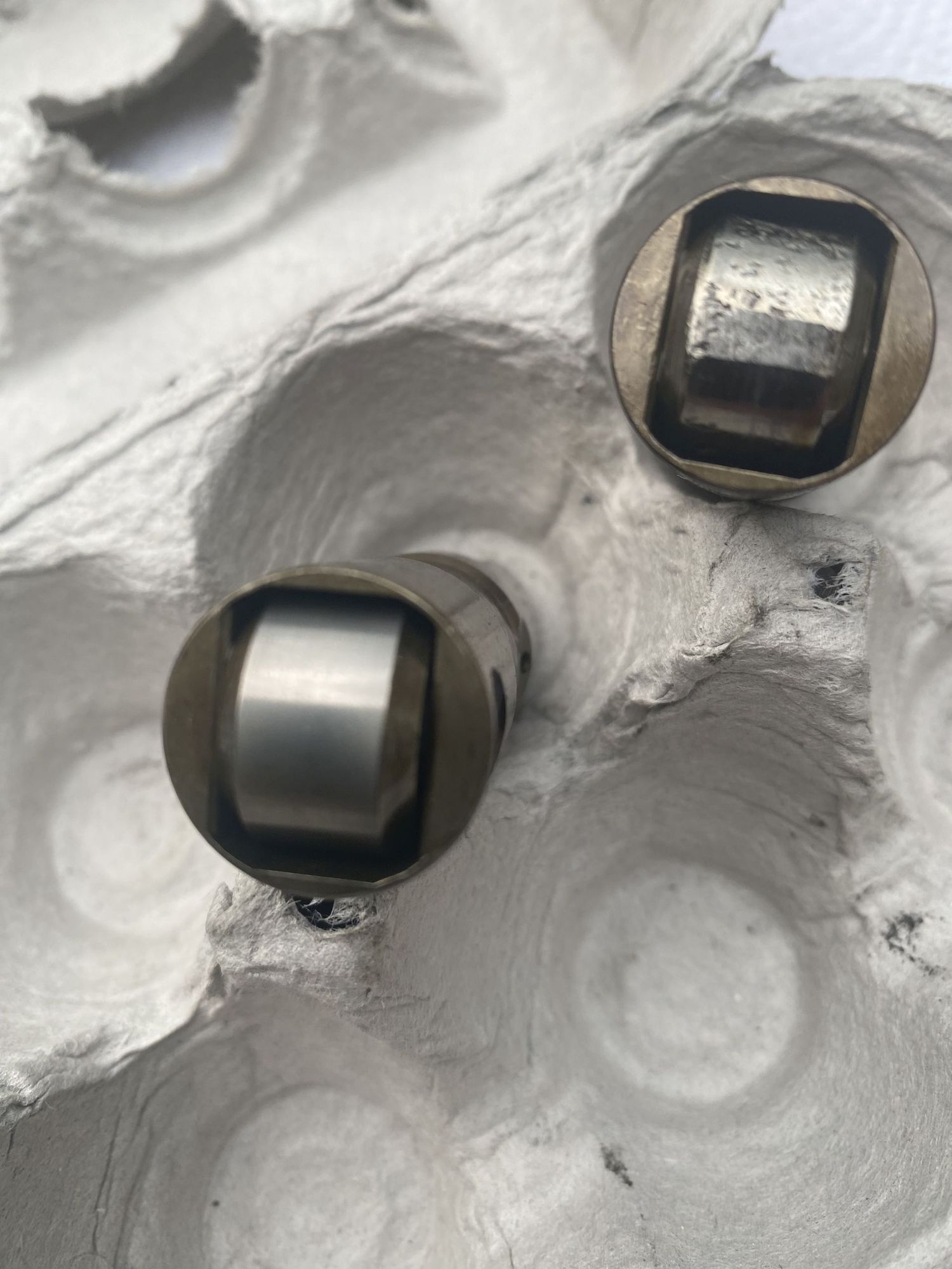

I've attached some pictures of the cams and lifters I removed from the bike. Obviously, that was what was causing the engine tapping sound. As members have said on this forum before (and I didn't heed their advice), tappets/lifters are a maintenance item that should be replaced at the appropriate time.

Wow that cam and lifter roller look like ****.. You got lucky man, real ****ing lucky.. and thank you for the acknowledgment, I appreciate that very much.. But the most important thing is that you're safely back on the road and the bikes running really good and that's the important thing.. Enjoy man and be safe..
