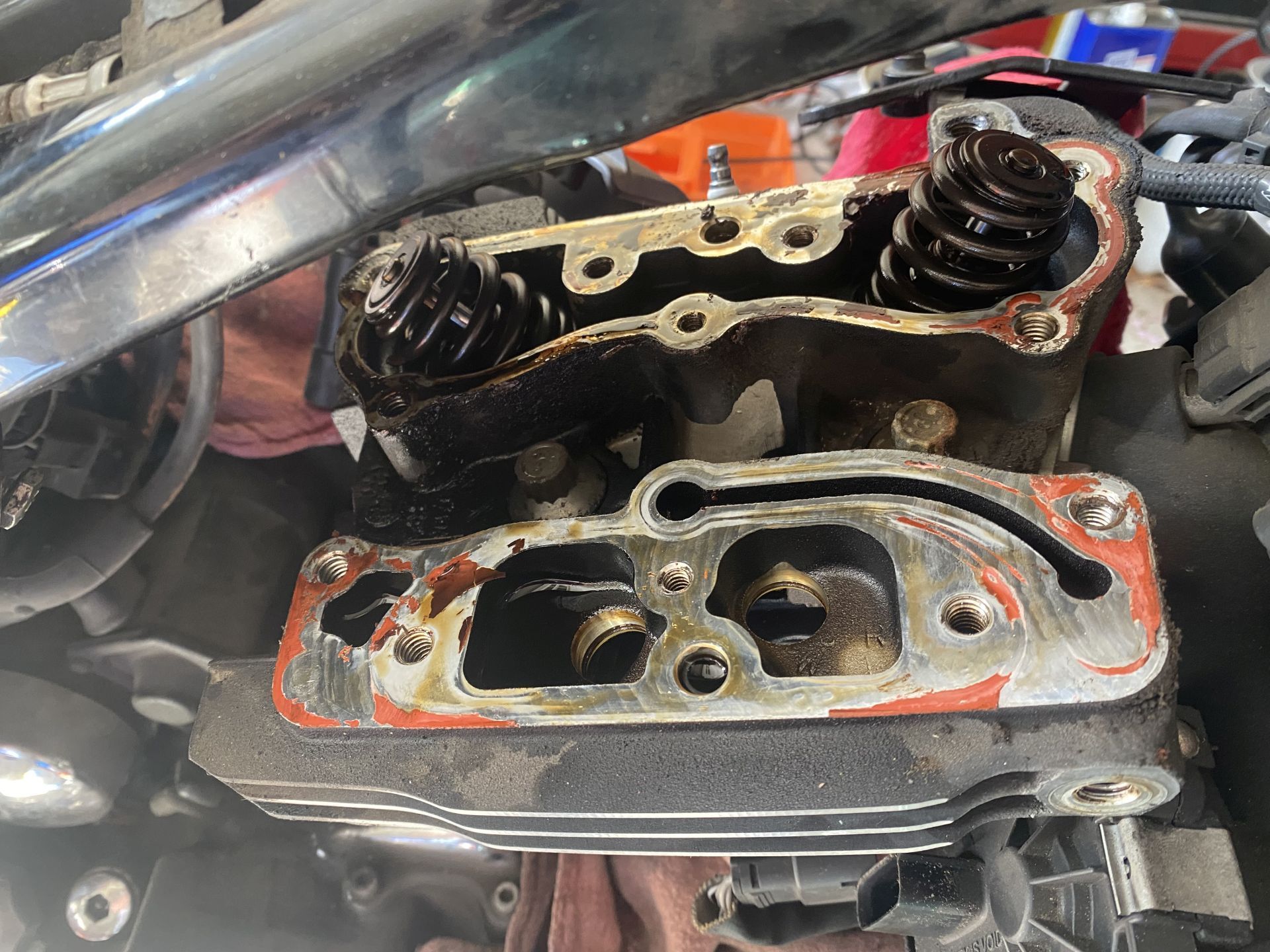

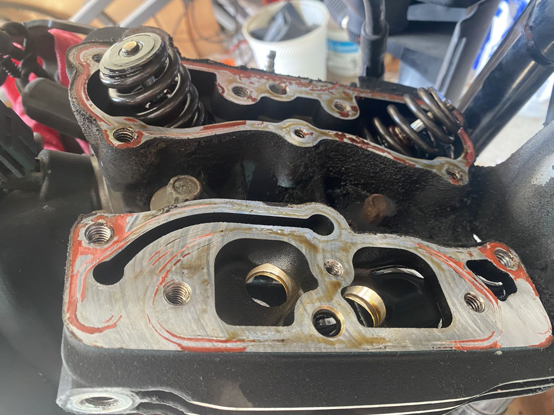

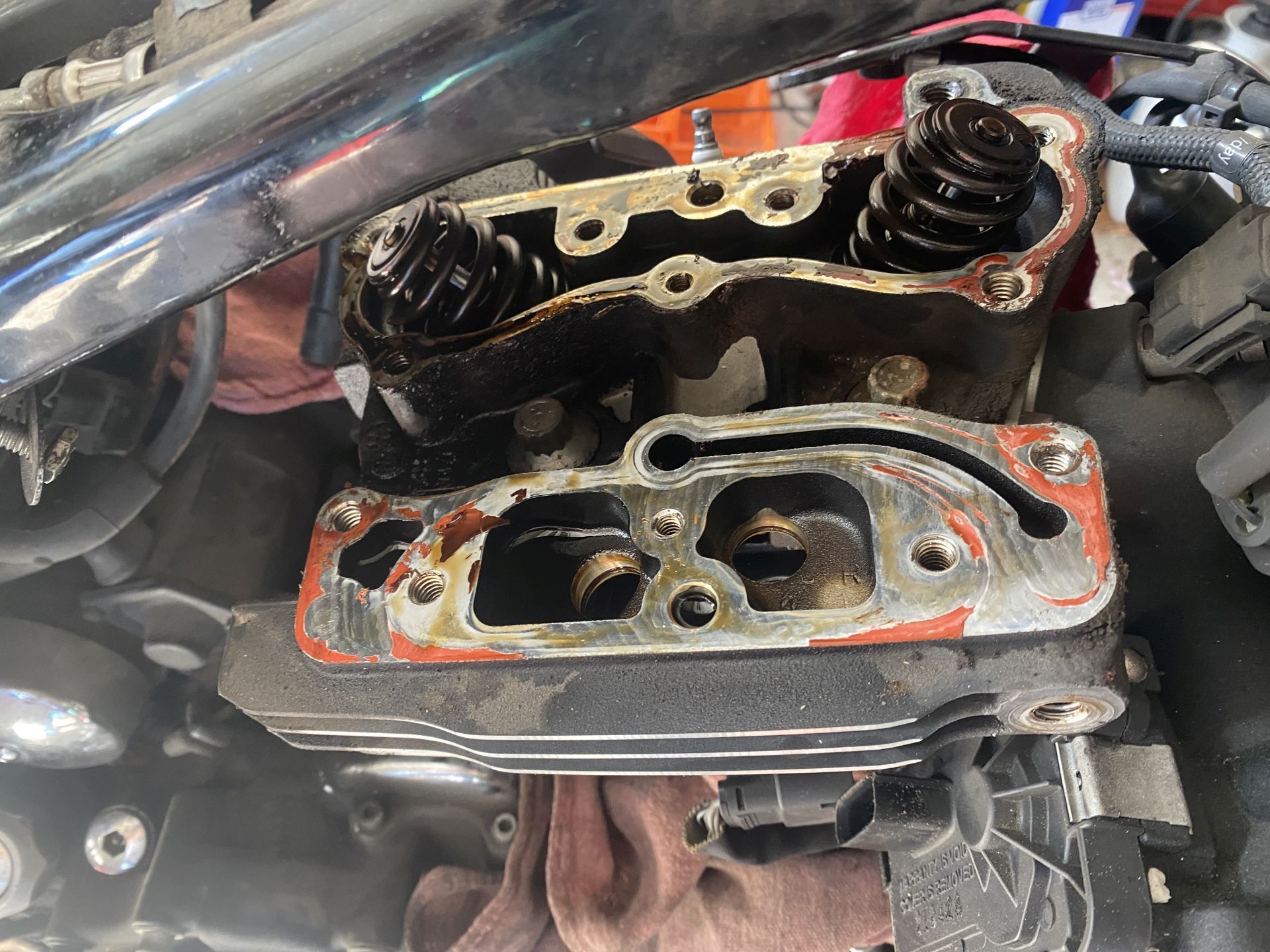

I hear you. I should have the cylinders honed and rings, pistons and head checked. Unfortunately, I procrastinated and I'm short on time.
Still waiting for my Amazon delivery of the Feuling crank runout measuring tool.
Today I pulled out both cam bearings and removed the lower rocker boxes. The lower rocker boxes put up a fight. Took a few dead blow hammer hits to get them off.
Question: What/how do you recommend removing the gasket debris from the heads?
Old Apr 27, 2025 | 04:43 PM
  #50
Max Headflow's Avatar
Max Headflow
Joined: Dec 2005
Posts: 20,032
Likes: 8,086
From: poway
I'd use brake clean on a rag. I've had the stuff peal right off.
