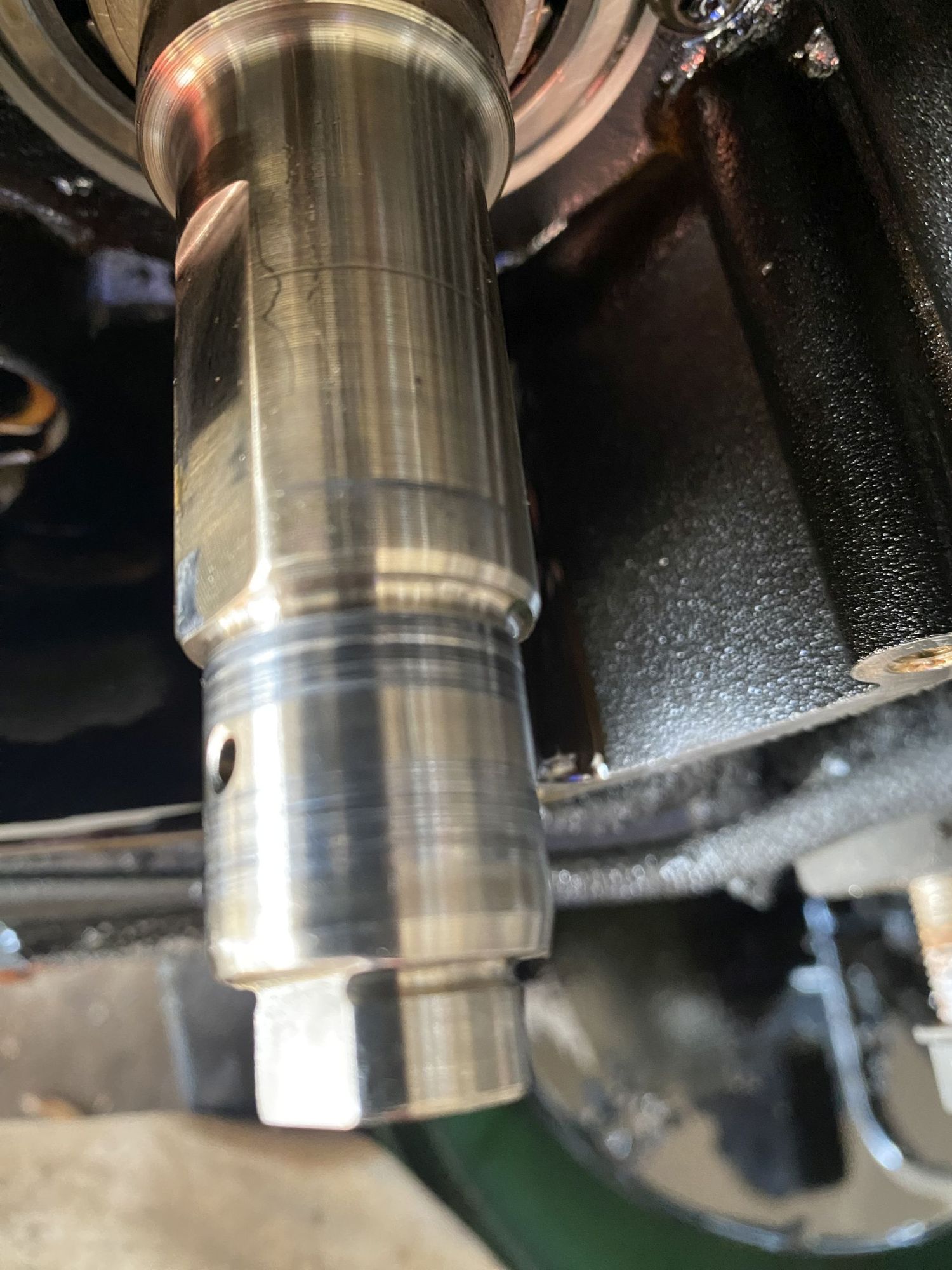

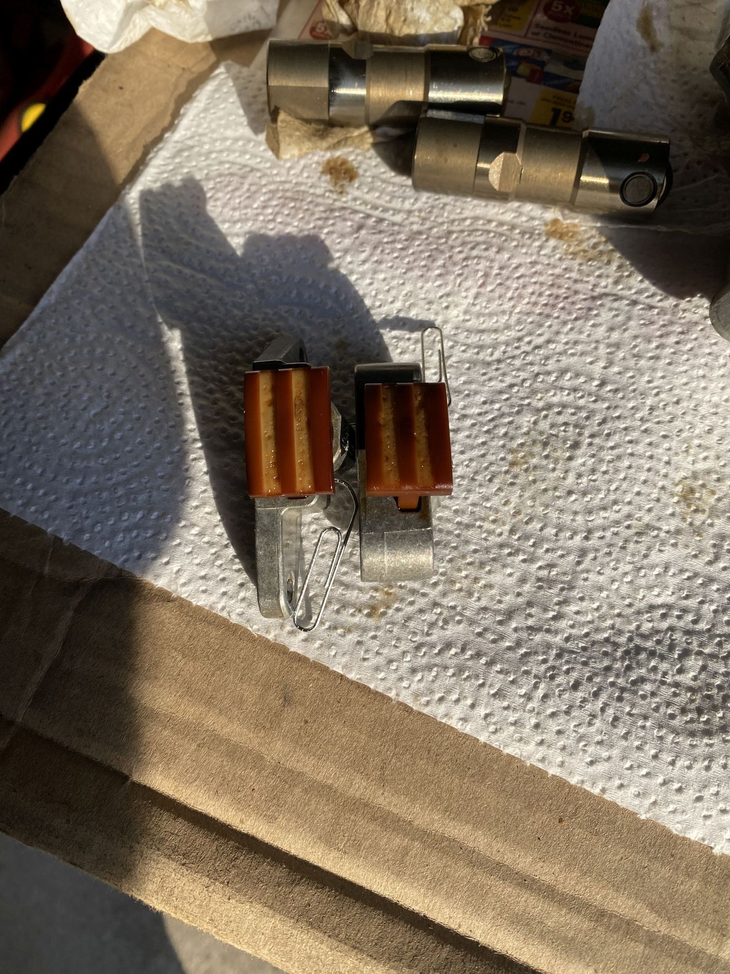

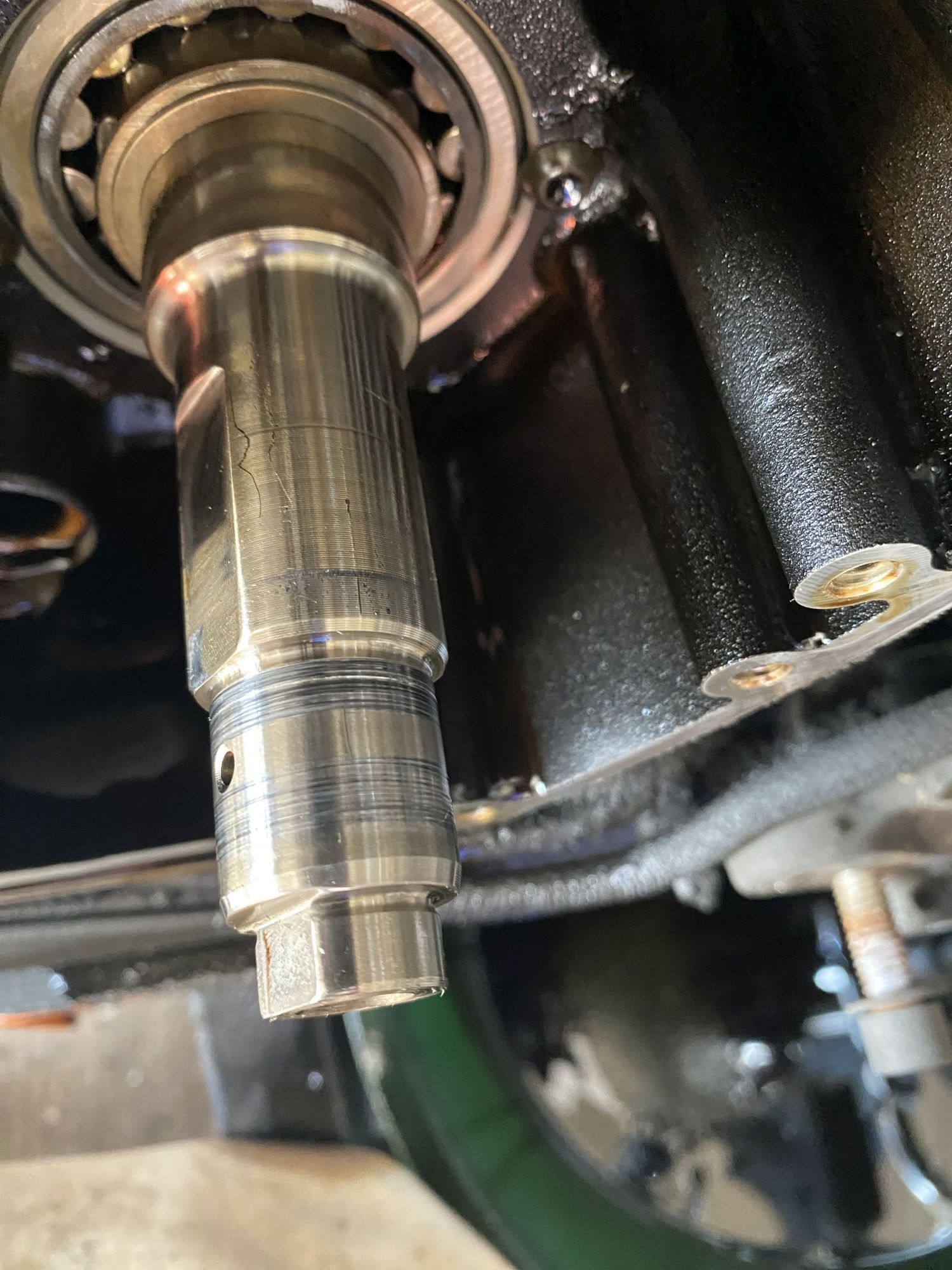

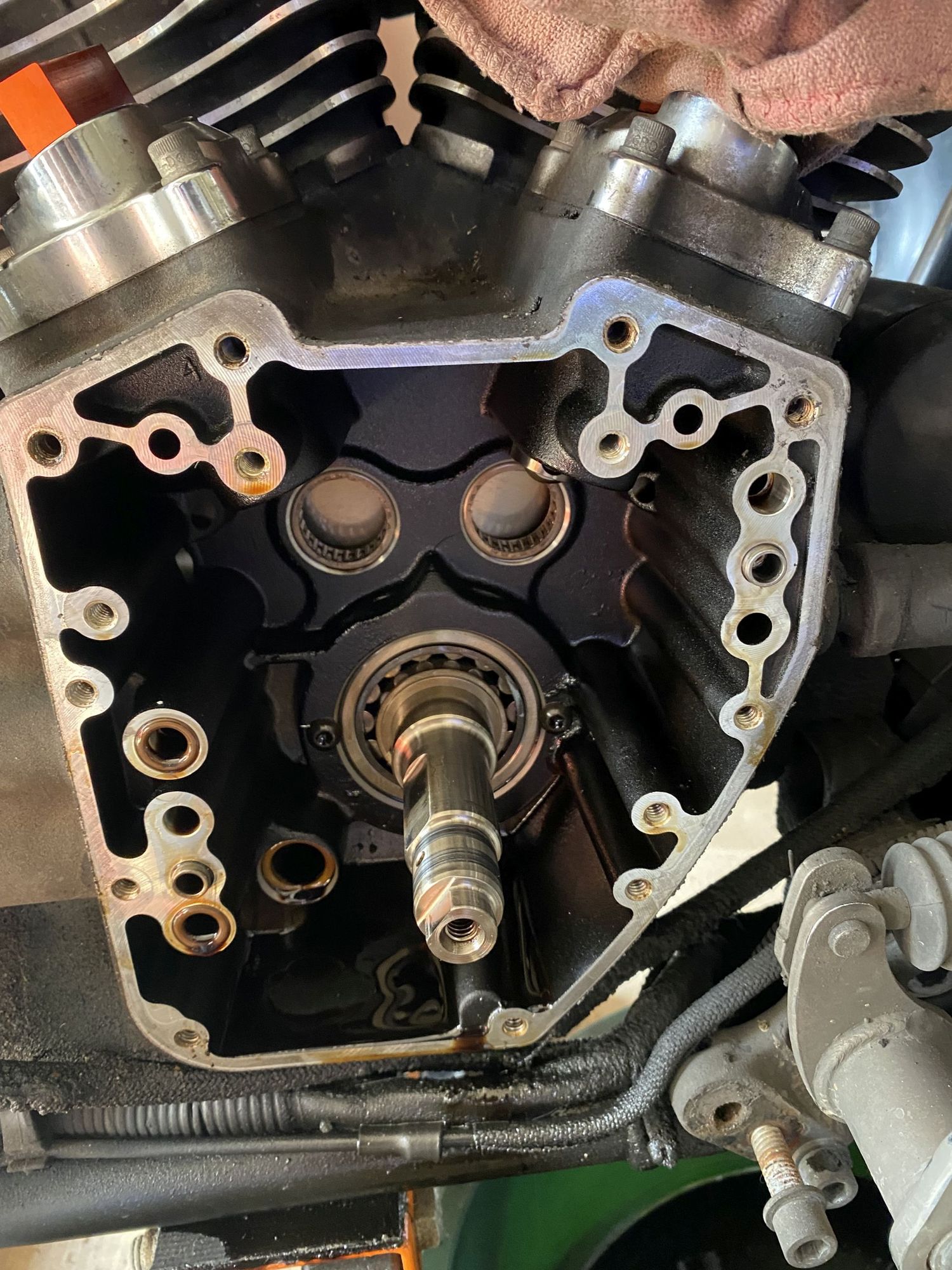

Things have slowed down a bit, summer is around the corner and I'm just getting around to looking into this issue. I pulled the rocker boxes and rocker arm support plate. Also opened up the cam chest and pulled out the cam plate. Removed the two exhaust lifters. The roller on one of the exhaust lifters was sketchy. When I put a bit of pressure on it, it doesn't seem to smoothly roll.
I've attached a picture of the OEM hydraulic cam chain tensioners and the pinion shaft. The pinion shaft feels smooth, but also has wear marks. Is this OK? Remember, 240,000+ miles. This is the first time the cam chest has been opened up and the first time rocker boxes have been rmeoved.

Have you done any runout measurements yet?
