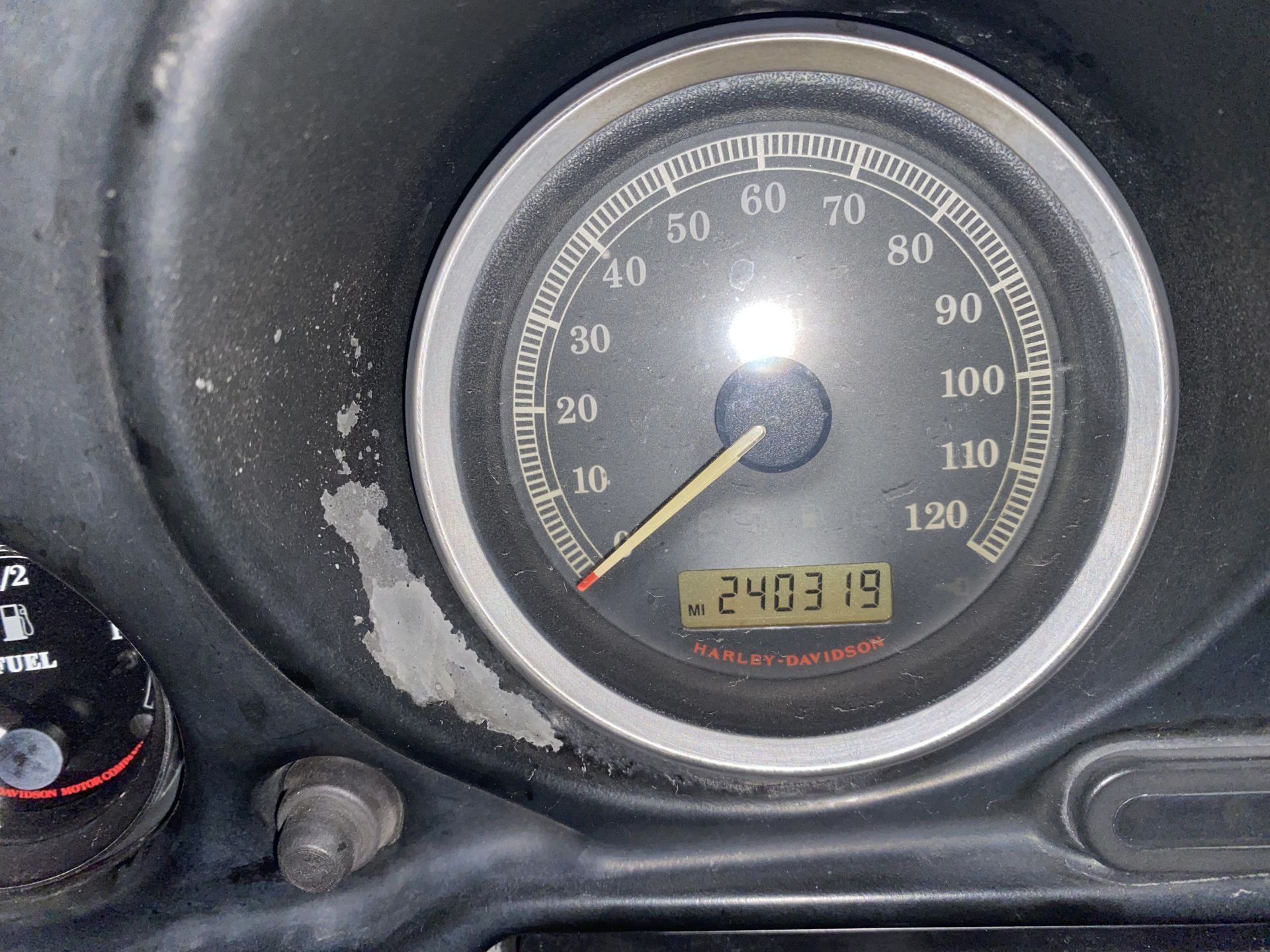

Yes, 240K miles. Never replaced the lifters or tensioners. This bike even has the original OEM stator! Plus I ride with an electric jacket and gloves in the winter and I have a 300 watt amp in the fairing. So, the electrical system does get taxed. I did replace the voltage regulator this past March (2024), when I noticed on a fairly cold lunch run that the needle on my voltage gauge fluctuated a few times sporadically. After lunch my motorcycle wouldn't start. Friend had a jump pack, was able to start the motorcycle and ride it back home. Installed a Cycle Electric CE-607. No battery/starting problems since the new voltage regulator replacement.
Why do you say a lifter shouldn't go past 50K? My 1993 Fatboy must have over 80K on it's lifters.
I think I maintain my motorcycles. They've been fairly reliable.
I'm on my third compensator, OEM compensator, SE Compensator and the second SE compensator.
Last year (August 2023, 207,714 miles), I had to replace the crank sprocket shaft oil seal since engine oil was flowing into the primary.
And I only use Mobil-1 15-50 car oil from the 5-quart jug at Walmart.
