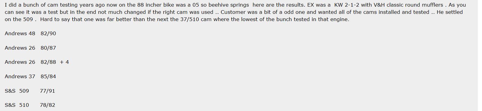

Can't go wrong with the Andrews 26 or the S&S 509 in a stock or Stage I TC88; the 509 would be my choice but plenty of others are happy with the Andrews 26. If the INA inner cam bearings have not been replaced with full compliment Toyo/Torrington B148, that should be part of the project. No mention of mileage or carb/EFI. If lifters are OEM with high mileage, might consider replacing them with a set of Johnson Hy-Lifts from Larry's Motorcycle and Machine, AKA WFO Larry; probably the best on the aftermarket at the moment. If carbed, might need a re-jet; if EFI, investing in a dyno tune would be a good idea if funds are availble.
I did not do the testing; a post from a tuner on another forum a few years ago; just sharing information.
