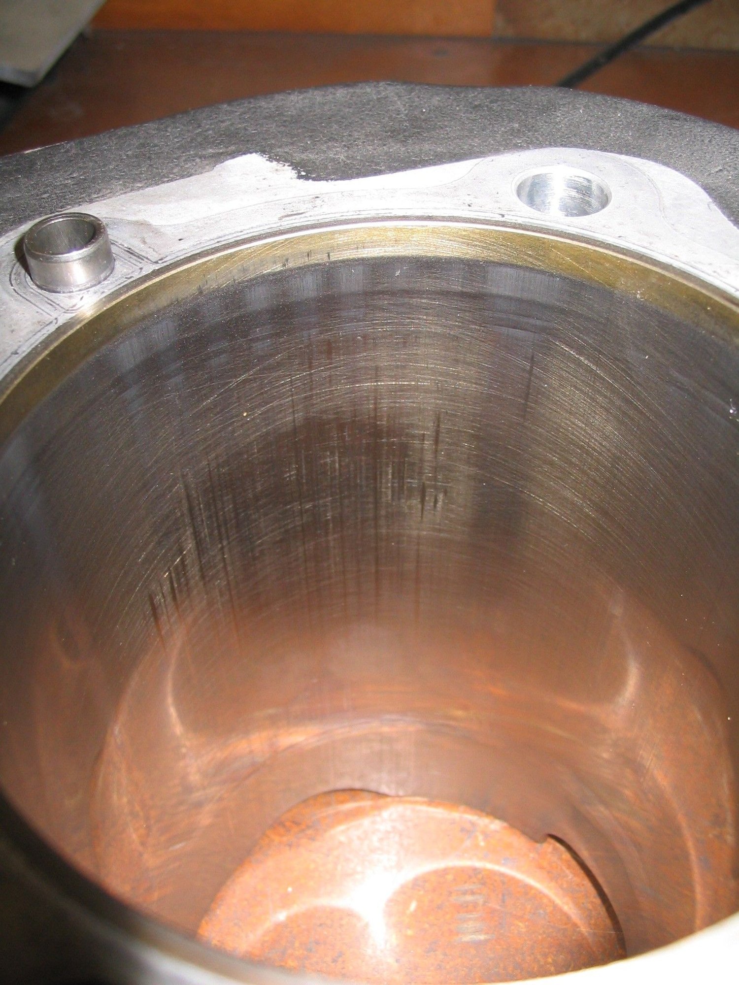

Originally Posted by Rpaulickjr
Ok, I will definitely get an inside micrometer to measure when I check these rings, this new kit is a se kit from suburban speed which is a Harley shop that does the king of the baggers bikes, new cylinders with fresh bore and they say the rings are gapped and just need to be checked, when I did them last time I just took revolutions word on the 3.93 bore size, but didn’t account for the nikasil coating in the bore, that coating breaks down fast as you can see in the cylinders, I gapped rings based on the size listed on the bore and may have been a little tight, thank you again
If you are using moly filled rings you found your problem. Get the rings from either wiseco or RP. Wiseco rings are SS and softer. Moly and nikasil don't mix.

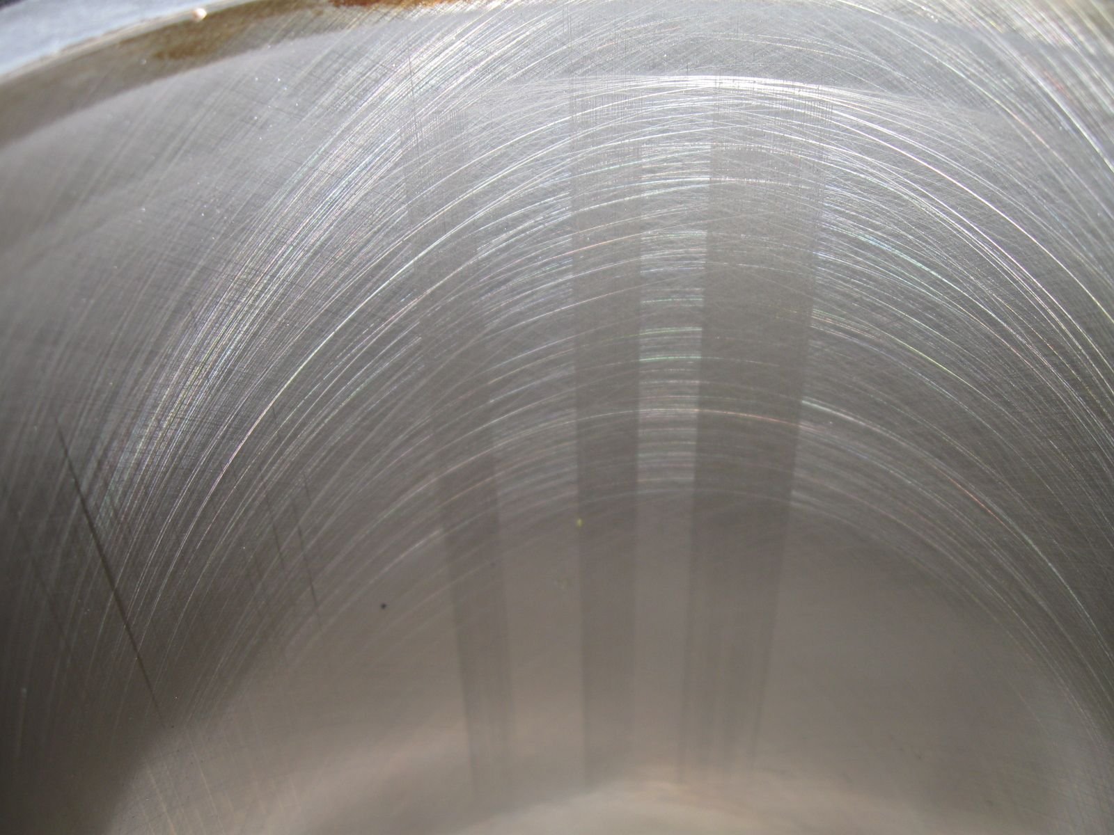

Here's a similar pic of a RP 4 1/4 bore nikasil cylinder on my 131. It was caused by using CP pistons that had moly filled rings.. These cylinders had a slightly different surface finish on them and less miles. RevPerf later changed over to Wiseco with SS top ring which this motor is using today.. Add: Cylinders were honed slightly with a ball hone..

This is typically what you get from running too much fuel and timing..
