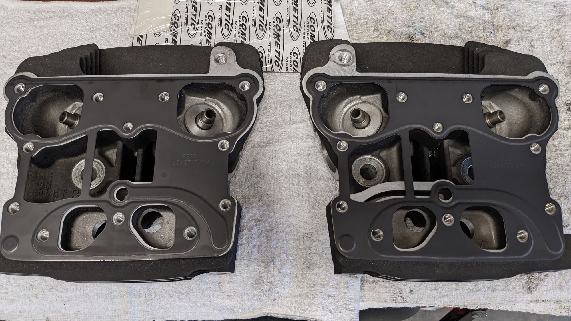

Here is what happens when you don't flip the rocker base gasket.. See the passage that don't get covered, head on the right..

So you are the one with the bad info? Figures.. Where's the blocked hole?
Really trying to figure out what you are getting at? Are you saying the pic I put up is not the correct way to put the filter? As I remember when you look at it wrong it is pretty evident it is wrong

Originally Posted by Rounders
Ok, what?
The rear cylinder gasket is flipped so it's not covering the breather channel like it should. Your being toyed with like some people like to do.
As my picture showed.
