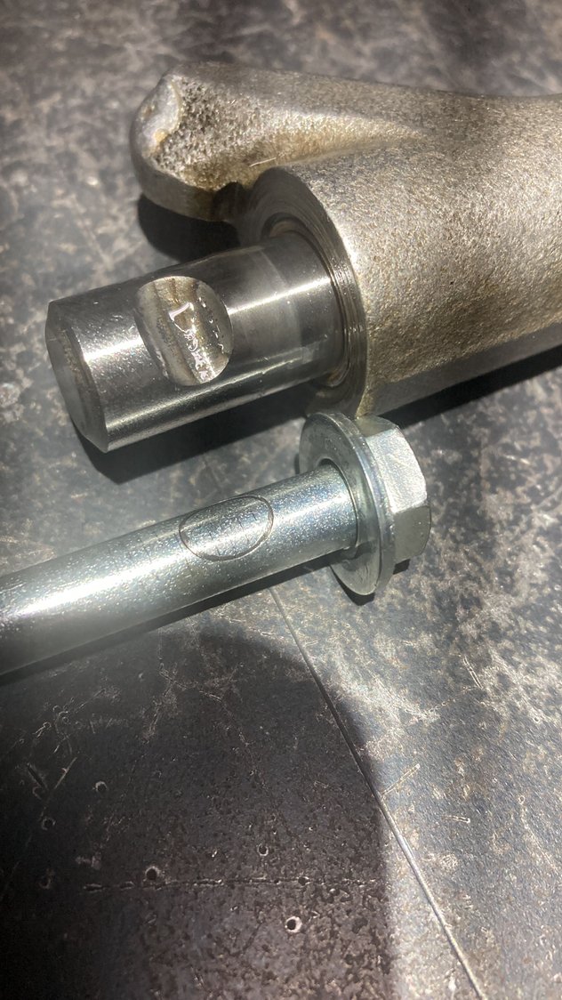

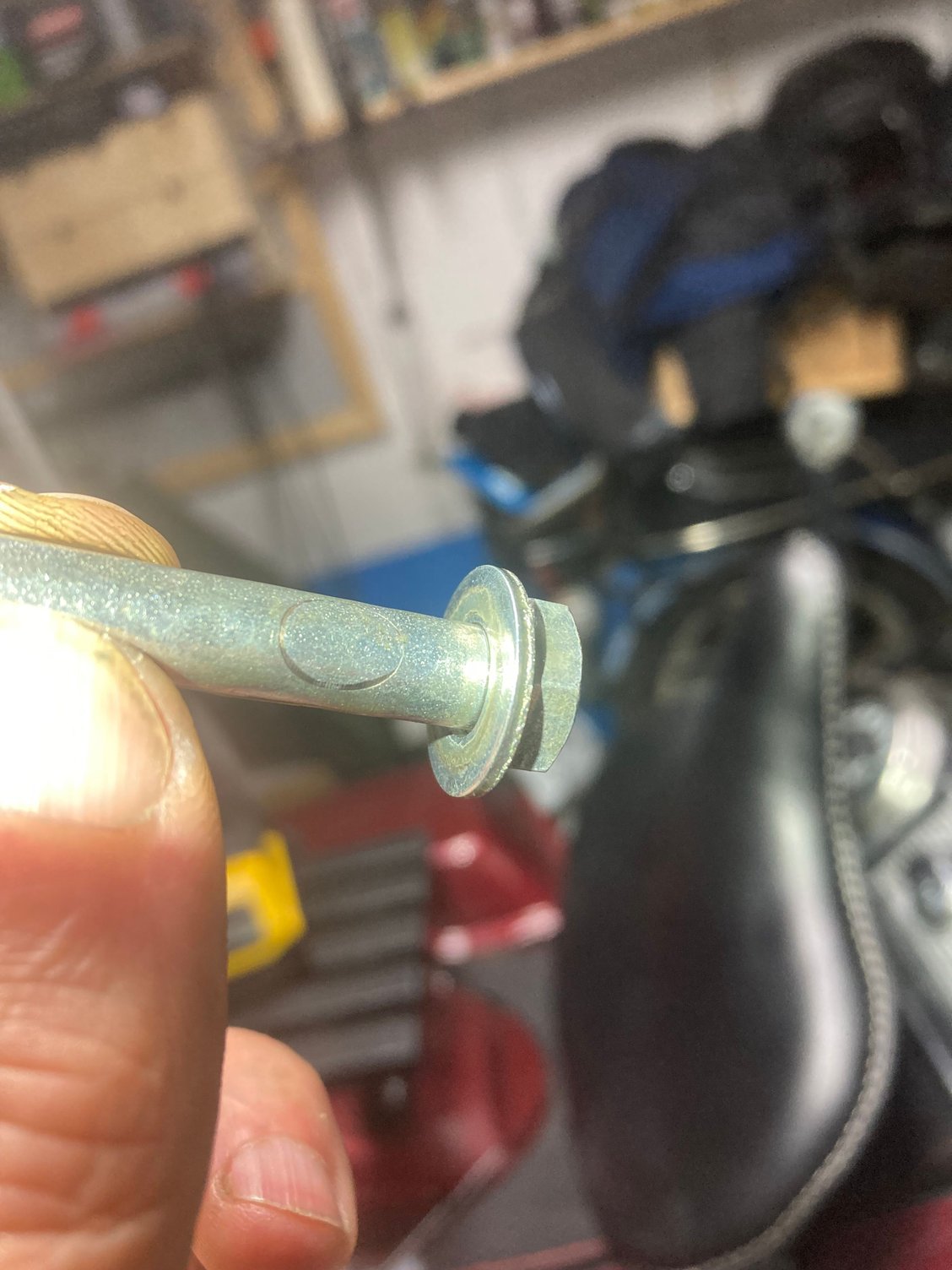

Well… no matter what’s been said in here the fortune decided otherwise.
started pulling the rockerboxes and to my great relief found the culprits.
look how deep and consumed this is - the front right exhaust got elongated or something as it was almost finger tight.
there is no play anywhere - the rockers are rock solid radially. Axial play is 0.3mm - will shim it anyway.
so onto the lathe and will make shaft locker bushings. Then it is just a question of getting it all buttoned up. The oil brass glitter must be the nose cone then.
I heard about rocker lockers btw but never in my life would I have thought spinning rocker shafts could make this kind of pronounced noise. I use very good ear plugs and this ticking could be heard with the plugs at 50mph!!!!
I said to myself - this is the nature of the best. In fact I couldn’t have been closer to the truth.
seems like the previous oem cam with its sedate ramps and lift could not rotate the shaft that much although I heard this ticking before although not that pronounced.
The higher lift and more aggressive ramps of the new cam simply started to wiggle the cam around.
all in all - sigh - what a relief
attaching two clips: the shaft moving with the rocker on cold engine and high idle hot engine oil pressure - you will hear the distinctive high pitched clatter. 3bar of pressure should be more than sufficient to feed the lifters and the top easy.
Front intake
Front intake
Two of a perfect pair
Two of a perfect pair - shaft and front exhaust bolt.
