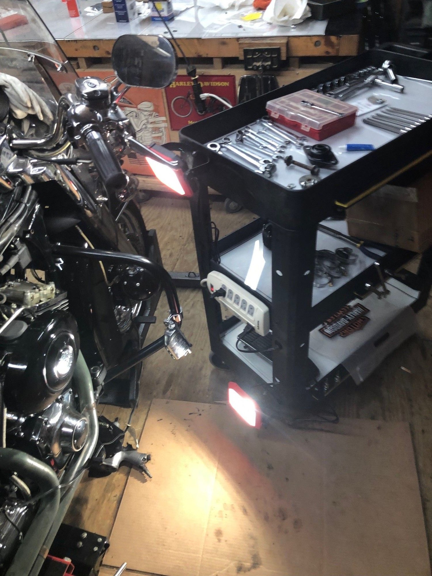

Both of my Indy friends ( successful shops) expressed skepticism, but I had the tank off for new throttle cables and @ $15 I gave it a try

And sometimes they do. In my case they did not.
...................I like that cart .

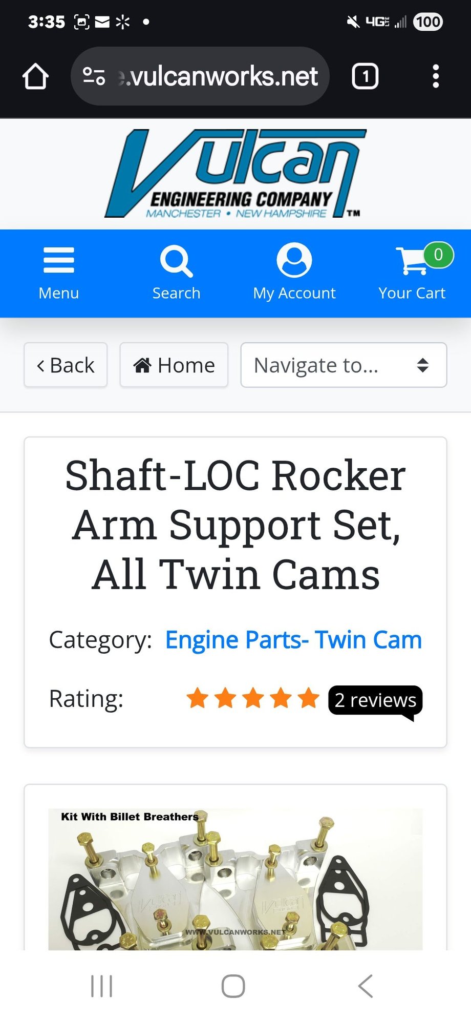

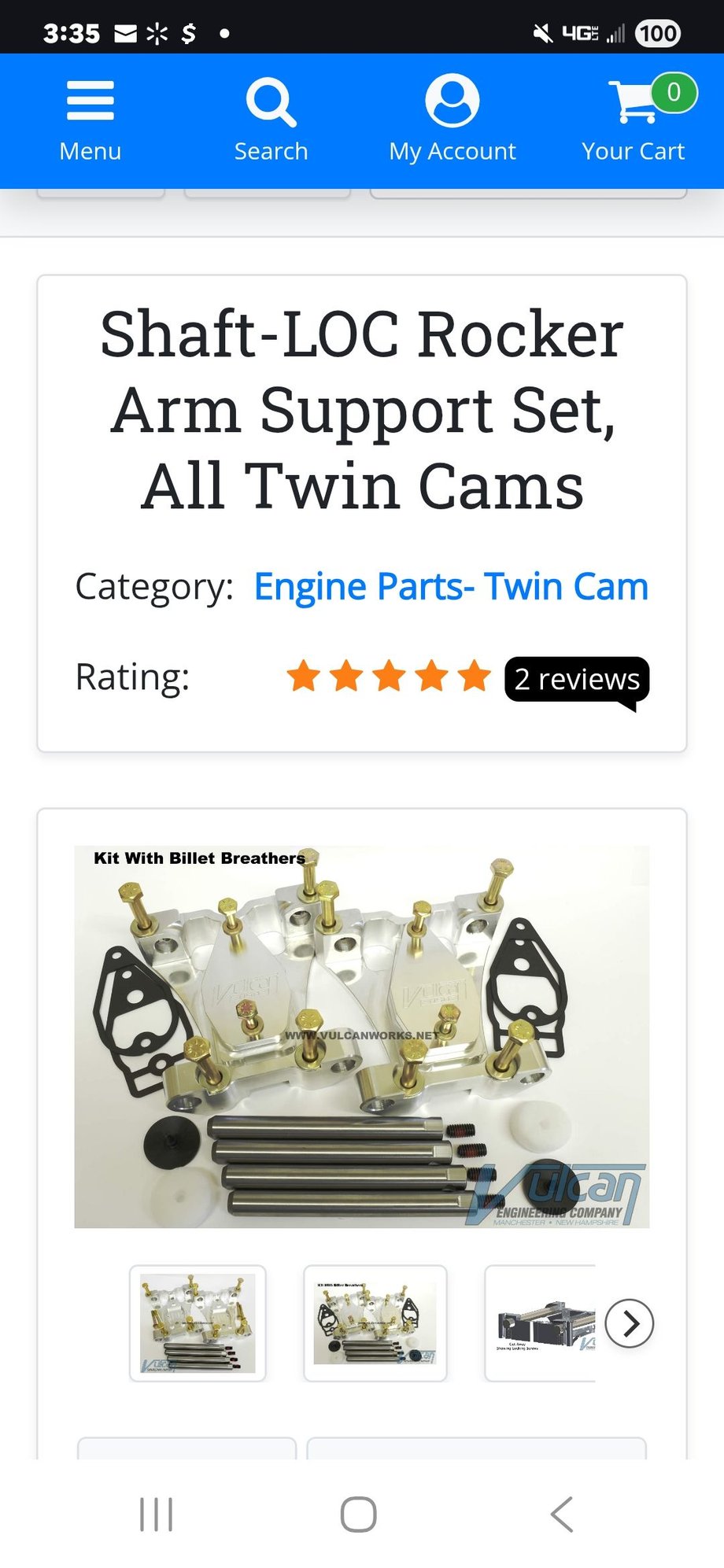

You could try these instead of the rocker lockers
