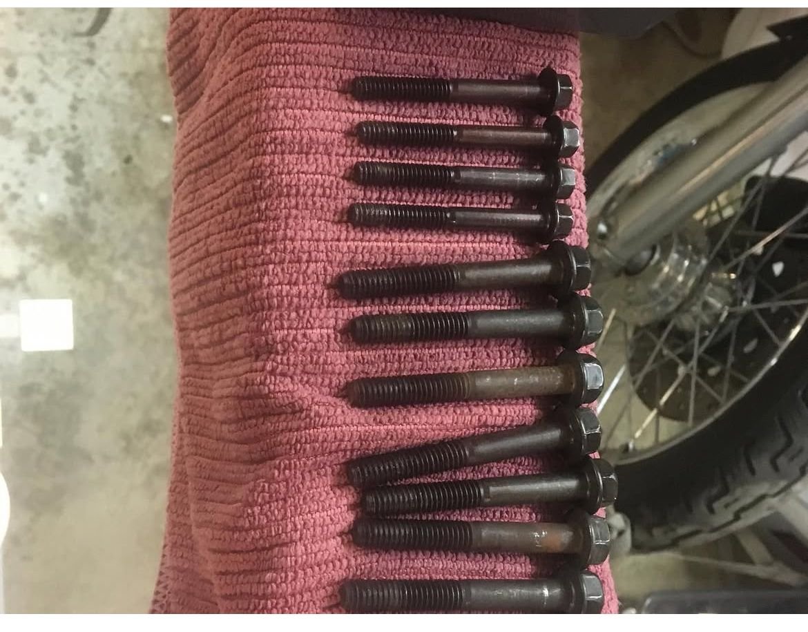

Hello, Dyna 2006, 98 ci, Andrews 26 here.
Since several years I have had a clattering noise coming from the left side at load. I have been thinking primary, but now I believe it is valve train noise.
When doing the big bore two years ago I discovered witness marks on the rocker assembley bolts, took some shots of them, then forgot about it.
Anyway, now l am pretty sure it is the rocker arms making this disturbing noise, (rotating back and forth against the bolts), and I will install rocker arm lockers this winter.
My question is: Can this gap affect performance and cause other troubles?
Thanks in advance.
Best Regards
Oak Mountain Rider
P. S. Don’t think it is pinging - no knockcounts and this happens all the time at all engine temperatures. And don’t think it is from the primary - 0.0028” runout measured on the compensator bolt, new SE Compensator and new primary chain tensioner (upgraded C-version).
No.

no performance issues would come from it. Get a cheap stethoscope and find exactly where the noise is coming from. Could be the rockers, could be the rods touching the tubes, could be a few things. Sounds tend to bounce around
