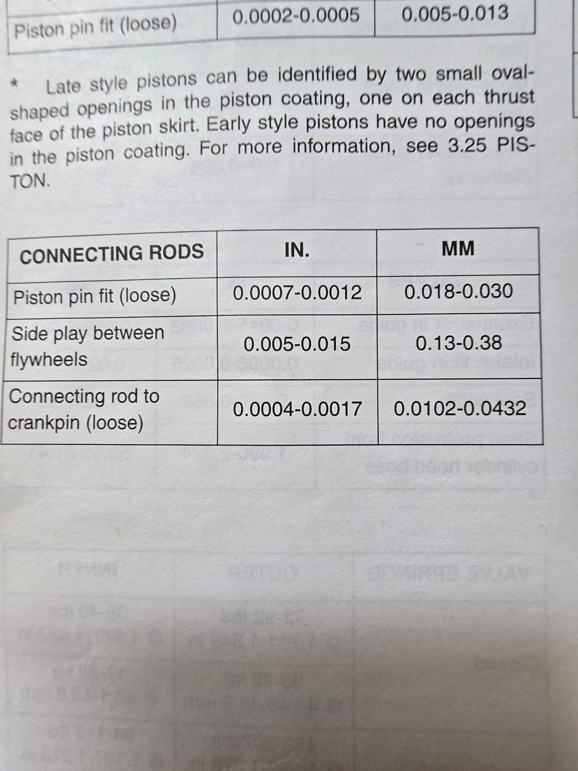

The side play is 0.005-0.015.
The rod to crank pin is 0.0004-0.0017. You not going to be able to fill that. One may be able to see it with a dial indicator but just a small amount not coming straight at the indicator reading off the end is going to move the needle.

at one time hd used to have a side shake procedure in the FSM. that is gone so the only measurement is the big end clearance between rod and flywheel. the FSM says no up/down movement that is detectable unless of course you have instruments capable of the ten thousandths range.

Crow, not sure what Max is refering to with the 3/32
Maybe an angular side to side movements of the rod end of 3/32".
I would not be concerned with that if that's what you are refering to in your first post.
My info didn't come from AI.
It came out of a OEM Service manual.

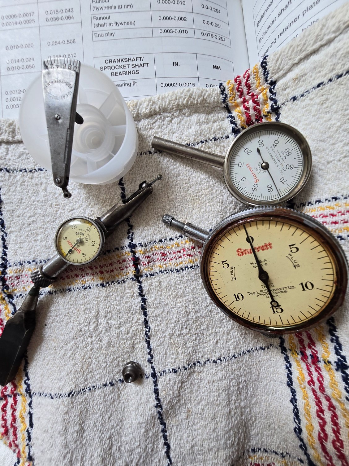

My old indicators that still serve what I need. That one in top left was my Grandfather's. It's retired.
