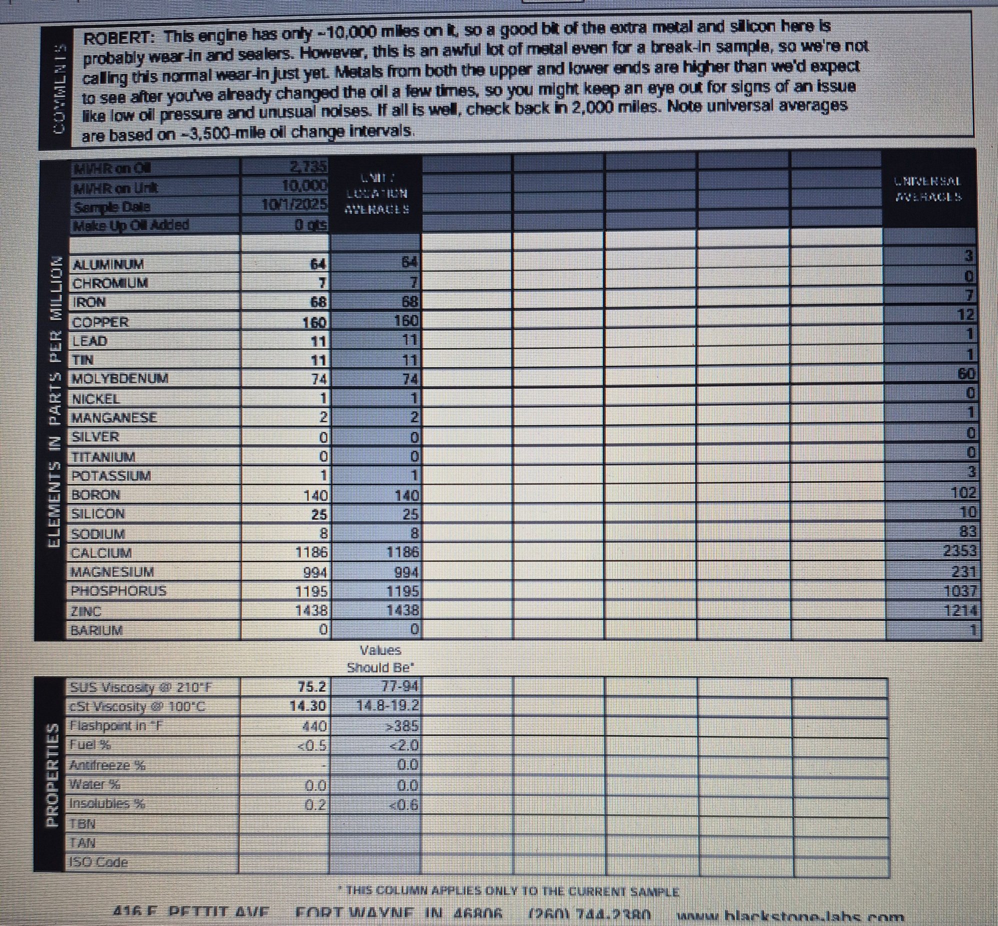

I received my oil analysis and I guess it doesn't look too good.. However, I have no issues to date.. No unusual noises etc.. No loss of compression, bike is running very well..

I can't make out the column headings but under properties it seems to suggest more than expected fuel is in the oil with the oil down on its viscosity. Slightly diluted oil. Does that indicate some wear in the bores or rings?
