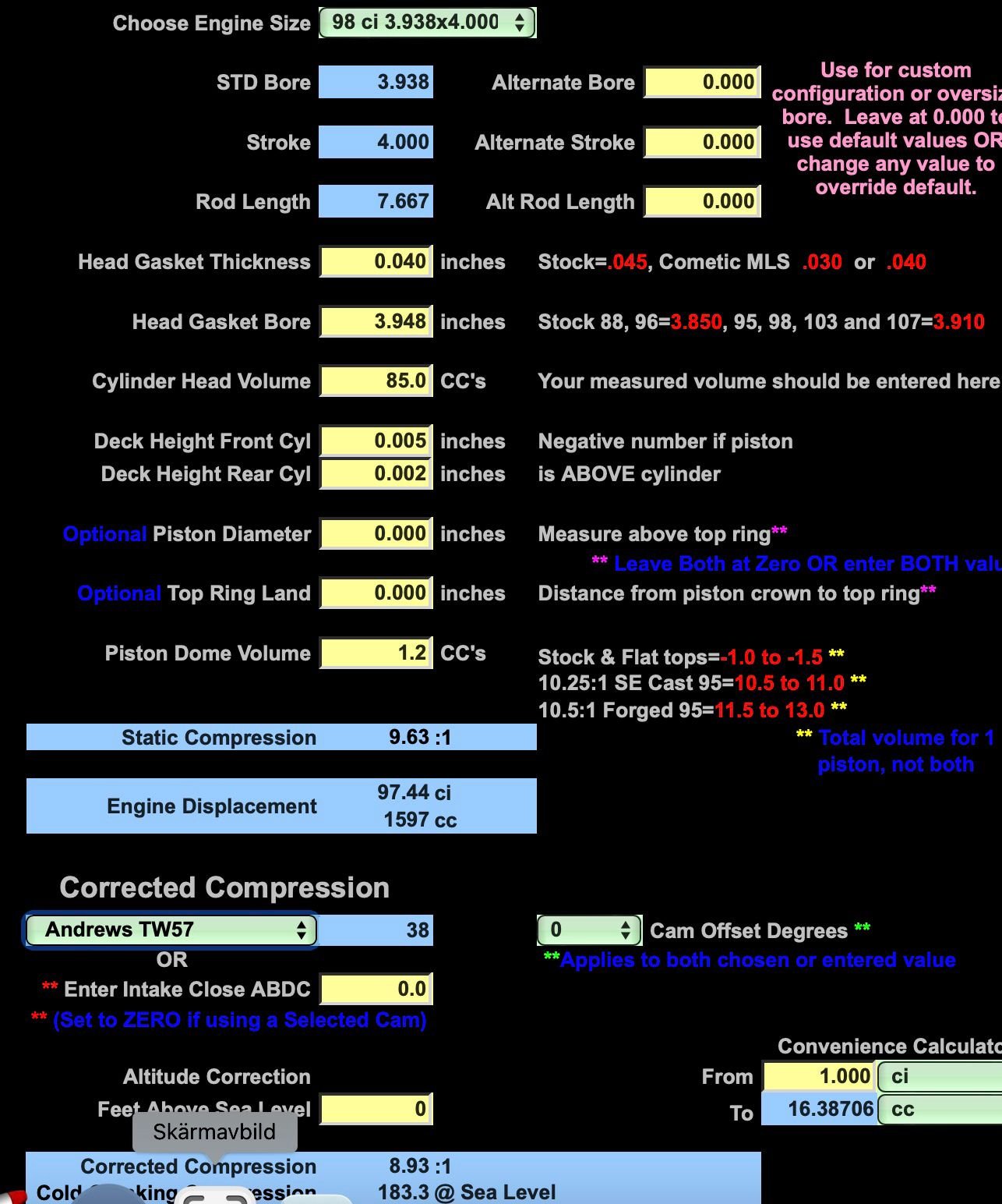

Below are the calculations for Andrews 26 (186.1 PSI) and Andrews 57 (183.3 PSI).
Andrews 26 MLS 0.040"
Andrews 57 MLS 0.040"
If I use a 0.030" MLS instead, Big Boyz calculates the compression to 188.0.
Maybe I will go with the MLS 0.030".

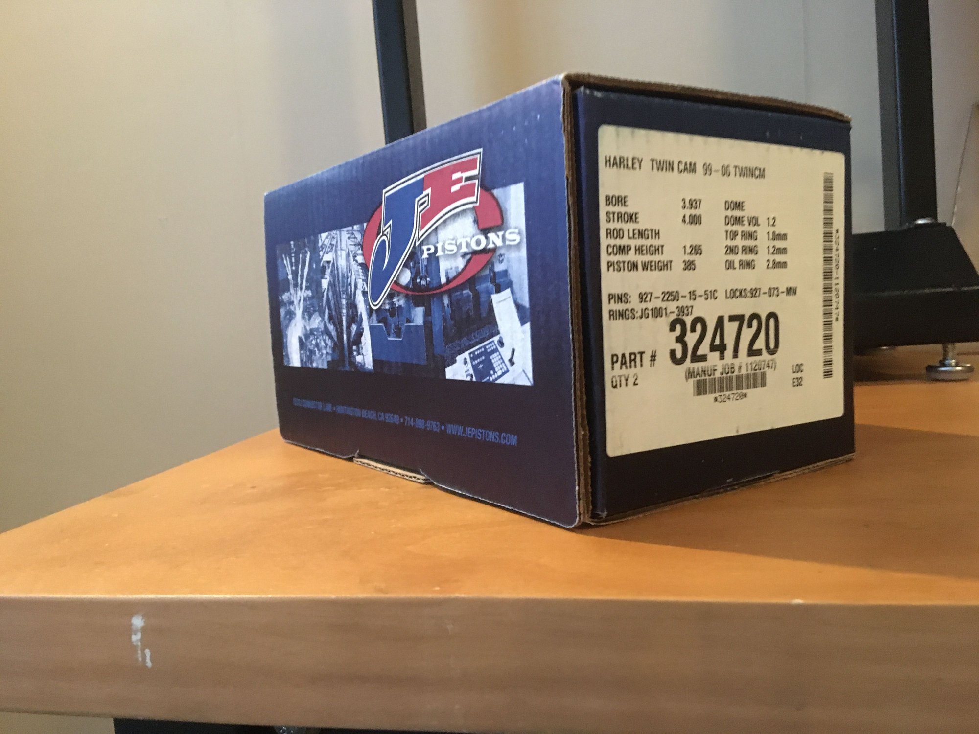

Couple of things to consider. How sure are you the chamber volume is 85cc? Have you meausred? 86cc is not uncommon in the improved '06 heads. What pistons give you the 1.2cc dome: just curious. For sure run the .030" head gasket but give some thought to shaving .030" off your heads;

Sorry, forgot to answer about the pistons.The pistons are JE. The heads were shaved 0.2-0.3 mm (0.001”) three years ago. Thanks for you input.

Thanks for the answer. These pistons are already installed since three years and I will not replace them. It was an old picture of the box, just to show what pistons I have. Thanks for the tip, anyway.

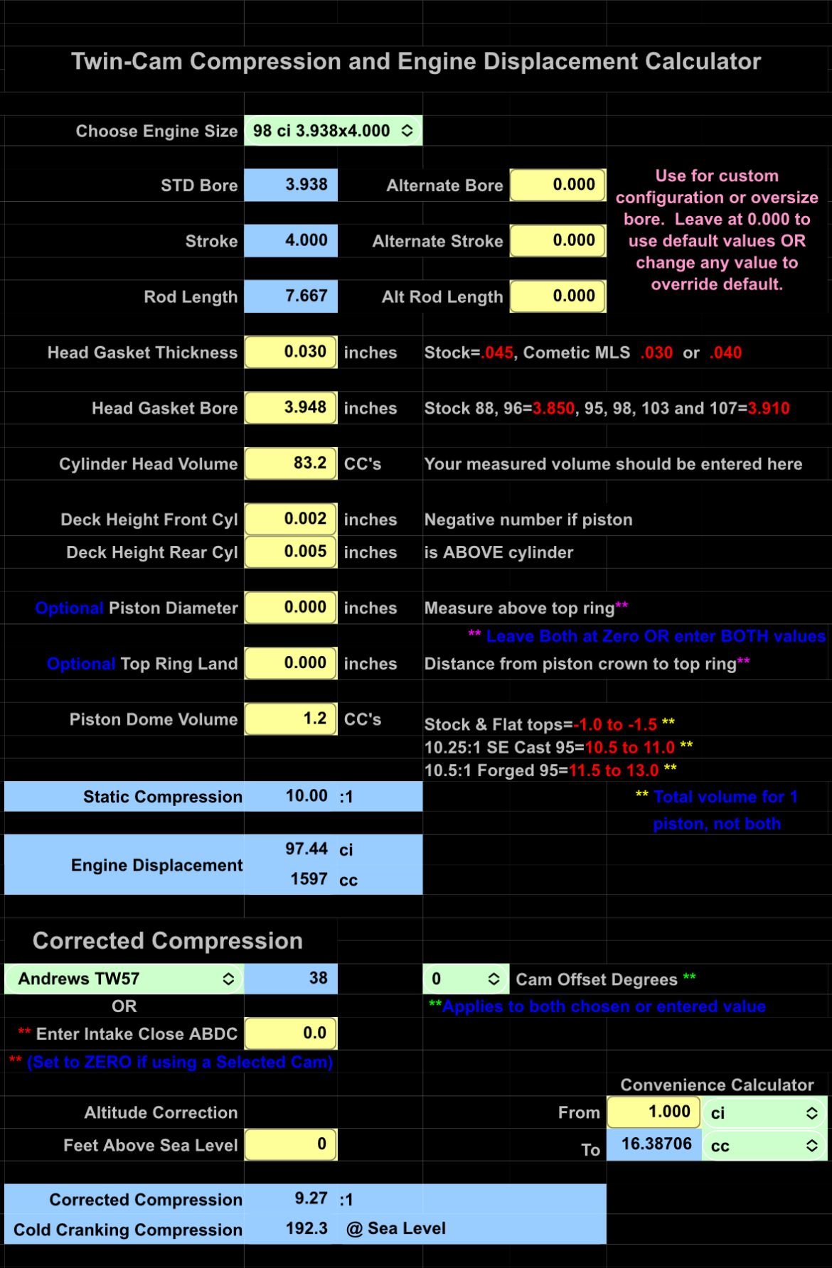

What I can do, as far as I can see, is to go for the 0.030” MLS and maybe I can see if someone can shave a little on the heads. (But I will make the clay test first to see if I can do that.) Anyway, asking Chat TGP what a 0.01 shave will do to 85 CC, it says 83.2 CC.
And when I put this in the Big Boyz it actually says 10.0:1 static, which will result in 192.3 psi with the 57 cam.

To get to 10:1 compression you will need to remove .020" off the cylinder head.. By what i was told .006" = 1cc but the graduation changes because of the taper in the combustion chamber..
Edited.. technically you should be able to go 30,000 without a problem and still have plenty of valve to piston clearance.. which will yield 10.2:1.. The sweet spot for that cam..
