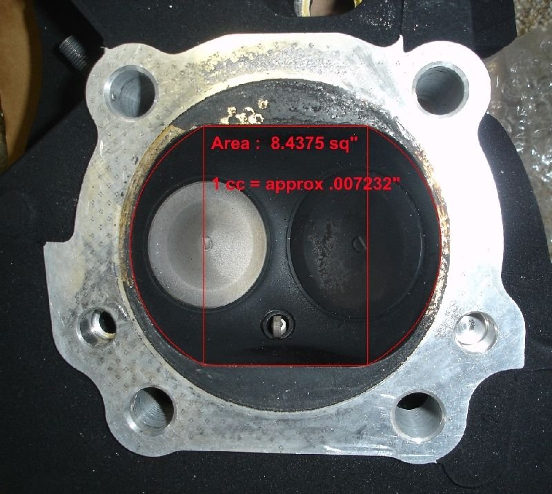

No worries about valve to piston clearance until you start cutting 050"-.060". Not suggesting no clay but you will see plenty of V to P clearance.

Thanks a lot djl. Then I will use 0.007" per CC. And I will remeasure the CC:s. Just not sure now if I measured before or after the milling, three years ago. But from the figures at hand, it seems like 0.02" or 0.03" milling will do the thing

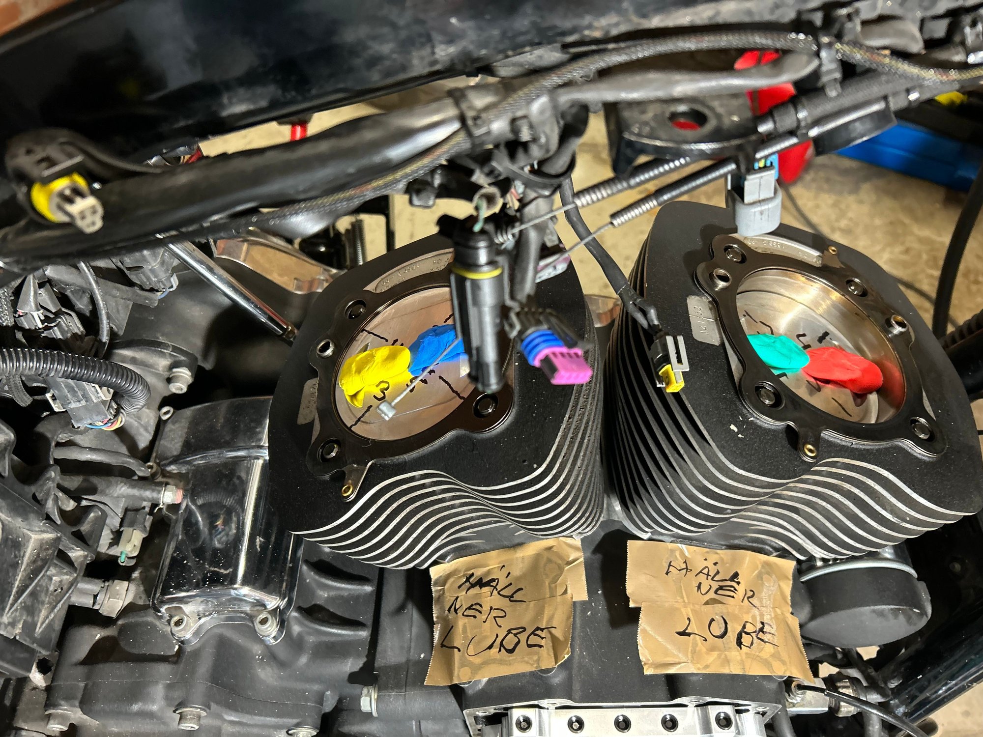

Default Something is wrong.
I need help from you guys. I am doing the clay test and have installed the adjustable pushrods on the rear. Now I want to turn the wheel so I get TDCC on the front. But there is too much resistance. I can get the rear wheel round. Heard a sound from the springs. Dont dare to pull the rear wheel hard. Pics below:

You really need solid lifters to do the valve to piston clearance check.. Did you wait for the lifters to bleed down (you should be able to spin the pushrods by hand which will prove that the lifters had bleed down before going on to the rear..) before you spun the motor over??
Not only that, this is a bolt in cam why are you so concerned about valve to piston????
Old Feb 4, 2026 | 03:12 PM
OakMountainRider's Avatar
OakMountainRider
Joined: Aug 2018
Posts: 589
Likes: 93
From: Stockholm
Hello, they are solid and don’t bleed down, or? Anyway now I got it round to TDCC on the front. Thanks for helping me.
