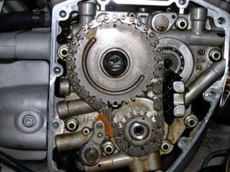

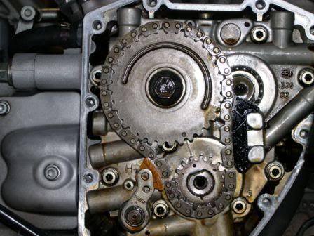

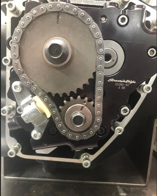

That last pic isn't tdc front, close tho

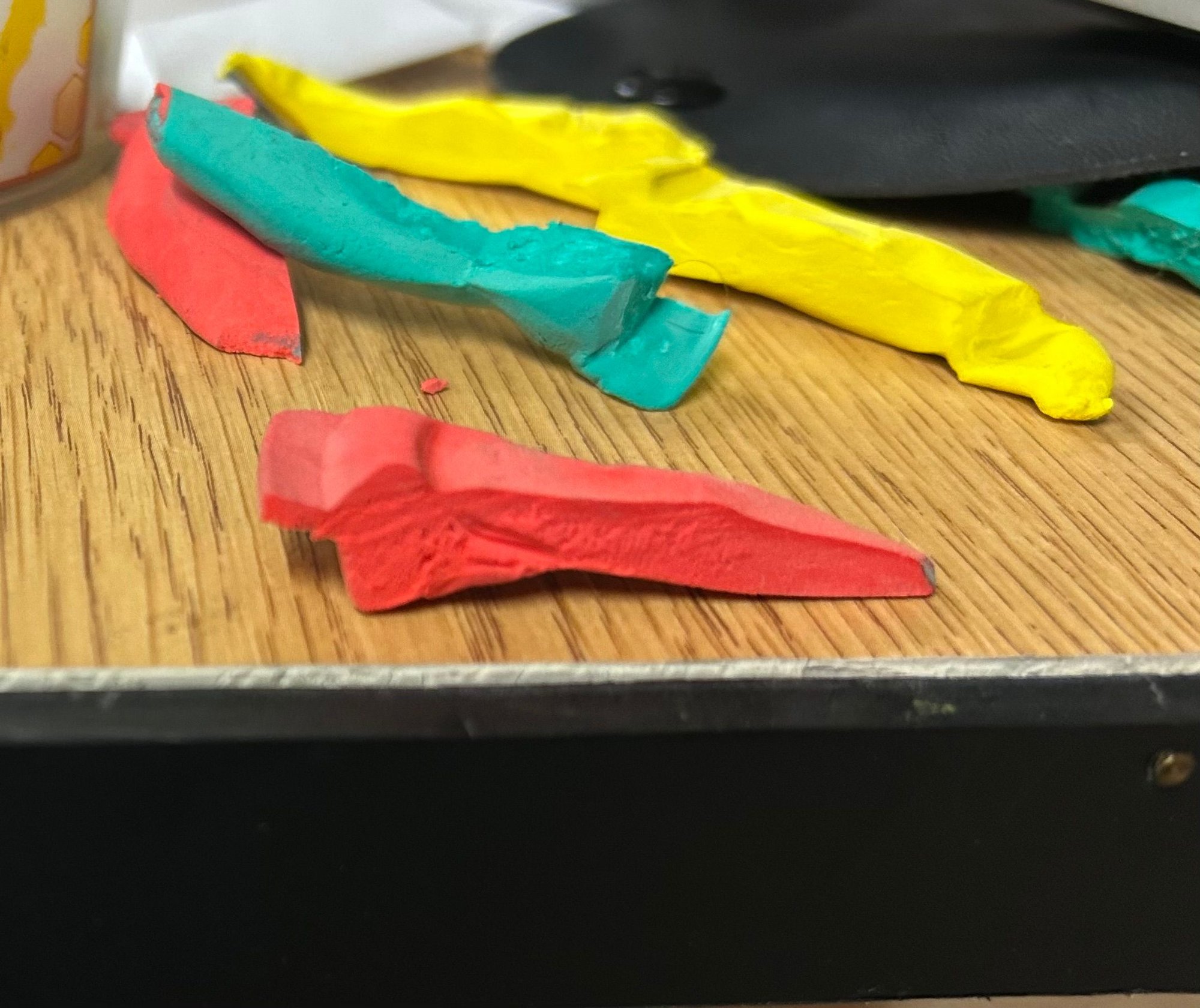

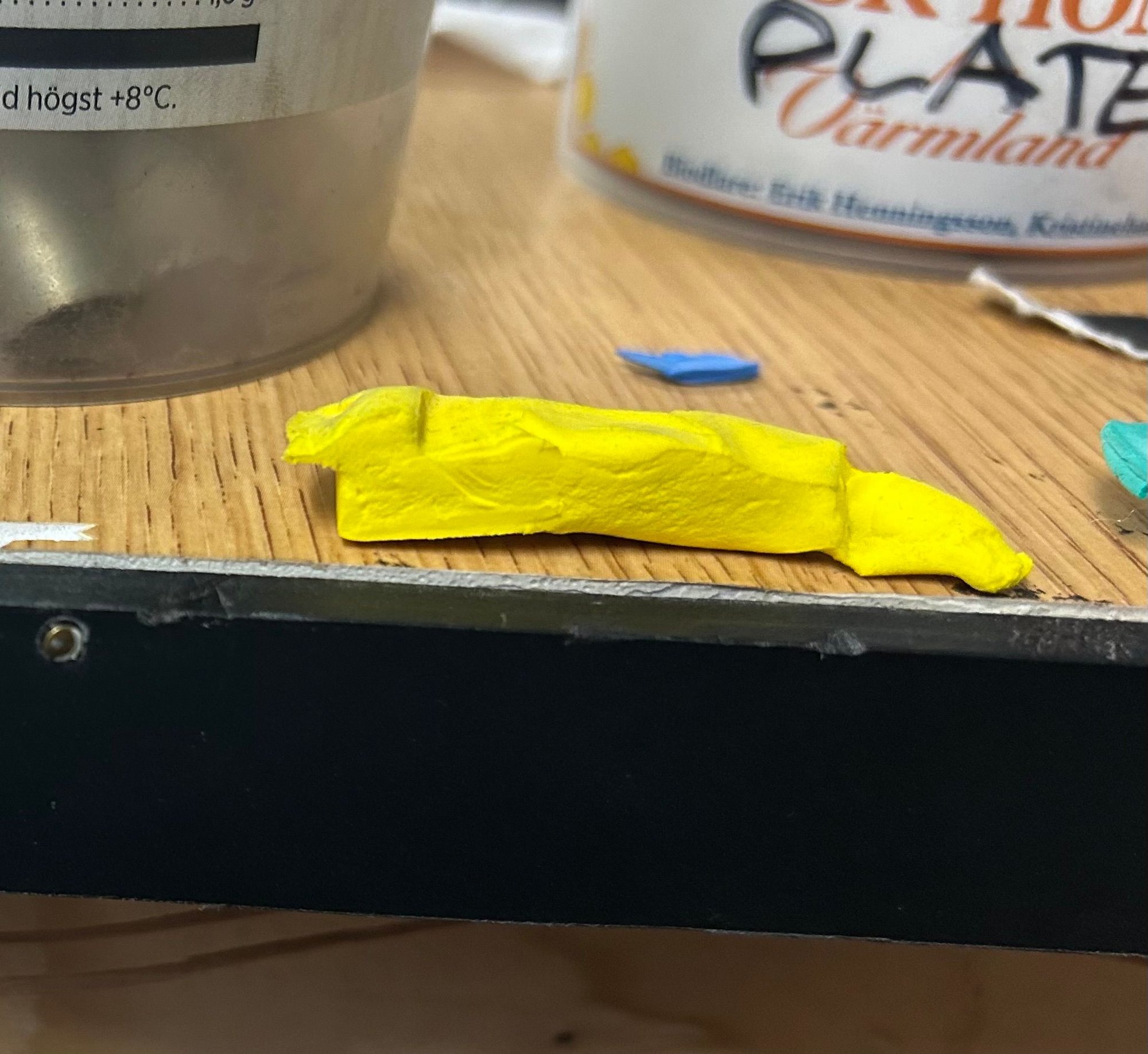

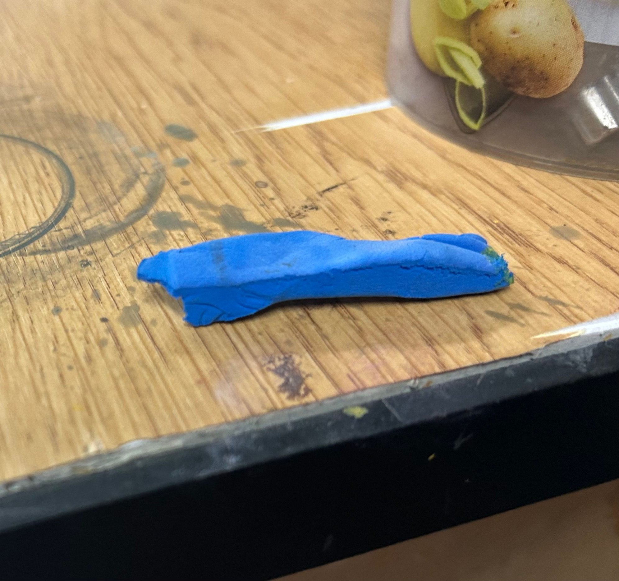

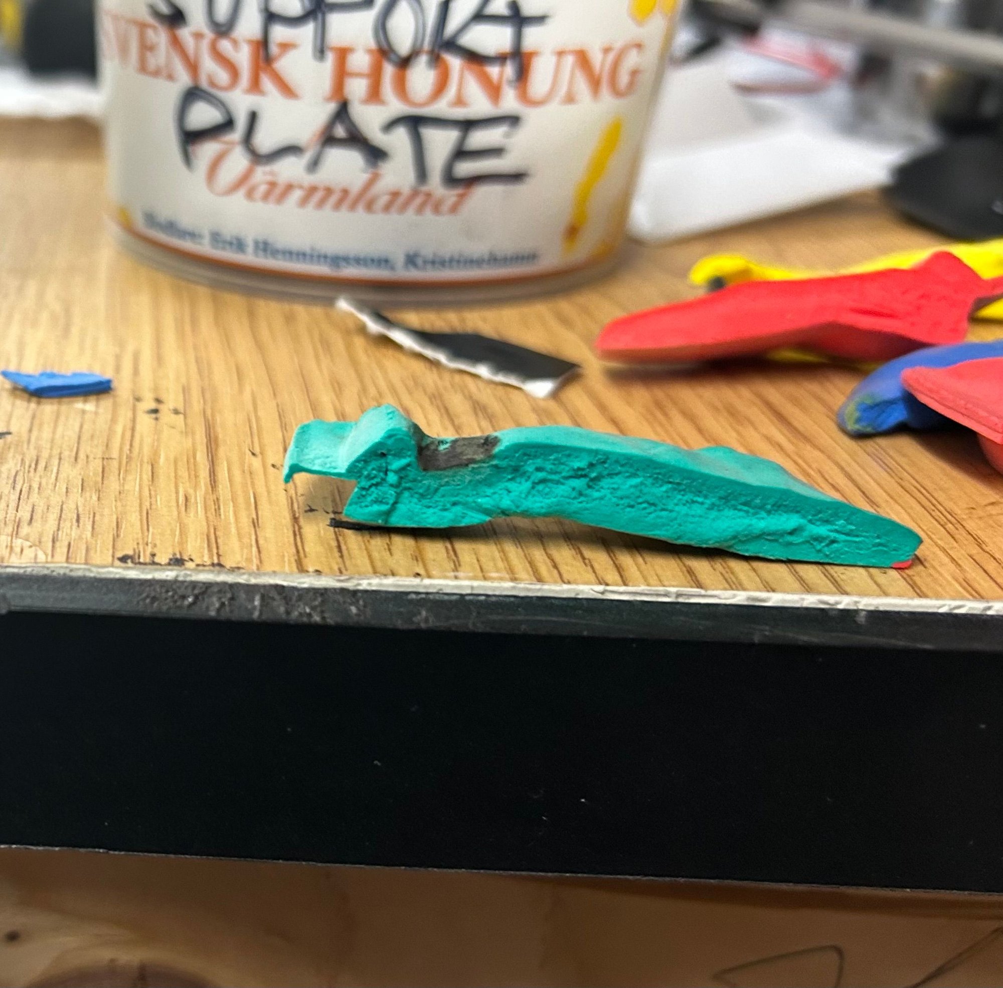

Default Huge valve pockets!
Thanks to JE Piston’s huge valve pockets, I don’t have worry about any clearance issues.
Yellow, 0.240”, radial 0.200”, (rear exhaust)
Blue 0.250”, radialt 0.200”, (rear intake)
Green 0.230”, radial 0.210”, (front intake)
Red 0.280”, radial 0.220”, (front exhaust)
Not sure what you mean by that. The marks were made for pointing out the TDCC:s.

I don't think Lonewolf was referring to your last pic in post #36 with the sharpie marks. I believe he was referring to the "last pic" which would be the pic in your post #30 wherein you said "I got it round to TDCC on the front" which is not TDC on the front.

Some misunderstanding here. What I meant was that I turned the engine to the TDCC for the front cylinder so I could install the pushrods there. I thought I just send this to sort it out:
And then Loneley Wolf sent a pic where the marks show 10 degrees more than TDCC. So I wonder what he meant. I thought maybe he meant TDC overlap and that the valves open max at 10 degrees after TDC overlap, which I read somewhere they do…or else the pics don’t show up at the right place in your browsers.
By the way, did you see the clearances? As you and everybody said, there is plenty of clearance. I can sleep well

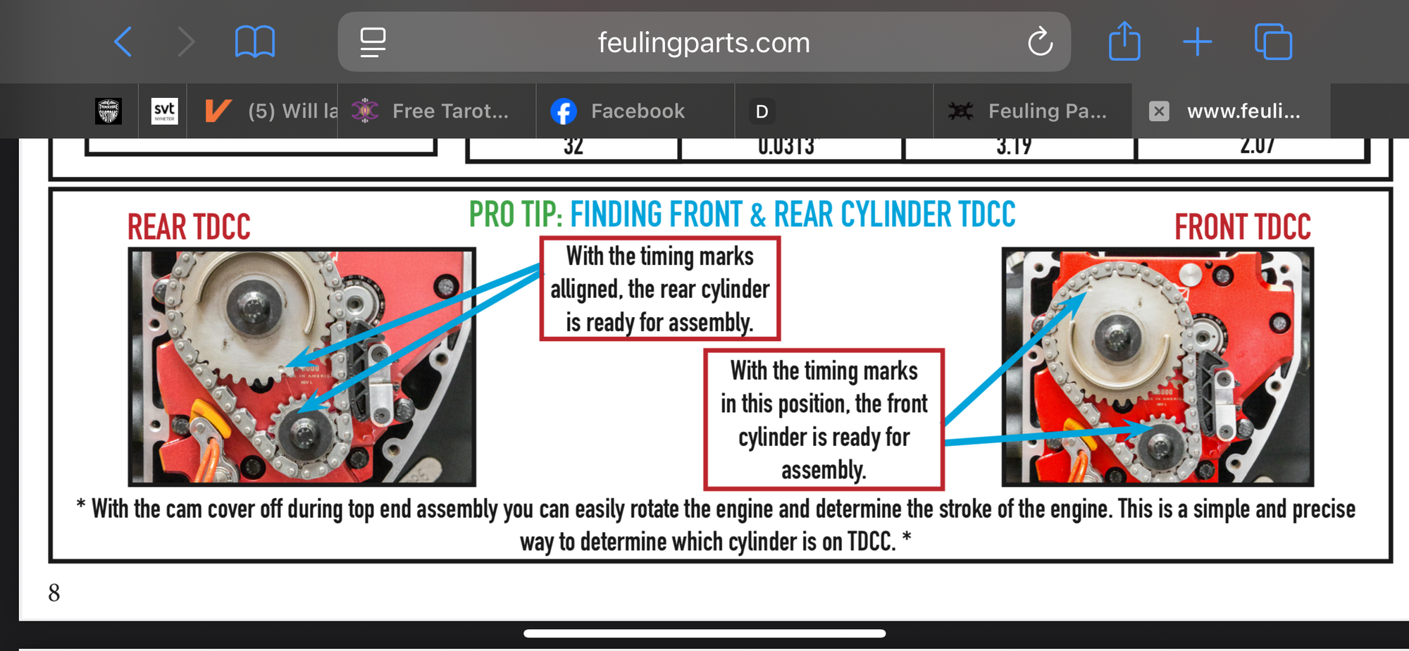

The picture on the right in the above post may have "the front cylinder ready for assembly but it is not TDC front. The picture you posted with the sharpie marks is TDC front; see the difference in that picture and the picture you posted in #30. Not a show stopper but to be "technically" correct, Lonewolf was just pointing out the difference.

Ok, I followed Fueling here. Seems to be a source of confusion. I will check this out when I am with my bike. I will see it easy now when the heads are off again. Hope I did not bend a pushrod because of this.
