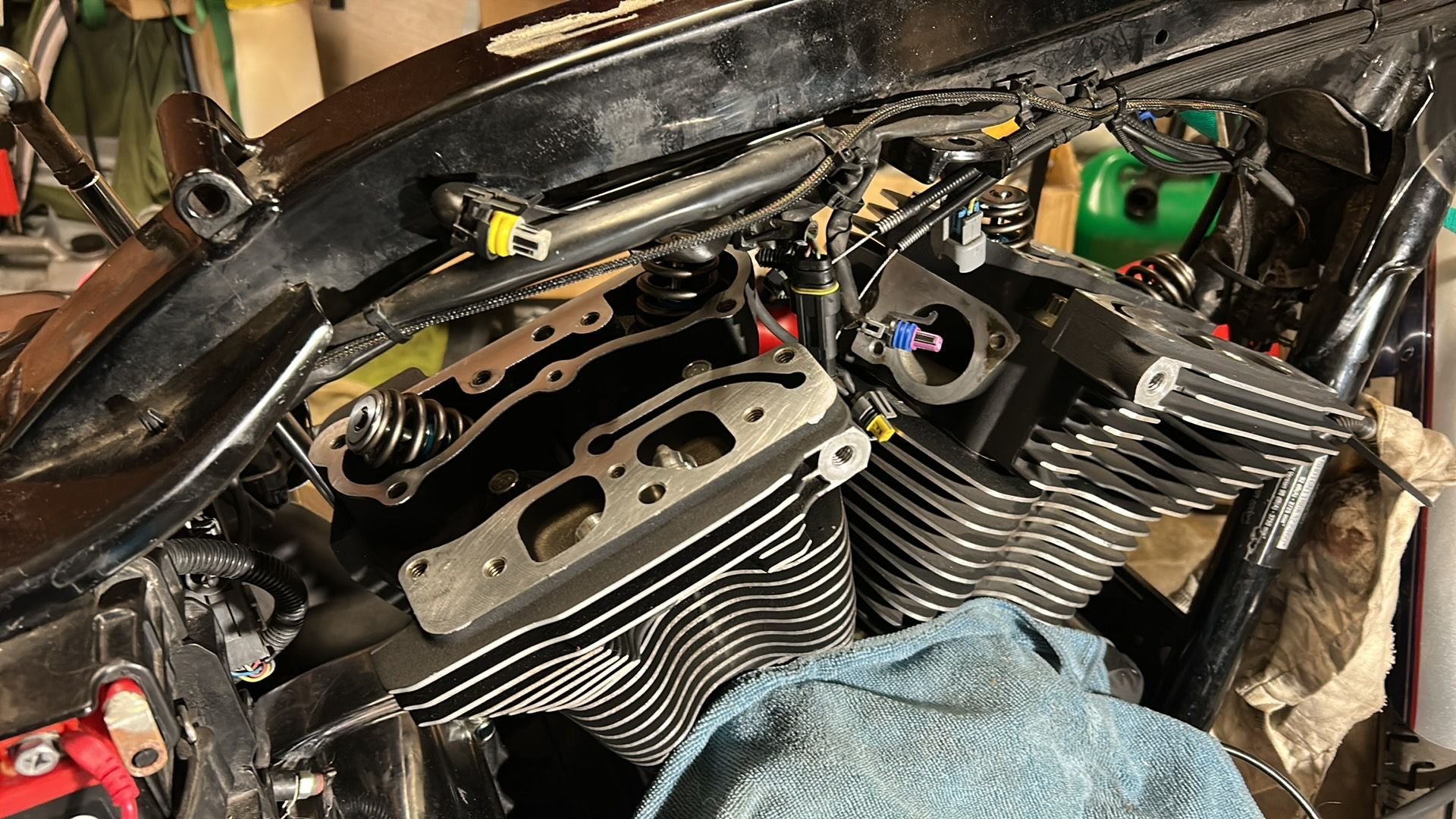

The Cometic MLS 0.030” head gaskets are installed. I also did a leakdown test which said 8 % on both cylinders. This feels okay.
How can you do a proper leak down test without breaking in the rings..???
The rings are already broken in. The big bore was done three years and 10.000 miles ago.
This winter I cleaned out carbon, changed the cam, checked valve to valve clearance, valve to piston clearance and replaced the head gaskets. Apart from what is mentioned above, I also replaced the valve springs, the valve seals and the exhaust valves.
You are right there otherwise. At breaking in I had a terrible blow-by, I recall. I didn’t do any leak down then, but upon opening the oil hole at idle, it was blowing like a steam engine. Also it was leaking oil from joints in the engine.
