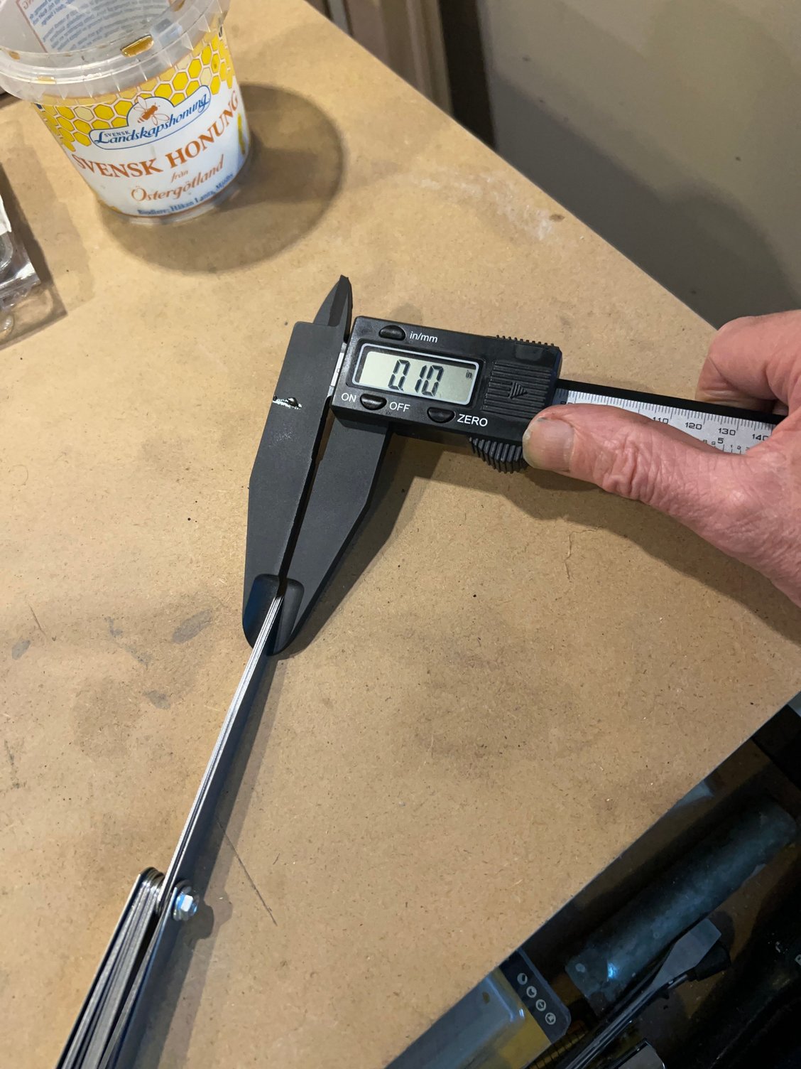

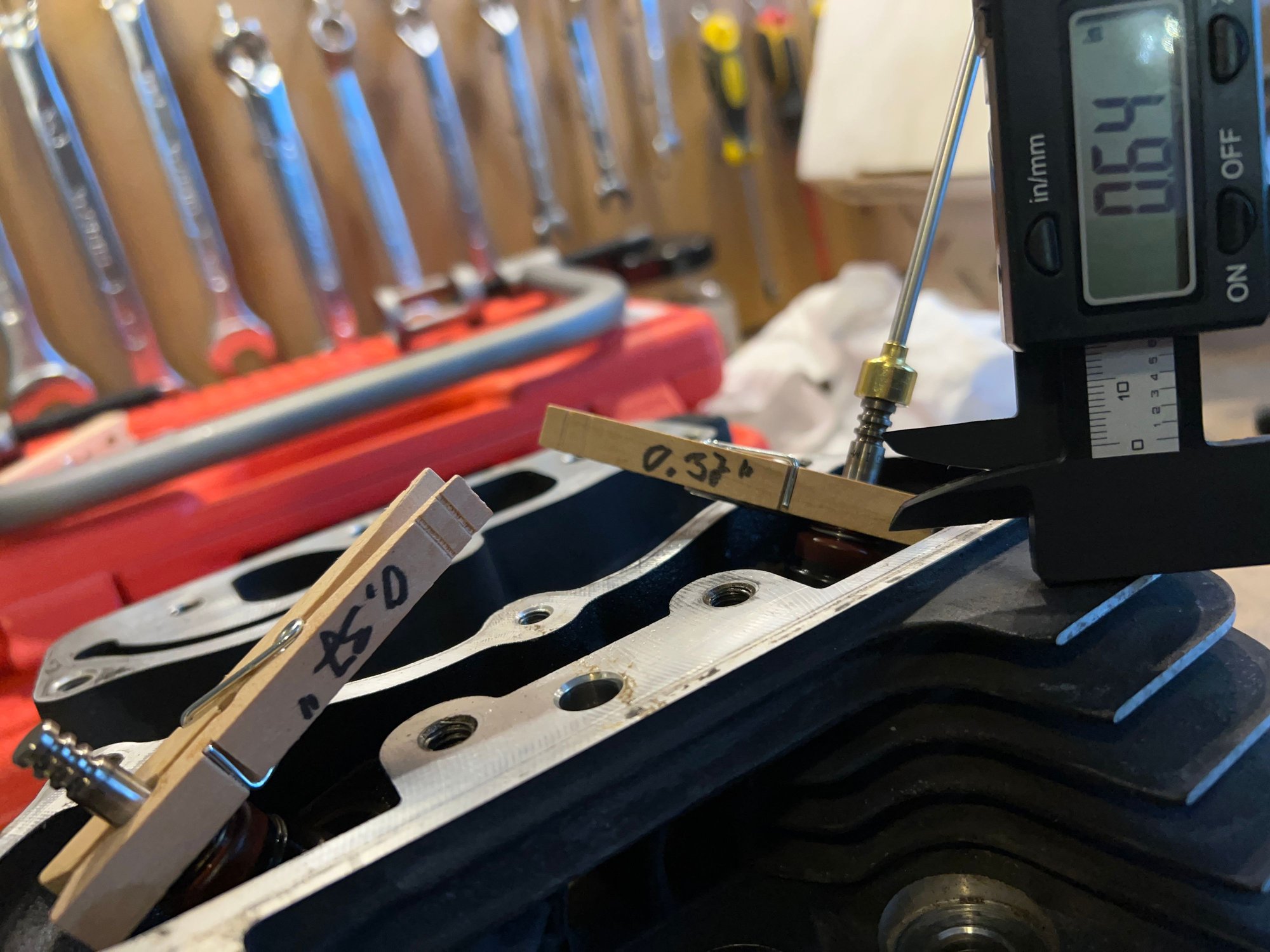

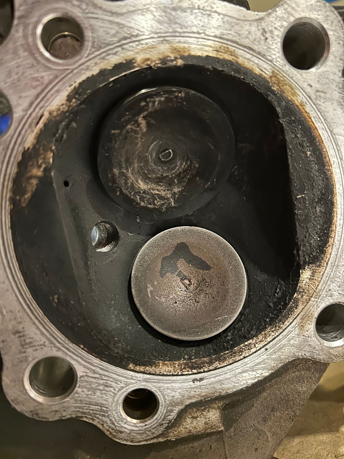

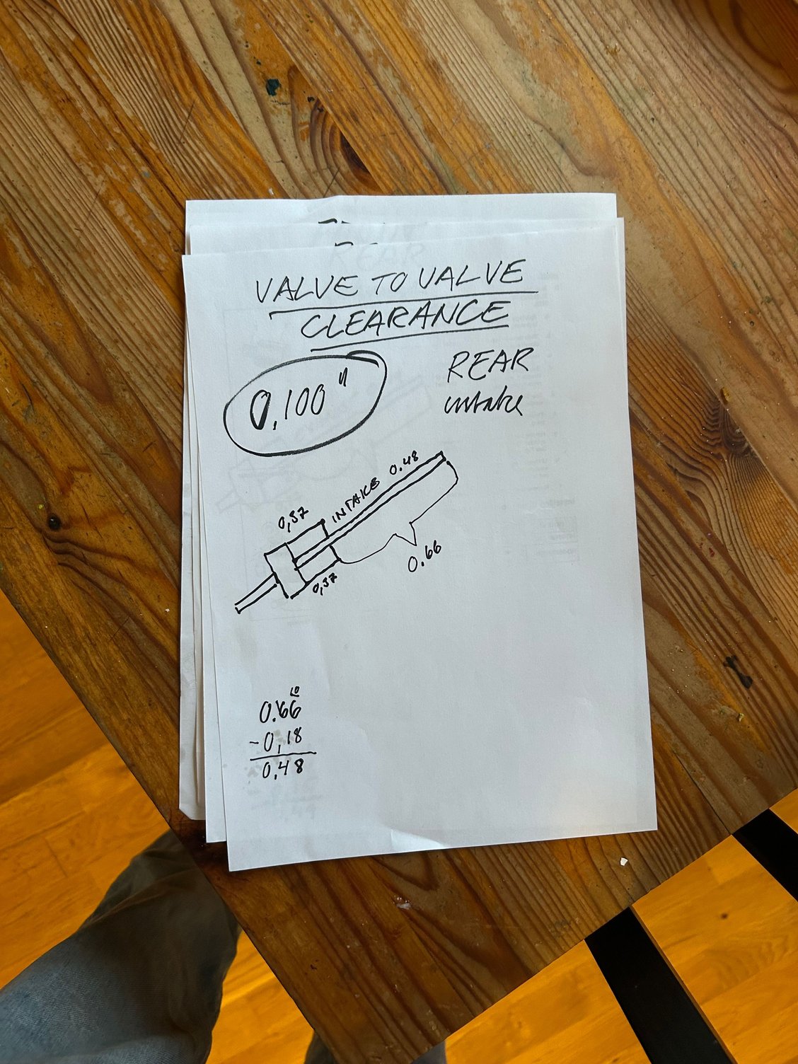

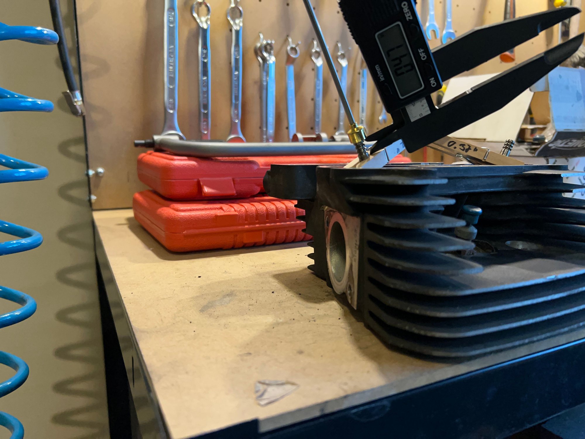

Checking Valve To Valve Clearance
As I do not possess the Trock Tool, I did this:
1/ Having the valves closed and locked by clothespins, I measured the distances from them to the top of the valve stems
2/ These distances were subtracted by the TDC lifts for the intake and exhaust valves, in order to push them down to the correct lift
3/ The valves were pushed down to the right distances
3/ The clearance between the valves were first measured by a feeler gauge then by a caliper
The results were 0.100” Valve To Valve Clearance on both the rear and front heads.

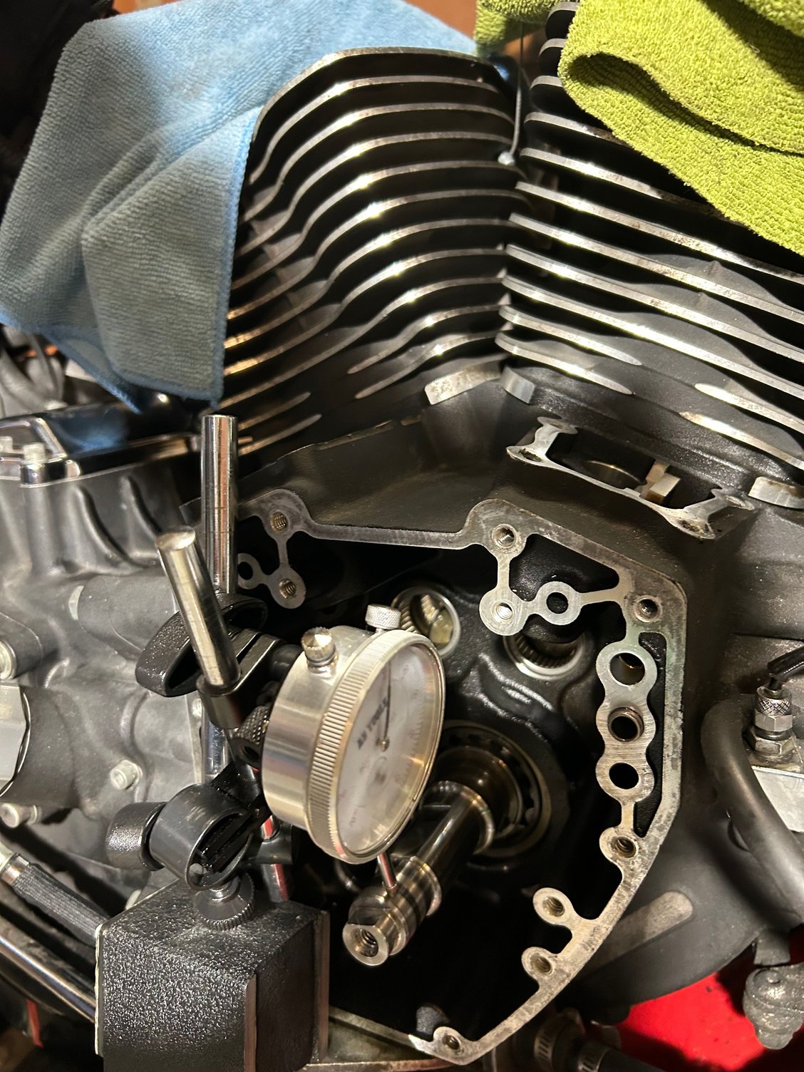

Default Checking crankshaft runout

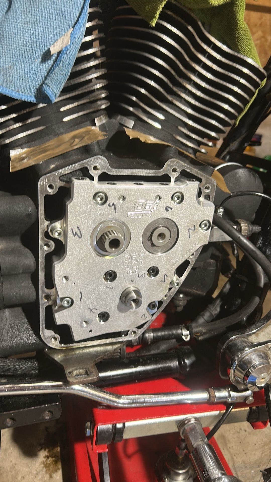

Just the the lifters, camplate, cams and oil pump out.
Just got the lifters, camplate, cams and oil pump out.
Since big bore 10.000 miles and three years ago, running my bike with Andrews 26, (with a cold crank compression of 192/194 psi*), I have had a concern about the crankshaft runout, thus being careful not to lug the engine. Also I pulled timing from the original timing table from Dynojet.
Luckily the runout is okay, measured as below:
0.0019 (measured runout) + 0.0002 (measured gap/end play) = 0.0021” (total runout)
Fueling puts the max total runout for gear cam at 0.003” and the max total runout for chain cam at 0.005”.
*Measured with some carbon build up, should be mentioned

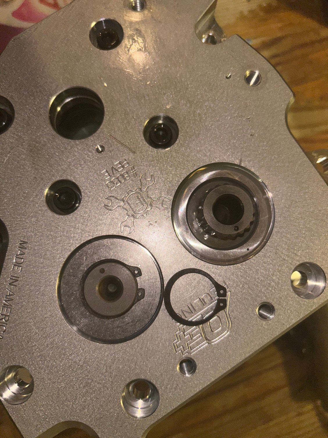

Now Andrews 57 is installed in the Fueling oe+ camplate.
I used two pair of circlip pliers; first the one that opens, then the one that closes, to make the circlip snap into its place.

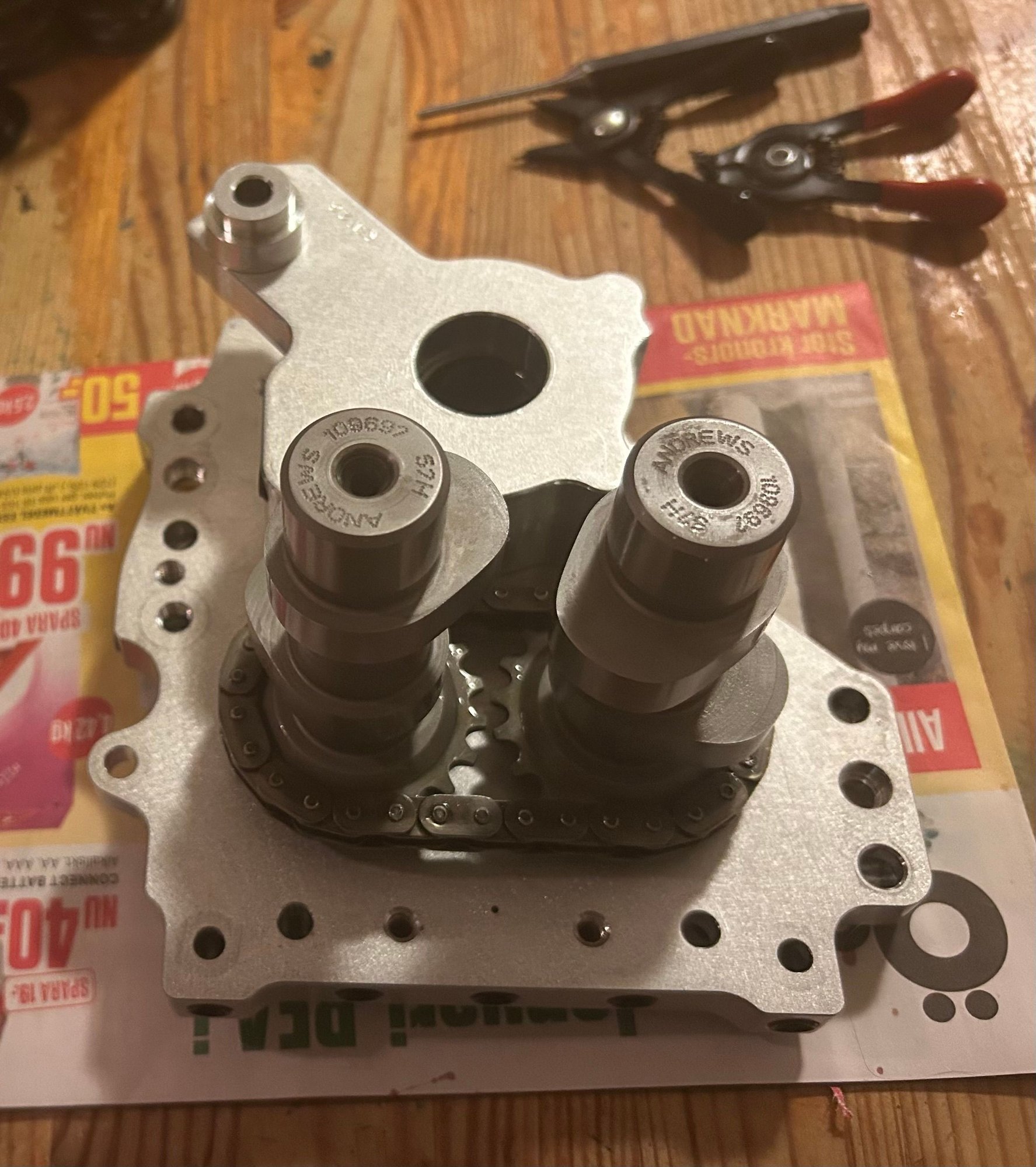

Just got the cam, camplate and the oil pump in place.
