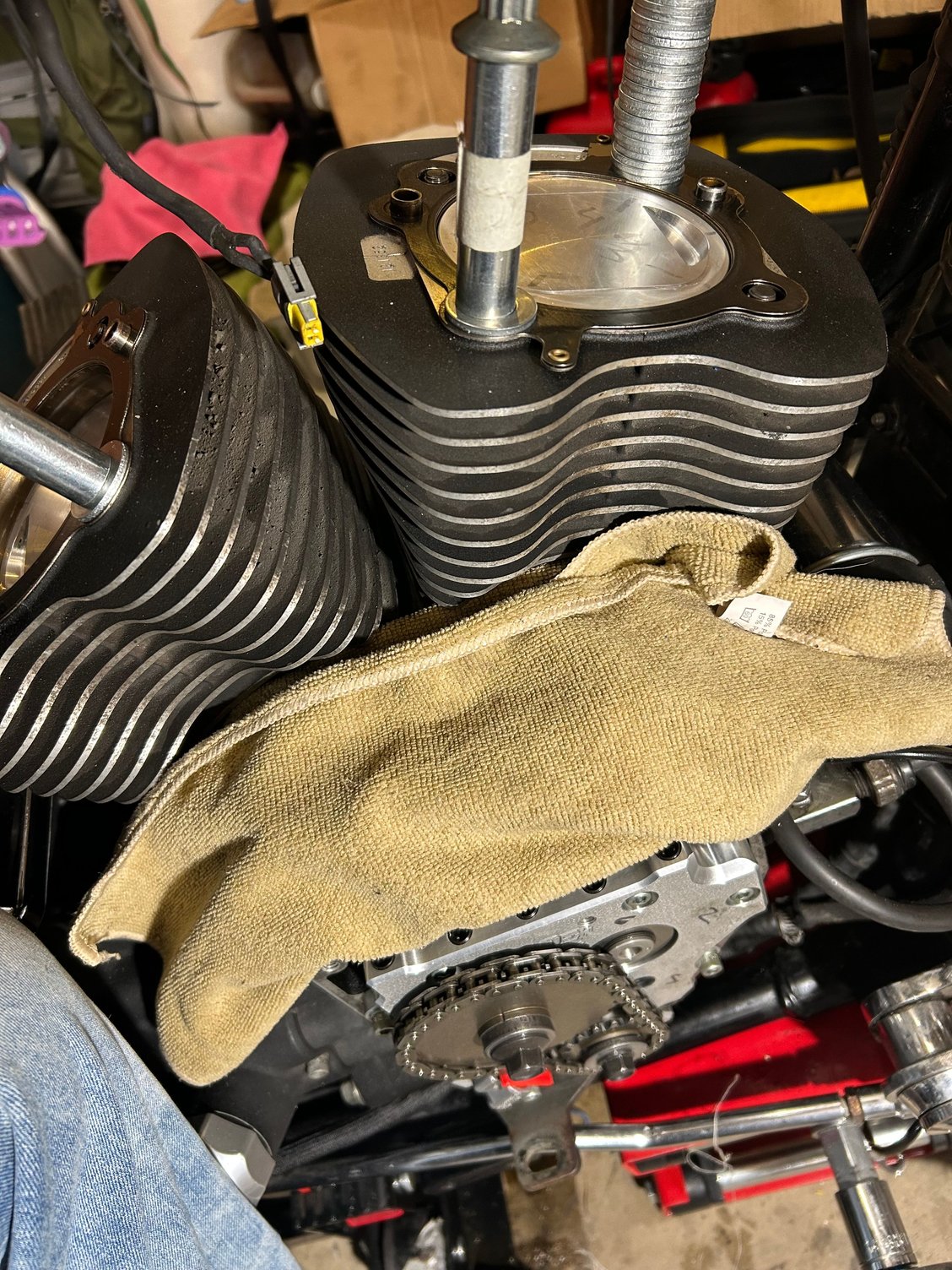

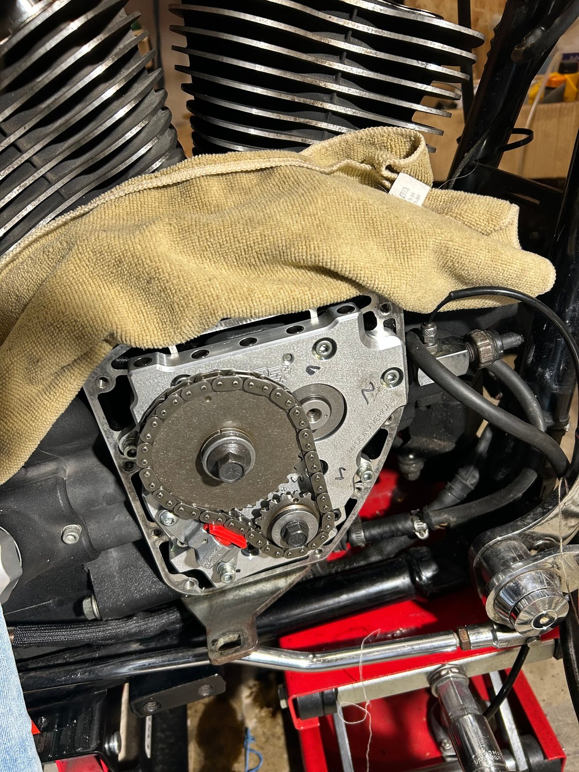

Default Yes, you were perfectly right.
TDCC on the front is one o’clock on the sprockets.

Pumped the S&S lifters with oil, filled the holes with assembley lube, and installed the lifters and the covers. Now just waiting for the Cometic MLS 0.030” from USA.
