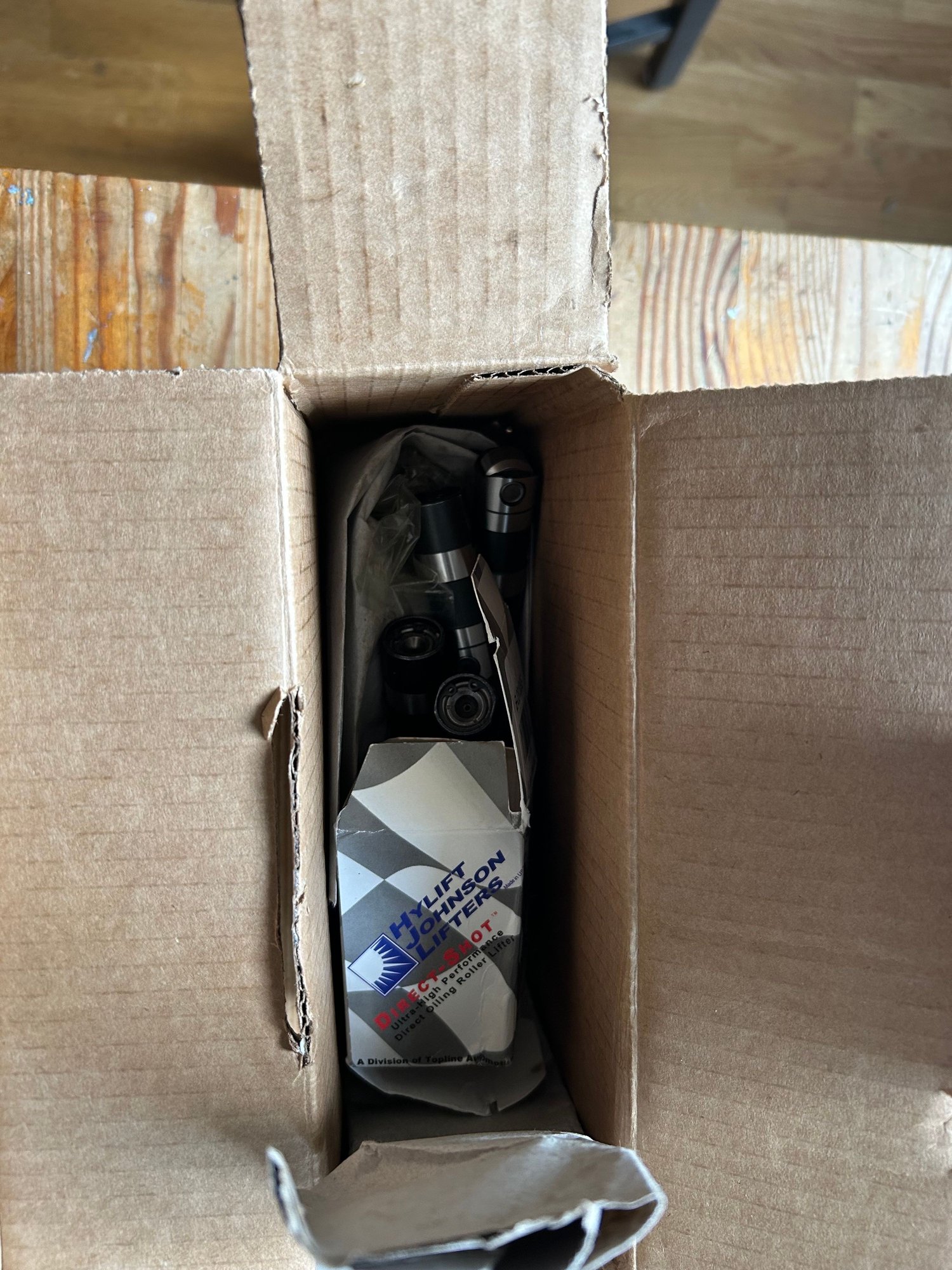

Hello, I did not buy from Larry's, (maybe I should), as I figured he did not ship to Europe and went with Ebay as it works fine with the custom here. (The Ebay-seller I used is rated to 99.6 %.)
To begin with, I contacted the Hylift-Johnson distributor (Topline) to get thorough instructions and a confirmation that they knew the seller. They answered immediately and gave very detailed instructions and excellent support. They also said they sold a lot through the Ebay seller.
Well, so I ordered, and after 3 weeks the package arrived, (after I had paid custom taxes). As soon as I received the package and held it in my hands, I realized something was wrong. I could literally hear the lifters rolling freely inside the package. Upon opening the box it looked like this:
The lifters were out of their package, as well as they were out of their plastic bags.
From the transport, during which the lifters freely had bumped against each other, there were dust on them, as well as visible scratches and dents, but above all; upon pressing the rollers with my thumb and moving them back and forth, there was gritty feeling. When I tested with my old stock Harley lifters from 2006 I felt their roller spin 100 % smooth. Very disappointed I have started a return and refund process on Ebay and will send the lifters back.
Prior to starting the return request, I contacted the seller, who told me to return the lifters and asked to order again.
To me it is not understandable how someone could pack such a vital and important engine part so badly that it gets destroyed.
Now I think I may go with Fueling HP+, maybe not so good lifter as Hylift, but recommended by an indy dealer here in Sweden upon being informed about my set up and my issues.

I wouldn’t be so quick to pass judgement on the seller. That package looks so badly damaged it makes me wonder if it went to the wrong address first and was opened there first before being redirected. Idk
i currently run the feuling lifters without issue.

It could be that someone had opened it, but there are no indications of wrong address in the tracking history.
You are right though, I should not pass any judgements, just conclude facts. But someone has packed the lifters and that person did not know what he or she was doing.
The tracking story is quite complex within the US. The origin is not from the state where the seller is.
There is another thing. The rollers had an axial play, touching the lifter bodies at the sides, thus creating friction. Wether this would have had any effect on the function I do not know, but my Harley lifters are not doing this and I am actually happy now that the lifters were so badly packed, making me observant so I discovered this.
Worth mentioning: There are visible differences between Hylift-Johnson B2313 and 2313 which Larry sells: The oil holes are 90 degrees a part and the B2313 has a larger area for collecting the oil.
These are my observations. I am neither accusing nor judging anyone.
Great that your Fueling lifters work for you. My HP+ arrived yesterday, well packed and with thorough instructions.

Could’ve been opened by customs.

Not likely as there were no signs on the package that it had been opened. And by law the custom are prohibited to open a package without informing the receiver and label the package.
