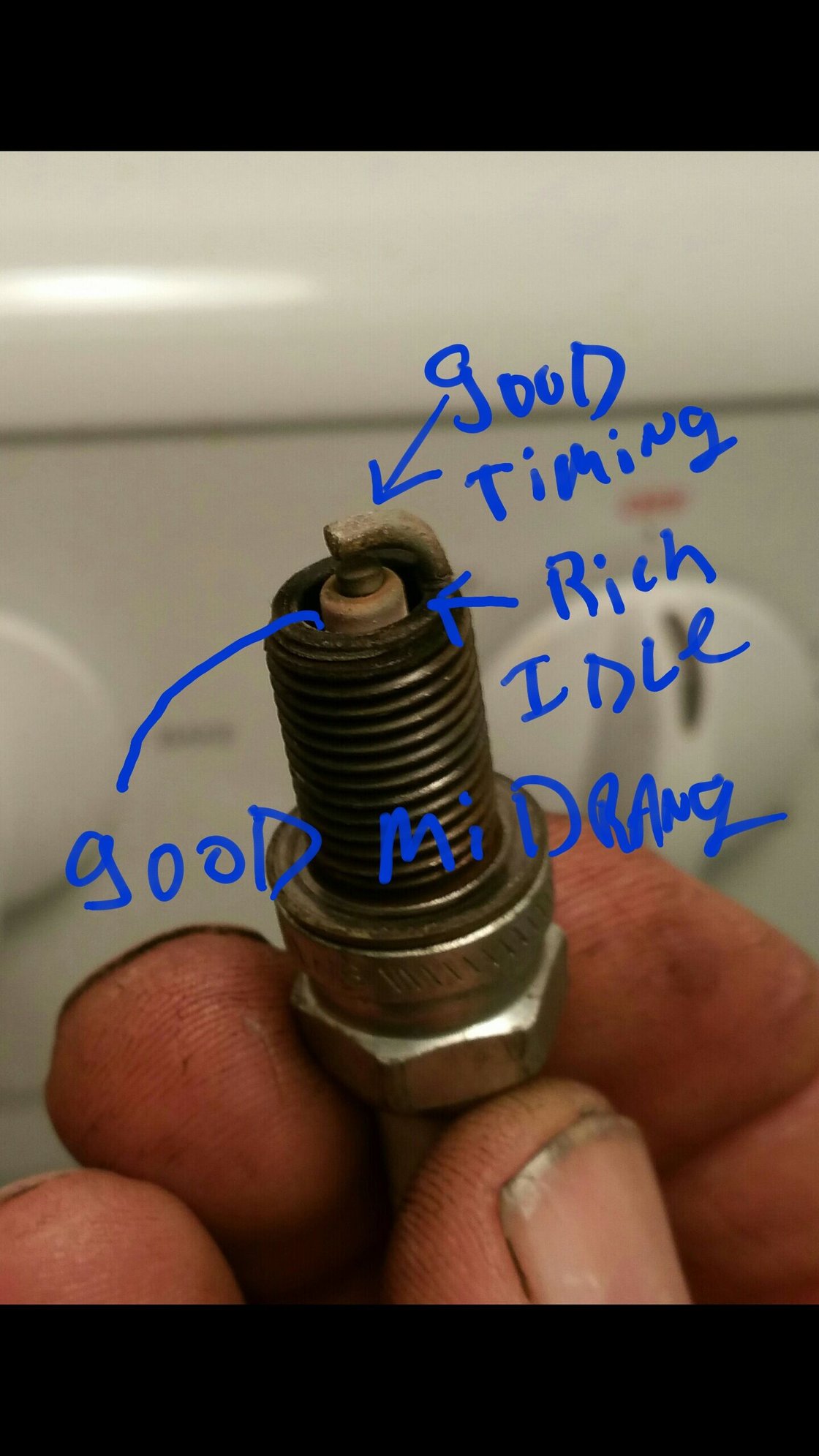

I dont know why people say the stock motorcycle is set from the factory lean the plugs I got out of my streetglide are perfect and the bike had no mods!, the one on the right is lean and has a lot of mods.
and that is why I am here to read the tuning fourm. it is helping.
