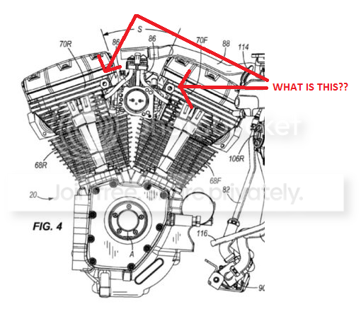

Hi There,
My 06 Night Train is spitting oil from these little ports. Both ports are connected by a stainless steel tube that turns down behind the carby.
Who knows what they are for and why they are spitting oil?
It only spits a small amount if you rev her when she is cold or give it sh*t.
Regards,
Jack

Those are the crankcase breather vents.

Any explanation on why it is spitting oil? It doesn't spit much... Could it just be that there is no filter on the tube?

Crankcase pressure?
Oil being a tick overfull?
