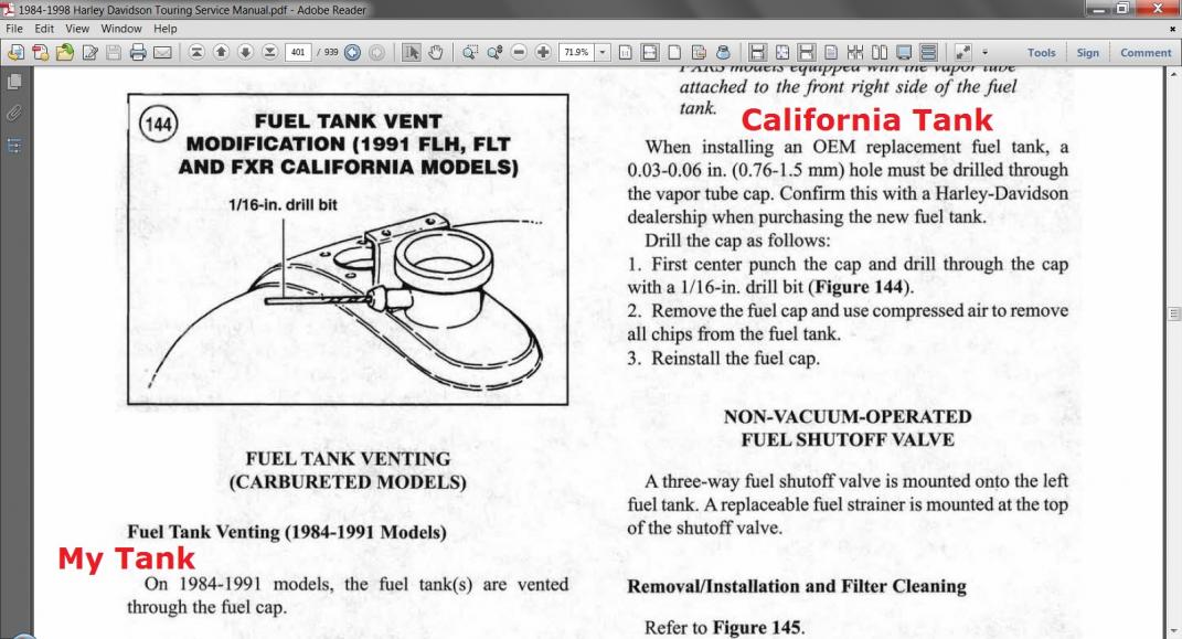

Here's a pic of a page right out of my service manual. The paragraph on the right explains the procedure for drilling out the vent tube on a new california model tank. I do believe I have a vent tube coming from the filler neck, and there is also one attached to the console. I don't think I have a california model. Do all of these have a vent tube anyways? Is this where the cap will vent to even if I don't have all the california vent valve and canister crap? If and when the cap vents open I can imagine the vented air being pushed out through this tube. Is this correct?
