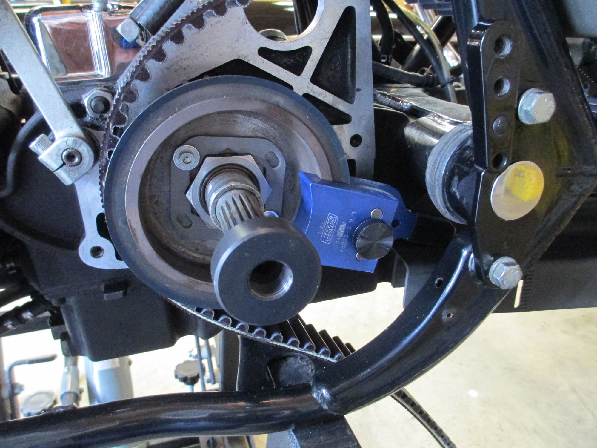

Sh*t. I hope that's not the case. As you know, to replace the drive belt, the entire primary needs to be removed. After installing the new belt, I even purchased the special tools to hold the sprocket in place and put the proper torque on the sprocket nut. At the time, the splines on the main drive gear and on the sprocket looked to be in good condition. I even replaced the lockplate. I made absolutely sure that everything was installed to the proper torque.

drm1978:
Make sure the shifter lever at the transmission is not loose on the shifter shaft.
When you replaced the belt, what did you replace along with it?
The main features of the upgraded pulley design are:
A pulley that is thicker in the spline area.
A shorter spacer with a larger outside diameter (shorter due to the increased thickness of the pulley, larger OD to decrease pulley wobble).
Lock plate.
It is not possible to tell from the pic what configuration you have installed, other than you have the new lock plate, but they came out before the pulley was redesigned.
Suggestion: rent a storage unit big enough to get the bike in and on a lift, your knees will thank you years down the road...

Dan89FLSTC - Other than expendable items like gaskets and locking tabs, I didn't replace anything other than the belt. Maybe that was a bad decision.
When I removed the inner primary cover and finally gained access to the sprocket, I found that the sprocket retaining nut was loose and the locking plate was still attached to the sprocket but it was in somewhat bad shape. See the "before" picture.
Maybe I should have questioned why the nut came loose, but I just bought a new nut and locking plate and used them for the re-installation. In hindsight, perhaps the sprocket was beginning to spin on the splines, but I don't recall any obvious damage on the main shaft or sprocket splines.
Not that it matters, but I acquired this bike from my wife's brother who passed away two years ago. It had been in storage for about 10 years prior to that. I have no service records. It's got roughly 46K miles on it.
