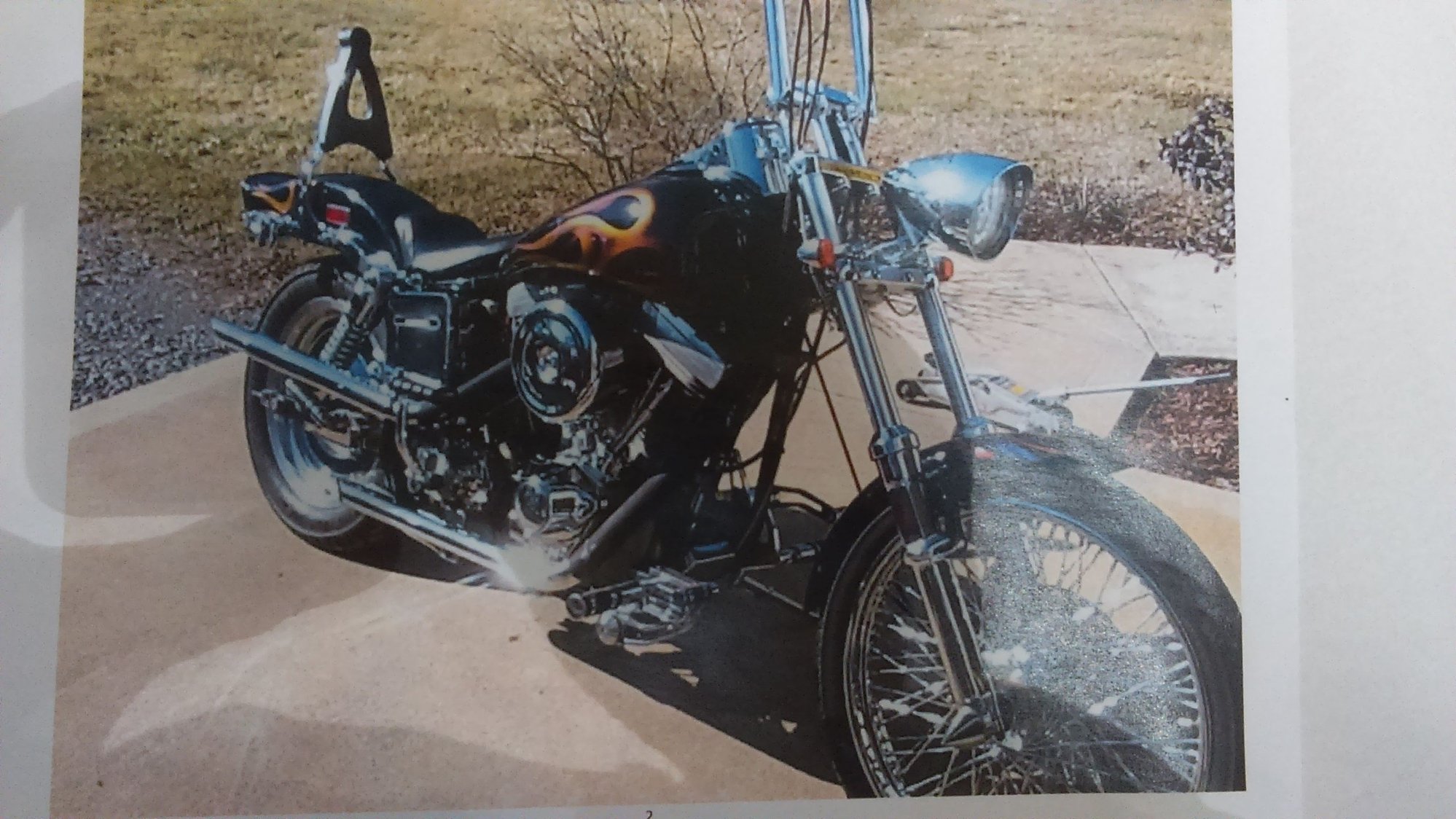

1986Fxwg

Looked like this when I bought it,needed help.

Nice save.
