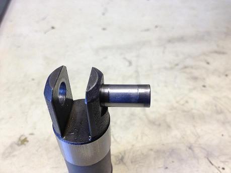

Couple years ago, I was changing the cam on a reman with 20k on it and found one lifter roller had more slack than the rest, the others were ok, you never know.
