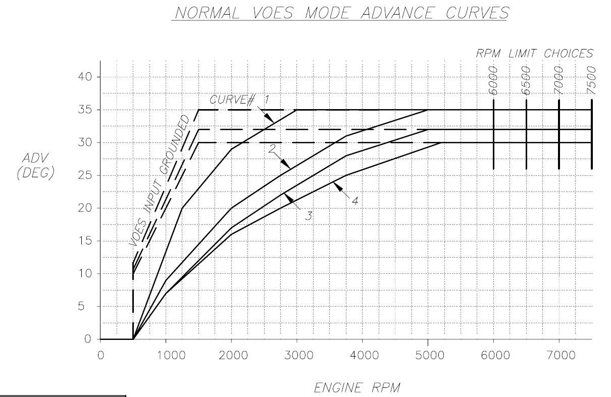

here is a graph for a dyna/ultima tell me again where is the 10 degree retard is. man its like kicking a dead dog. whats sad is you have admitted you sell these in your shop and have know idea how they work or even how to program one just look at the picture and read the directions it even states do not use the voes with a modified engine unless you know how to program the ignition.
if you guys want ill give a class on how to setup and program your dyna/ultima ignitions all you need is a laptop and a usb to serial cable and a copy of curvemaker by dyna corp. if you need a copy of the program ill send it to you.

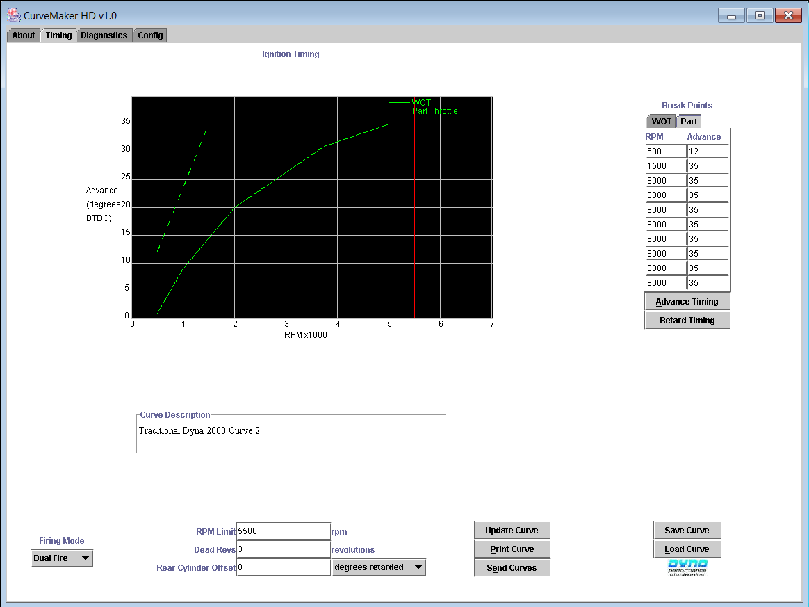

here is a screen shot of the program on my computer
