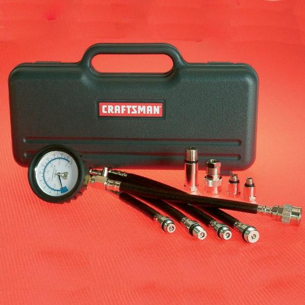

Red face Craftsman compression tool
This is a good compression tester from Craftsman. Not sure if it is a MIC tool, but it works good. Has all the pieces for testing compression on almost any vehicle.
