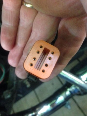

Funny you should ask for pictures as I took a few to look at to make sure I was getting the right connections. I was just reading Pothole914 post about crimping tools as well. anyway here are some pics if I can get them to work right, one is the male, one is the female that are on the bike and the one with both ends is what came on the Badlands.

Top one is eight pin Deutsch, bottom 10 pin multilock

The top 2 are the connector taken apart on the bike, the bottom one is both halves side by side that are on the badlands, here another pic of those.

That is for a twin can, I would call ask for one with Deutsch.

That will work, the picture is solid pin silver

Thanks for the help Harleycruiser. I sent the seller an email asking if they have Deutsch connections on a Badlands as well. That would fix it.

Yea that would be a better option, otherwise you will have to figure out which wire goes where, one skematic to the other. Ten pin to eight.
