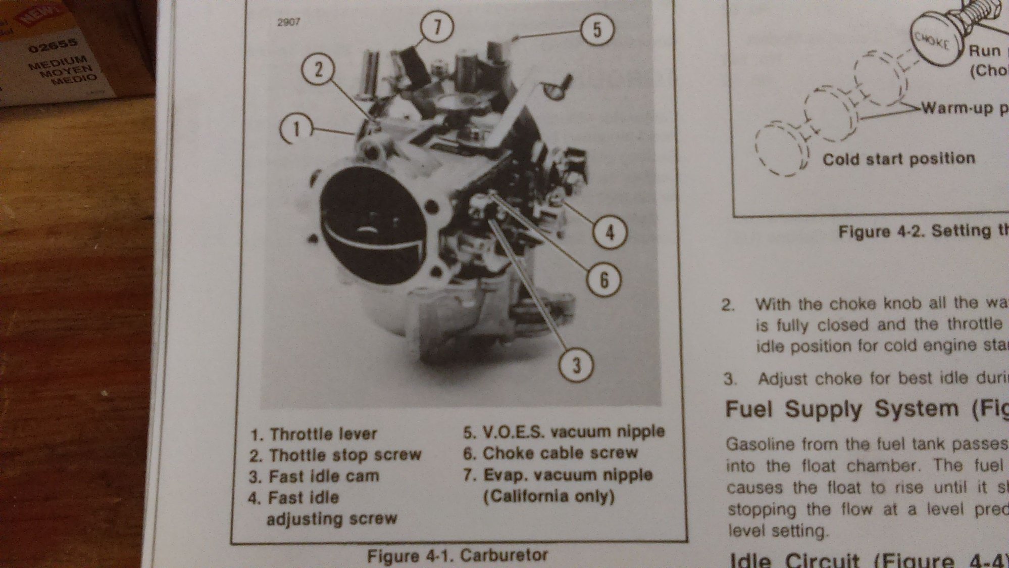

I got a 1989 flhs,it still has the stock carb on it,where exactly is the idle adjustment? When its warm it is idling at about 1300 rpm's.

I don't run a stock carb,but someone needs a repair manual !!!!

The pro staff will be along shortly.....
Old Jun 1, 2015 | 06:10 PM
glidein wide's Avatar
glidein wide
Joined: Jan 2015
Posts: 2,504
Likes: 150
From: ct
Old Jun 1, 2015 | 10:13 PM
89flhs's Avatar
89flhs
6th Gear
Joined: Jun 2015
Posts: 10
From: Indiana
Thanks glidein wide,much appreciated!
