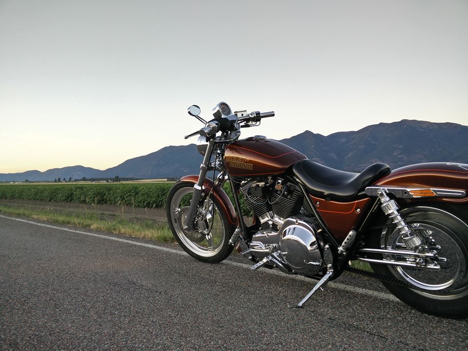

This is the last time I rode her, awesome sunset with nobody on the road with the Bob Marshall Jungle in the back ground.
