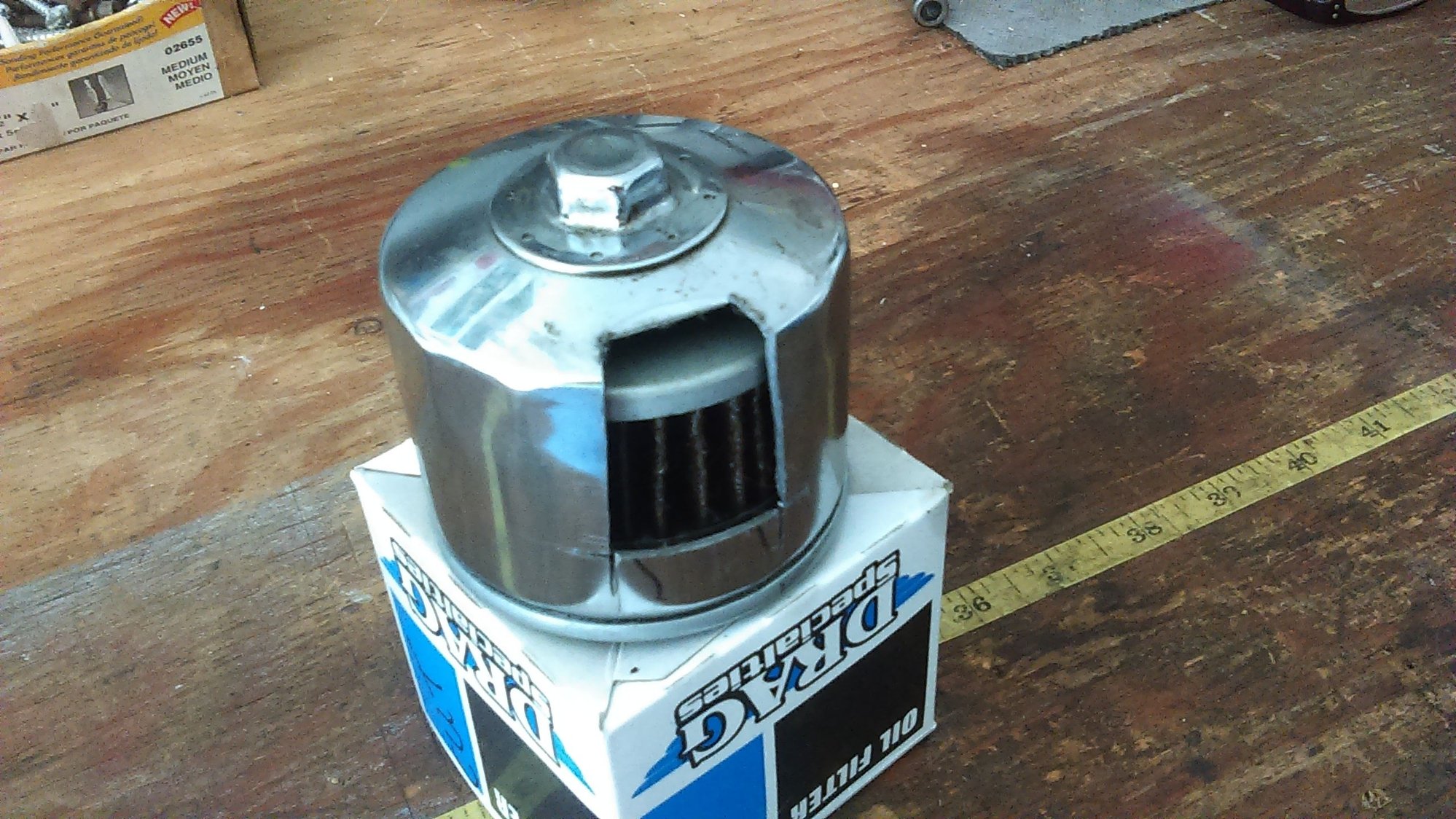

It's amazing how much longer my oil stays clean since I started running it with a cut filter, almost a half quart until clear, and my tank drains completely it's on the stand side .
What's a "cut filter?"
It's a filter with a hole cut into it so that when changing your oil you can get the used oil out of the crank case.

Mark the part facing down when hand tight and cut there , save for your oil changes. It's piece of mind for me knowing that I'm not adding fresh oil to half quart of dirty oil in the crankcase. I would prefer to add a drain to the case myself as the factory should have done.
