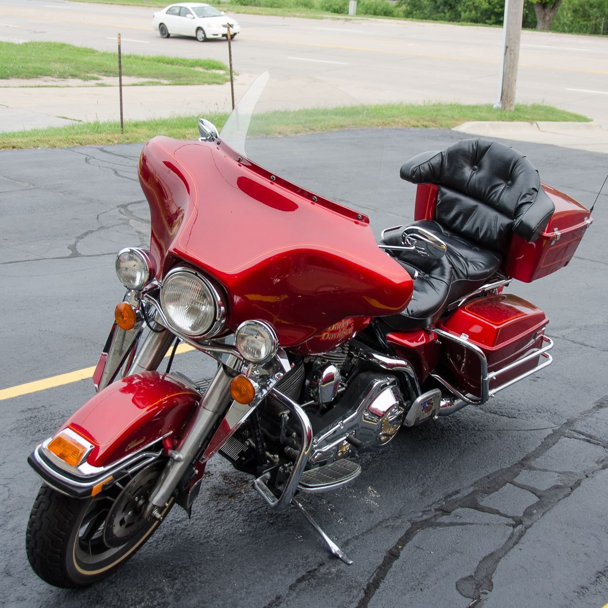

I totally understand about them growing on you, I just can't get over how nice mine runs now too, I've put about 2000 miles on it this summer and wow what a difference. Ours are almost the same.
Attached Thumbnails Some more Electra Glide odds and ends-0813151318b-1-.jpg

Lovely. I always wanted one with that "rag catcher" badge on the tank!
