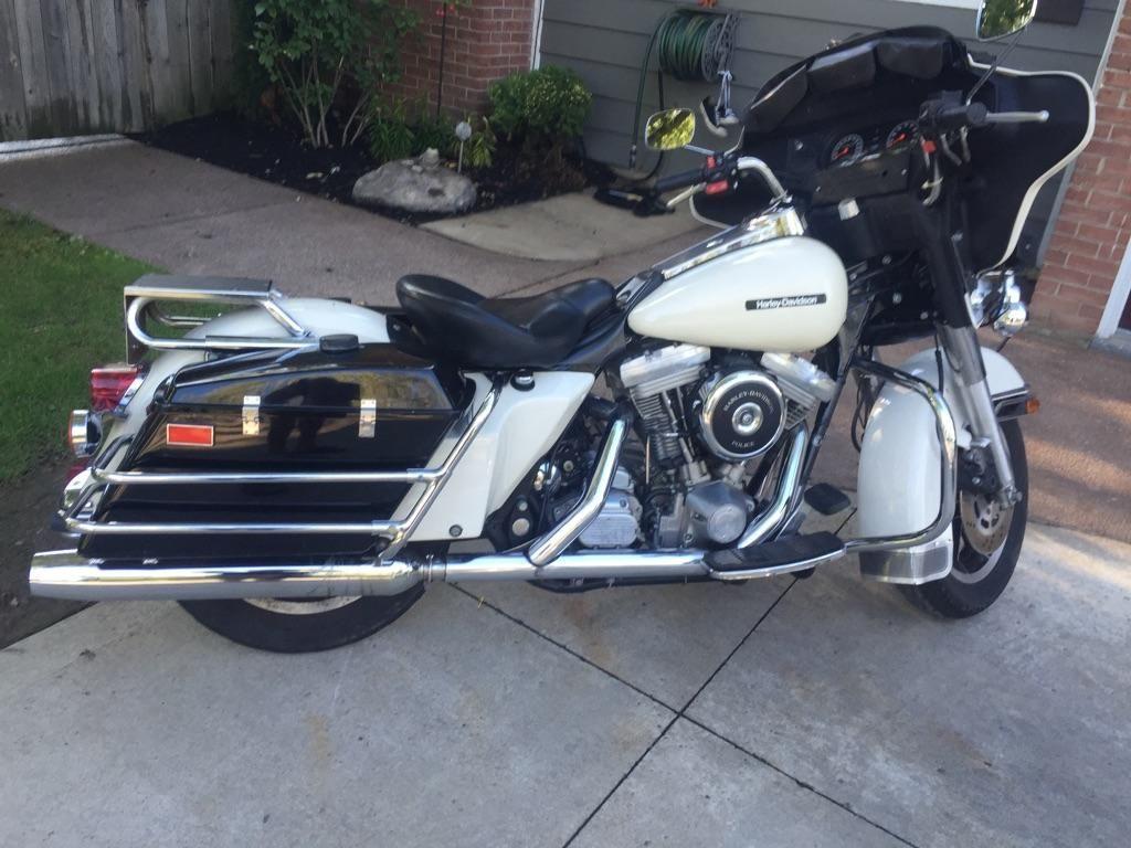

'91 FLHP
just finally got back on a hog... picked up a '91 FLHP. Nice bike, mostly stock (I even got the front red's and radio box), but has a few minor issues (gas gauge sticks, front turn signals don't flash but markers light, throttle grip seems to catch occasionally, and carb probably needs a rebuild..) - scored a complete (pivot cover/peg bracket/iso peg) set on ebay for $39 now looking to attack the carb.. so the question: my last Harley was an '02 FLSTF fuel injection, so I'm new(er) to Harley carbs.. the gas tank seems to have ALOT of suction when I open the gas cap, and when riding, the motor seems to hesitate or skip on occasion.. is this related? I also considered a sticky float. The bike only has 14,700 mi, and the previous owner didn't ride very often.. any suggestions are appreciated - and by the way, in trying to locate parts, why do the '91 FLH's seem not to exist? had a hell of a time... especially when I tried to search specifically for the FLHP....

I think you have a '91 FLHTP. From what I can see HD made a FLHTP and a FXRP in '91. You may already have a service manual but there is a Service Manual Supplement for the Police Models that gives info on the differences between the police model and civilian models. For example, the wiring and switches are different.
http://www.ebay.ie/itm/HARLEY-DAVIDS...-/261380951618
As for the suction from the gas tank, I would check to make sure that the vent line is clear. There are 2 lines, 1 is a drain if you spill gas on the dash, and the other should be the vent for the tank.
Good Luck with the bike. I have a '94 FLHTP (all white and stock) that I bought new off the dealer's floor 21 years ago. I mostly use it a my backup bike when my other bike has been in for repairs. I still enjoy it and it still runs real nice (73,000 miles). It looks very much like yours.
