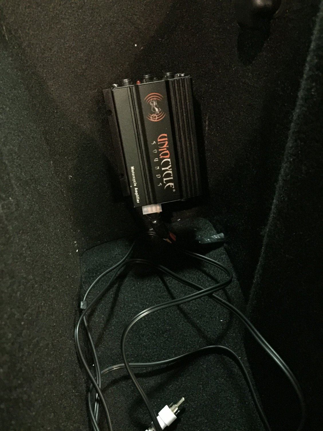

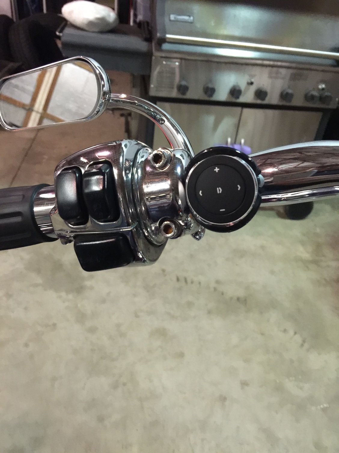

The speakers are from uniqcyclesounds and I wired the amp inside the saddlebag with a plug to quick remove. That way I can plug my phone into the amp and leave it in the saddlebag, I also have a Bluetooth iPhone remote on my handlebars to control it all. I will try to get some pics today to show it all better. The bars are 16" 1.25 Carlini gangster apes, I thought about going with 18" but with the DannyGray seat it sits perfect, the bars are at my shoulders.
