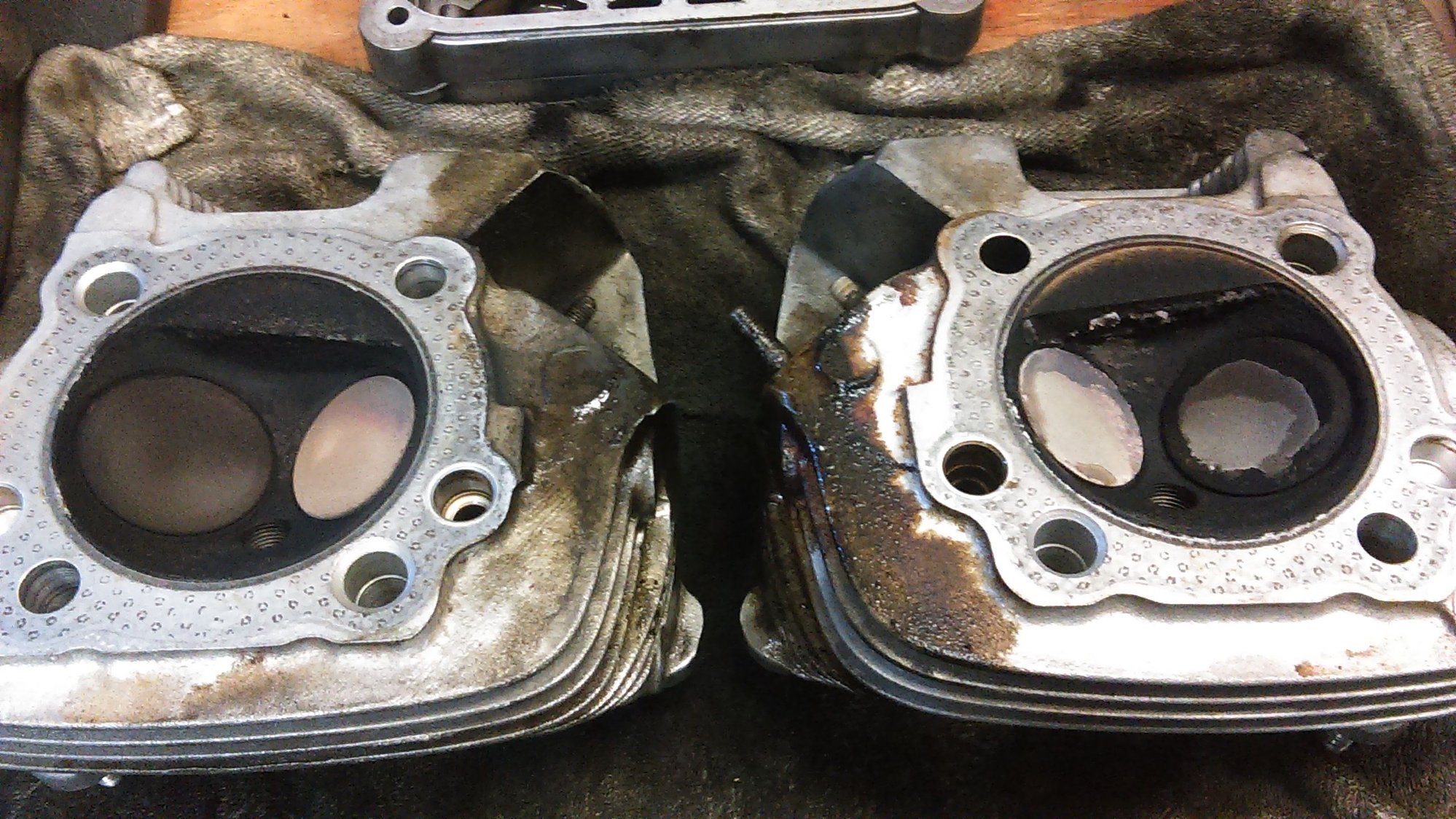

Old Nov 14, 2015 | 03:42 PM
glidein wide's Avatar
glidein wide
Joined: Jan 2015
Posts: 2,504
Likes: 150
From: ct
Here's the first snag, LOL, I can't find a 1/4" ,12 point socket ,1/4" drive anywhere to remove the torque bolts on the tappet blocks . Could only get some off with a box wrench .
Will need socket to torque it down anyway. I'll find one somewhere eventually...

Originally Posted by glidein wide
Clips made a burr, the book said they might, got them out, thanks man.
Base gaskets are peeling off by hand, lucky I guess, I little stuck to jugs.
Head gaskets say 60 on them and they measure over .050 thick , normal ?(old ones)
My head gaskets that came in the kit are .045, but I'll probably end up getting some .030s according to the reading I've been doing. I'll verify by measuring the squish as described in the other thread.
https://www.hdforums.com/forum/evo-c...l#post14571383
My bike always pinged on regular, and even with premium running anything but a super mild advance curve. Targetting a better squish should yield a better burn and make it more ping resistant.
