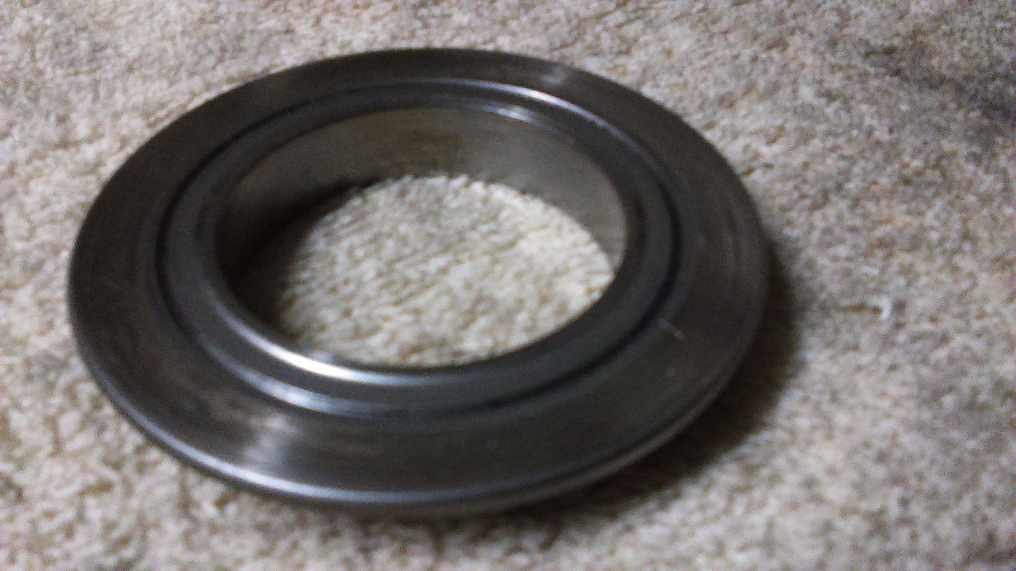

Some parts in today, main shaft race for inner primary bearing is a little taller, the rest is the same. Purchase bearing, seal and they said race required so I bought it even though mine was ok. Anyone swap this before ?? I'm thinking it won't be a problem unless it hit the clutch assembly here is pic....

it to me as I cant see the inside is a copy of the locking type but - as I said I cant see if its directional and it would have like a taper on the one end
if its just a straight tube its useless for what you need and like was said it may interfere with the hub locating on the spline correctly -- be careful with the china $hit they sell today
Not a tube,chamfer on one end for easy on. Remember, tapered shaft, not spline...

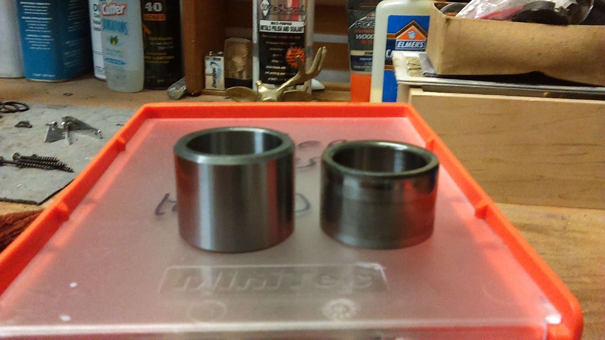

Well I measured the bushings in the rockers and the wear was 0.0012 and the limit is 0.0035 so we'll just leave well enough alone.
Main shaft race, I may just shave it down to the size of old one..

Does anybody know what the grove Is for on the back side of the main shaft spacer ?
This side faces the drive gear/bearing, there was black residue there before I cleaned it.
