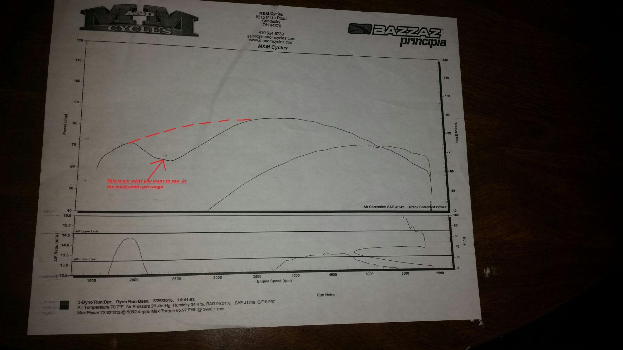

here is my dyno sheet
72.82 max hp @ 5092 rpm
85.97 max TQ @ 3988 rpm
Old Dec 8, 2015 | 09:44 AM

That needs work, tuning that big dip out would give you that power bump your looking for.
