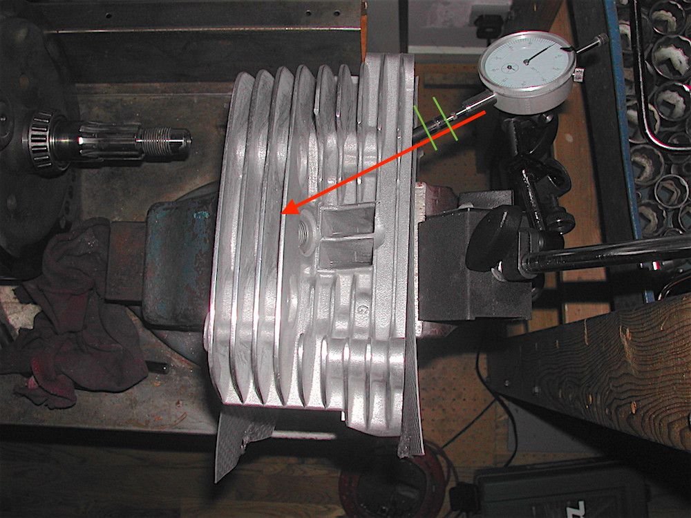

Here's a quick lash up you should be able to do at home. You don't need a gauge, you could use a caliper and get a good enough reading. Put a flat over the face of the head, and push the valve down until it hits. These heads have had a .050" skim and the valve hits at .240" lift. .240" less .060" is .180".
Now, the 27 does lift to I .182" and E .166" at TDC ... but remember, a) these have been skimmed and yours haven't, b) you need to add a 30 or 45 thou gasket, and c) your piston is likely 10 or 15 thou further down cylinder. Therefore, you have an additional 110 thou 'vertical' clearance. You can fake up gaskets/squish etc using feeler gauges or work it out geometrically as the angle of the valve travel is a known factor. It works out to be about ... 130 thou travel?
60 to 80 thou is a good clearance, so you have additional 70 safety margin ... without even notching the pistons. Therefore, I'd say you're safe to clay up the piston tops, reassemble the engine, and turn it over to see what it really says. Likely it will say the same.

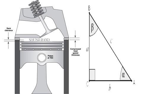

Here's how you work it out roughly enough to be safe (pedants note the disclaimer).
What's the angle b ... 27 or 31° (inlet or exhaust)? Angle c is 90°. Side a is; the thickness of your gasket +/- the distance up or down the cylinder your piston top is at TDC, e.g. 45 (gasket) + 15 (piston down the hole) = 60 thou.
Therefore, side c - the amount of additional travel you have - is 70 thou.
Add that 70 thou - which is more than the amount of advisable clearance - to the distance we measured above (where the valve hits the metal rule).
So, what is that now ... 0.280" plus 0.070" = 0.350"? (an example, not his actual figure - without piston cut outs).
All we needed was 0.240", so where's the problem? There are other little considerations, but that's detail enough for just now.
