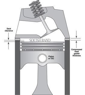

Originally Posted by glidein wide
You said yourself pistons need valve relief for the 27 cam.
No, I don't say that. I would not do so unless I knew it to be true. Part of knowing it to be true, would be knowing the measurements. I say it's mathematically impossible, without some other factor being involved.
What I found ... and pointed out/corrected myself ... was that it was just a general disclaimer for *all* cams copy and pasted from a reseller of a resellers' catalog. And, as I said earlier, you can't trust them, and should not be worried by them into spending what you don't need to.
Choosing 9.5:1 or 10:1 pistons (or even higher), and setting the squish tighter, wont make it harder to start. Quite the opposite, it'll make it nice and crisp, reduce any tendency to detonation or premature combustion, and limit carbon build up. It will add efficiency and performance.
You also won't be running at whatever the published piston compression level is (so don't freak), you'll be running *at least* 1 point below because of a number of factors,
a) your deck height/loose squish,
b) the size of your combustion chamber, and
c) your cam's timing (link) ...
Again, get a second opinion from Scott (and I'll bill him for sales pitch), i.e. if you put in 10:1 pistons, you'll probably be getting a real world 8.8:1, which is just modest and healthy. (Stock is meant to be 8.5:1 ... but never is).
How and what to measure ...
Firstly the Piston Deck Height; the distance between the piston top and the top of the cylinders (just don't use bare metal grips on the shaft like those guys are! Wrap it). If the pistons are below the top of the cylinder, which I bet they are, you have nothing to worry about.
Assemble the cylinders using whatever base gaskets you have ... is it 10 thou? ... and torque down to spec. Place a flat edge across the top and turn the engine around to TDC. Measure the gap using feeler guages or a guage. If you get that far, I'll give you other hints of what to do.
My guess is you've got a 15 thou base gakset, and it's going to be more than 15 thou down the hole.
Then check valve travel to see and satisfy yourself. This way you will learn, save money, and end up with a better bike. Do you have a dial guage or caliper?
Stick the valves in the guides, move them the TDC lift given about, measure the distance between the cylinder head face and the lip of the valve. Again, hints on howto available.
Lastly, consider measuring your combustion chamber (and then we will remove all fears about compression ratios). Rough is good enough for this level of work, e.g. using a measured syringe. My guess is it's going to be 82 cc or more, i.e. low compression. You're probably running at less than 8:1 at present.
Using the calculator linked to, and putting in the stock figures you say you have, using an EV27 will give you corrected compression figure of 7.65:1 and Cold Cranking Compression (CCC) of 150 psi ... which is road kill poor.
Adding 12ccs to the Piston Dome Volume, which is approximately what a 10:1 does, you get 8.77:1 and 180 psi, which is OK. Sticking in a 30 thou head gasket (setting the squish to, say, 35 thou) takes you up to 9.1:1. Still hardly "killer" levels. I'd say, "just nice".
(11:1 pistons equal, say, 9.91:1 ... that's about idea from a performance level, but ask John or Scott's advice about CCC at that level. I'd say it was too high for every day use).

Thanks for the diagram, I can do this with some measuring instruments at work, I didn't mic the base gaskets yet(James kit).
My biggest concern is figuring out how to make a spring compressor.
All this is being done completed with rings and fully torqued?
Won't ruin the gaskets if I need to disassemble it.???
