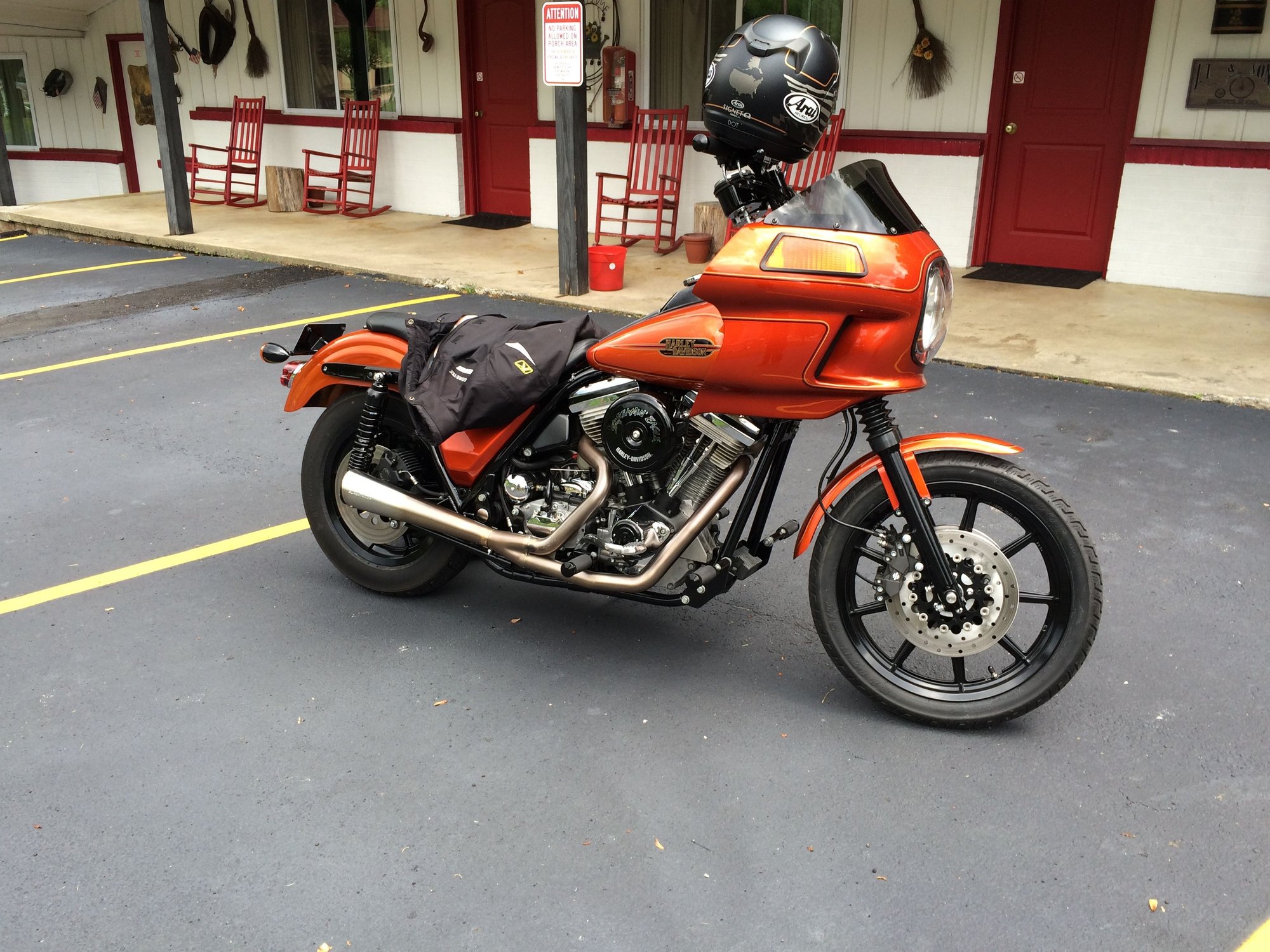

Upgrading the braking system is always a good thing to do. On my '85 FXRC I went with XR1200 calipers.
Jim

XR1200 calipers look good as well! Are they a bolt-on upgrade? 11.5" rotor?
Better performance?

I used the legs from an FXDX 2000-2005 and the XR calipers were direct bolt on, with HD floating rotors. Awesome front brakes now.
Jim

Thanks Jim. Very nice FXR!
I take it that you upgraded to the adjustable cartridge type legs. What is your opinion of their performance?

I really like the full adjustability of them. I also have an '02 FXDXT with that front end and same XR calipers.
Jim
