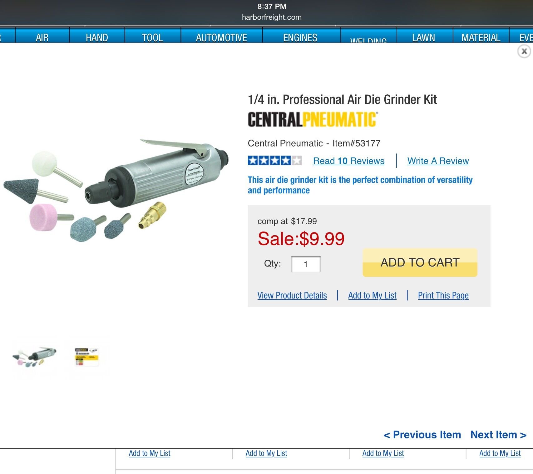

Posts: 2,747
Likes: 419
From: Vermont
Something like this or a dremel. Will finish it up
