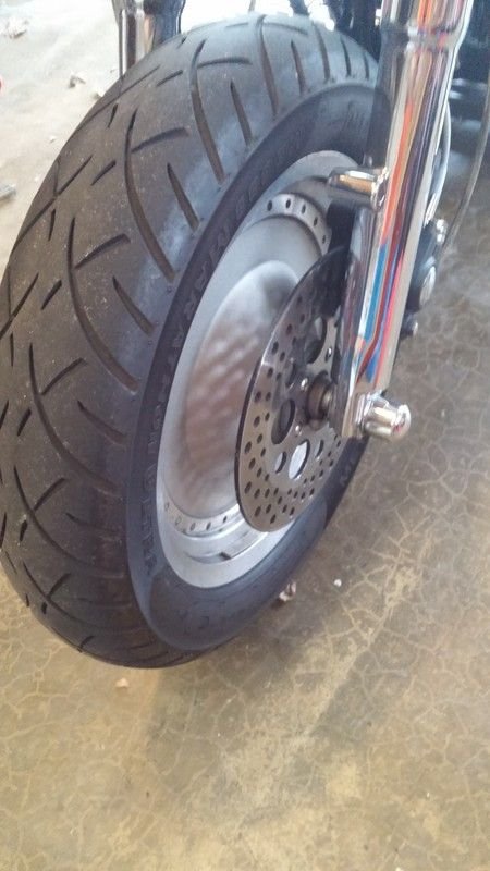

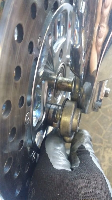

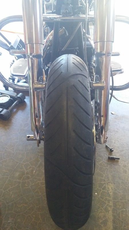

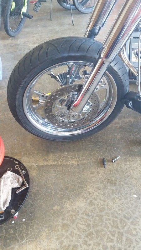

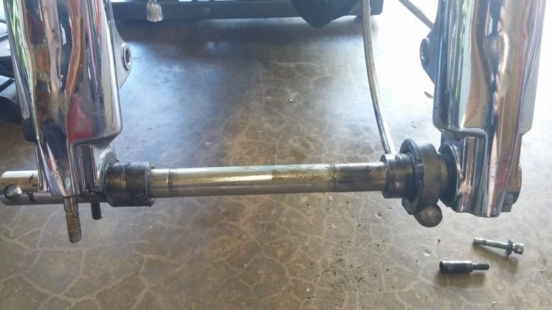

Well I guess its safe to say I am the proud owner of 1996 Frankenfatboy. This bike has had so much done to it I really dont know what im getting into half the time. I am trying to ditch the stock (sorta stock) fatboy front rim and really need to figure out what I need while I have it apart. First off someone has added dual disk to the front and to do that changed the lowers to something that used a front wheel drive speedo, all good but not when I bought a wheel off a 97 Fatboy that wont work. Heres some pics of what im dealing with.

I really dont like the new wheel anyways, looks too much like a chopper with it. Id like to get something I do like but dont know what I need? How would I messure and what? Want to get this figured out so I dont get the wrong wheel again so any help would be great.

Are you sure you got a '97 FB wheel??
From what I can see it has sealed bearings and the '97 didn't come with that.

After thinking about it a little more they changed more than your lowers.
If you have spacers behind your rotors they had to have changed your trees too.

It's not really the shaft that is a problem it is the OD of the hole in the wheel where the bearing goes.
Do you have a micrometer?
If so you can measure the hole diameter and that will tell you if you can put the stock bearings in there.
I think others have gone to a bearing shop to get the tapered (timken) bearings they needed to adapt a 2000+ wheel (what I think you have) to go on our older bikes.
You will also have to adjust the center spacer and set end play on that wheel if you go to tapered bearings.
If I remember right Harley used the 3/4" axle up until '06 but I'm not sure on that one.

Ok sorry I read what you wrote again and understand the Timken (tapered) bearings were used on the older bikes and the sealed bearings were used later. So I need to find wheel for 3/4 axle and Timken bearings correct? And need to figure out what will fit between the forks without too much trouble.

Correct for that part.
Using the spacers makes me think they just used a stock FB wheel and spacered it to fit the trees.
