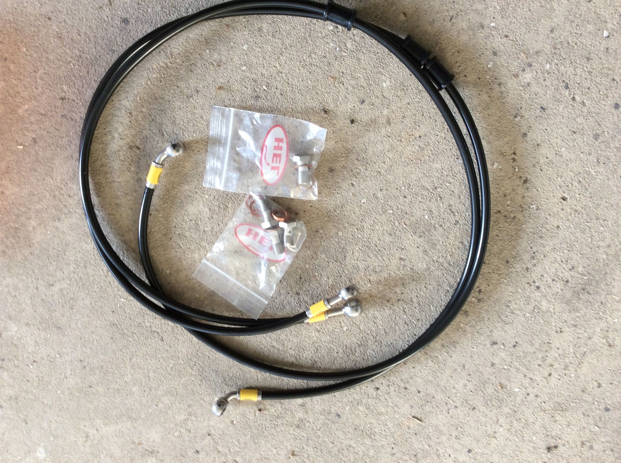

They are identical with one being longer than the other and one has two rubbers and the other has one.

What are you going to do about the rear brake light switch?

Myself, I'd leave the steel line to the switch and swap the rubber for braided. ps. I say this because the steel line has no expansion to help in brake performance. Brake pressure will expand a line. There was a big difference when I swapped the rubber caliper lines on the front of my old Camaro for braided lines.

Unless you have someone put a joint in the steel line there isn't a way to just replace the rubber portion of the rear line.

On a '95 Heritage the brake light switch is built into the steel line.
The steel line goes from the master cylinder to just past the switch then it turns into a rubber line to go out the swing arm to the caliper.
There are no joints in the brake line except where it connects at either end.

That is the first time I had the lines out of the package and I never got started on the upgrade for various reasons. I was surprised by all of this today.

I don't know how long you have had them but you might consider returning them because I don't think even the one they sent you for the front is right.
My front had a 90° fitting on the bottom and a flat one on top.
The lines you have both look to have 45° fittings on one and and the other is straight which is right for the rear but not for the front.
