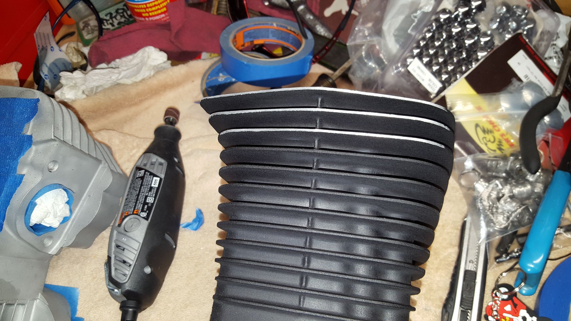

Ordered the Wiseco 10 to 1 stock size pistons, should be here in the next few days.
How do you paint the jugs and leave the outer edge unpainted?
Old Jul 5, 2016 | 11:14 PM
Owtlaw's Avatar
Owtlaw
Joined: Oct 2011
Posts: 1,376
Likes: 36
From: Round Rock, TX
With a dremel.
