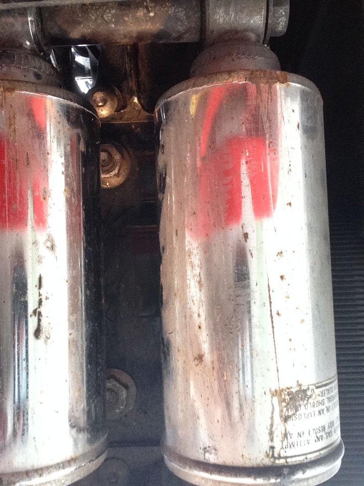

My service manual has no instructions for a granny fluid change.
I google and it says the drain bolt is located between the 3 shocks on the softsil evo'S
I am attaching a picture , not sure which is a drain plug? Neither looks like one and they are very inaccessible.
Any help is appreciated

The transmission drain plug is not on the bottom of the transmission on an Evo Softail...
The drain plug is on the right side of the transmission, just below the chrome cover...

Okay I just discovered it's the torx screw on the side not anything underneath. Not sure why the service manual has nothing on this???

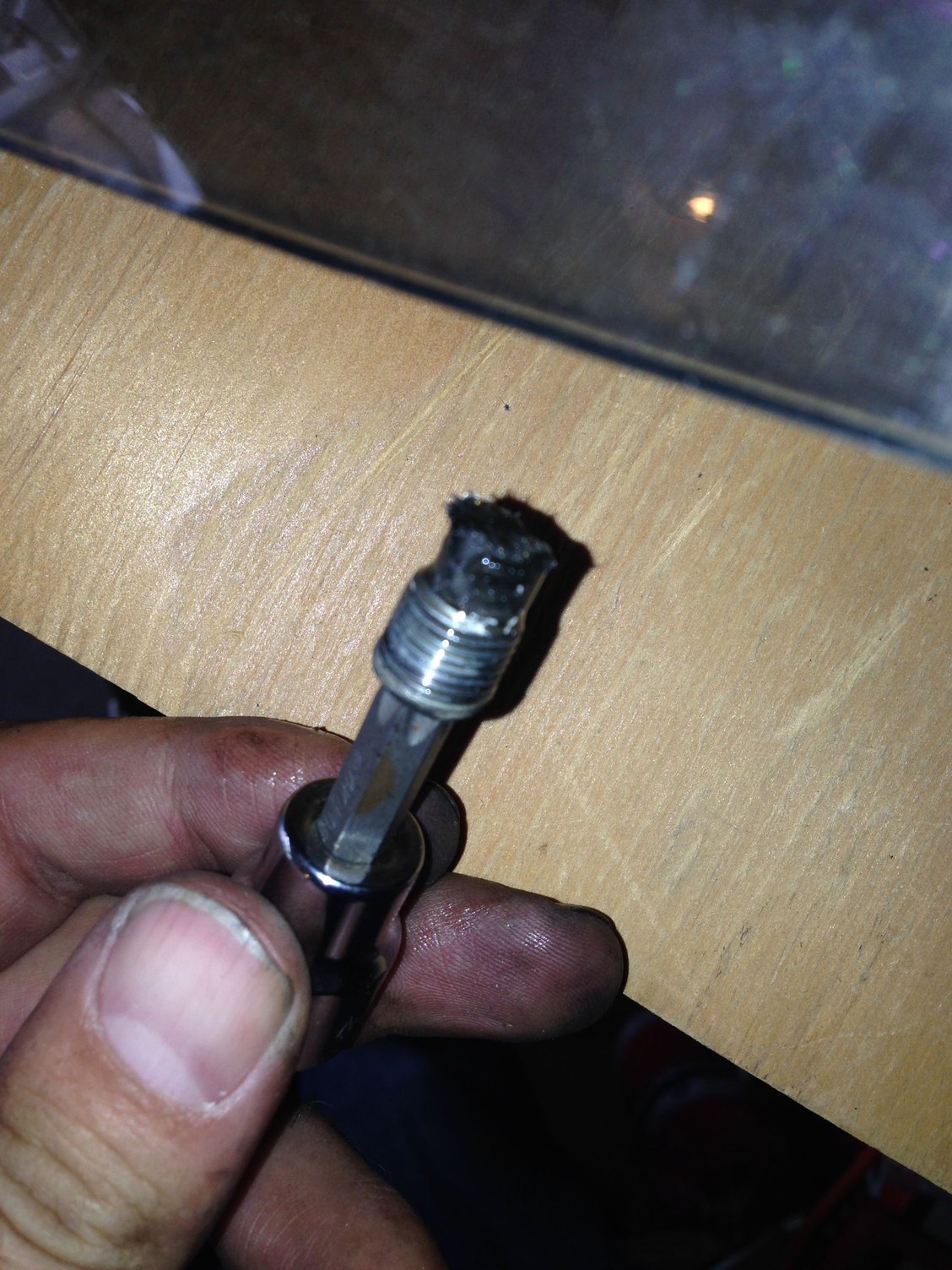

Okay what oil should I put in here.. It's a 96 with about 40,000 miles
Also not sure how much metal is normal on the magnet but I took a few pictures before cleaning

OK. Great. I know the factory service manual doesn't have details on everything, because it's mainly written for mechanics and not shade tree guys like us. But, if you look under the Transmission chapter at the exploded picture of the case, you can see where the drain plug is. I bet the Clymer's manual would have more pictures, but H-D manual is the most reliable one for torque spec, etc...
1. Your oil shavings is relative to when the last time you changed that tranny oil. If it was recent, then I would worry a bit, especially if you have noise or some tranny issue. It could be that they are shavings accumulated from thousands of miles. Could also be dependent on how you ride your bike too. So, when was the last time the tranny oil was changed? If you aren't having any issues, I'd clean it up and refill. The Harley 5-speed tranny are pretty solid stuff.
2. I put gear oil in my tranny. Specifically, synthetic or non-synthetic 75W90 in any brand. You can't go wrong with H-D tranny oil either. I personally run Mobil 1 Synthetic 75W90 bought at Walmart. That's just me.
