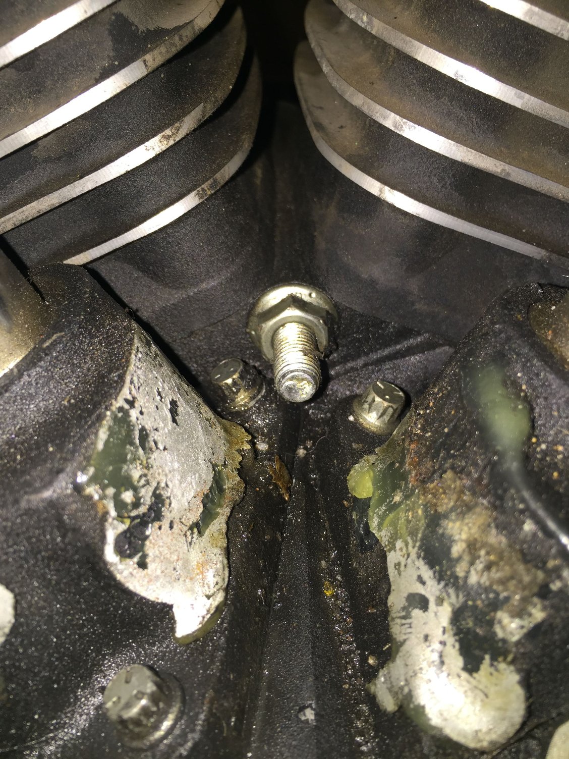

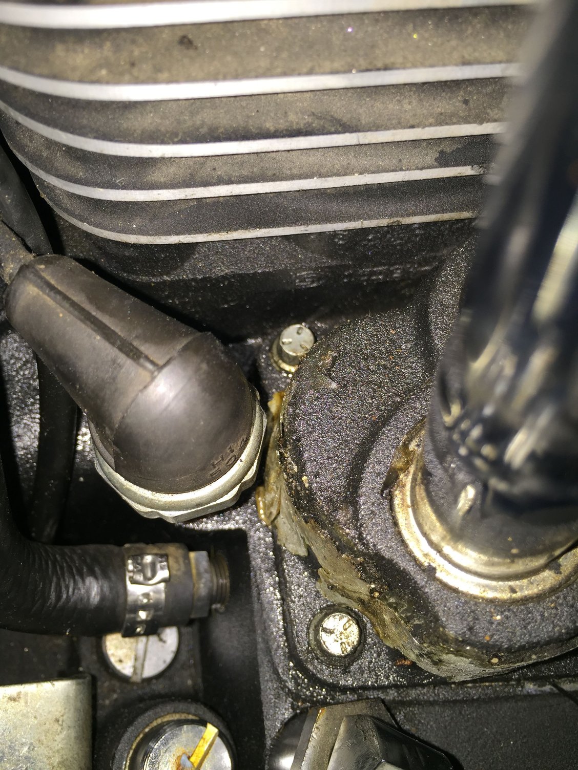

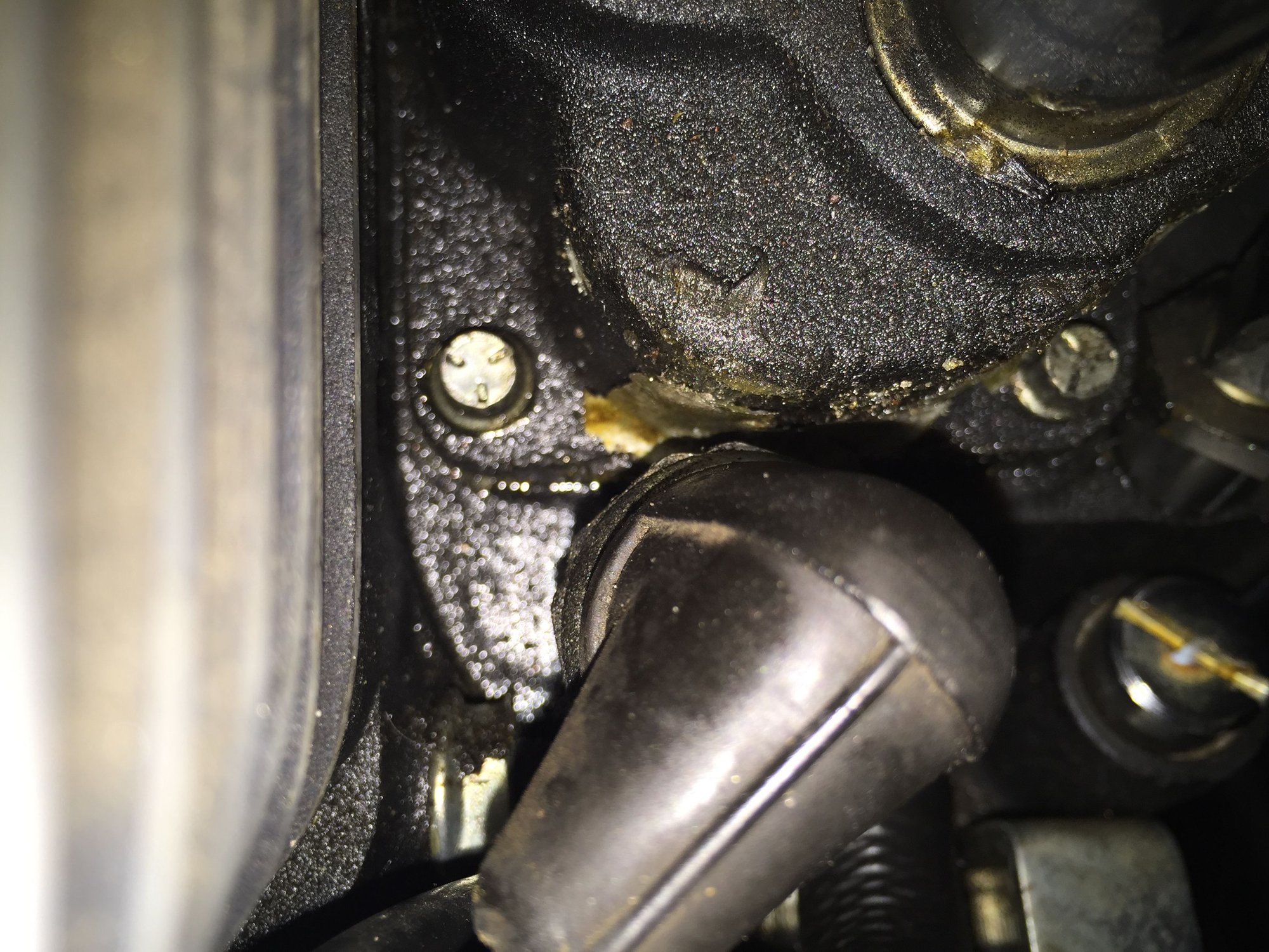

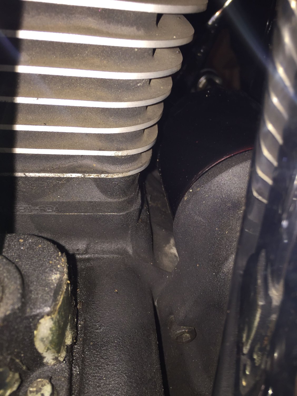

I got a few more pictures after I cleaned everything up and removed the covers. In front of the front block between the oil filter and the engine is clean, between the two blocks is nasty, and after the rear block between the engine and trans is wet. the towers are dry.
Also, the top of the blocks seem pretty dry, but it's hard looking around all the glue that was holding the covers on. It's mainly the base of the blocks and a little up that is oily.

From what I can gather you have already cut out the pushrods or could you remove the covers while leaving the pushrods in place?
If you had to remove the pushrods to get the covers off then you might as well change all the o-rings, gaskets, and what the hell since you are there change the lifters, cam and cam bearing as well.
If you didn't have to remove the pushrods you can still clean the motor and find your leak.
Have you checked the lifter block bolts for tension?
In other words are any of them loose?
If I were you I'd leave the covers off as they make finding and fixing a problem that much harder.
