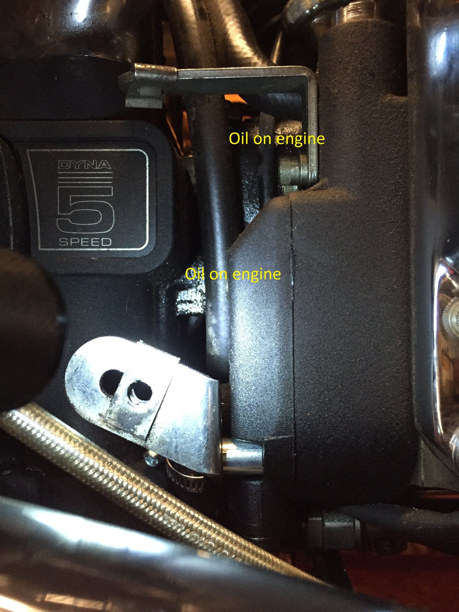

So I could have sworn I had a inner primary leak, went through and replaced all the seals, as well as the main, quad, and 5th gear seal on the transmission. Got everything back together and went for a ride, still leaking....

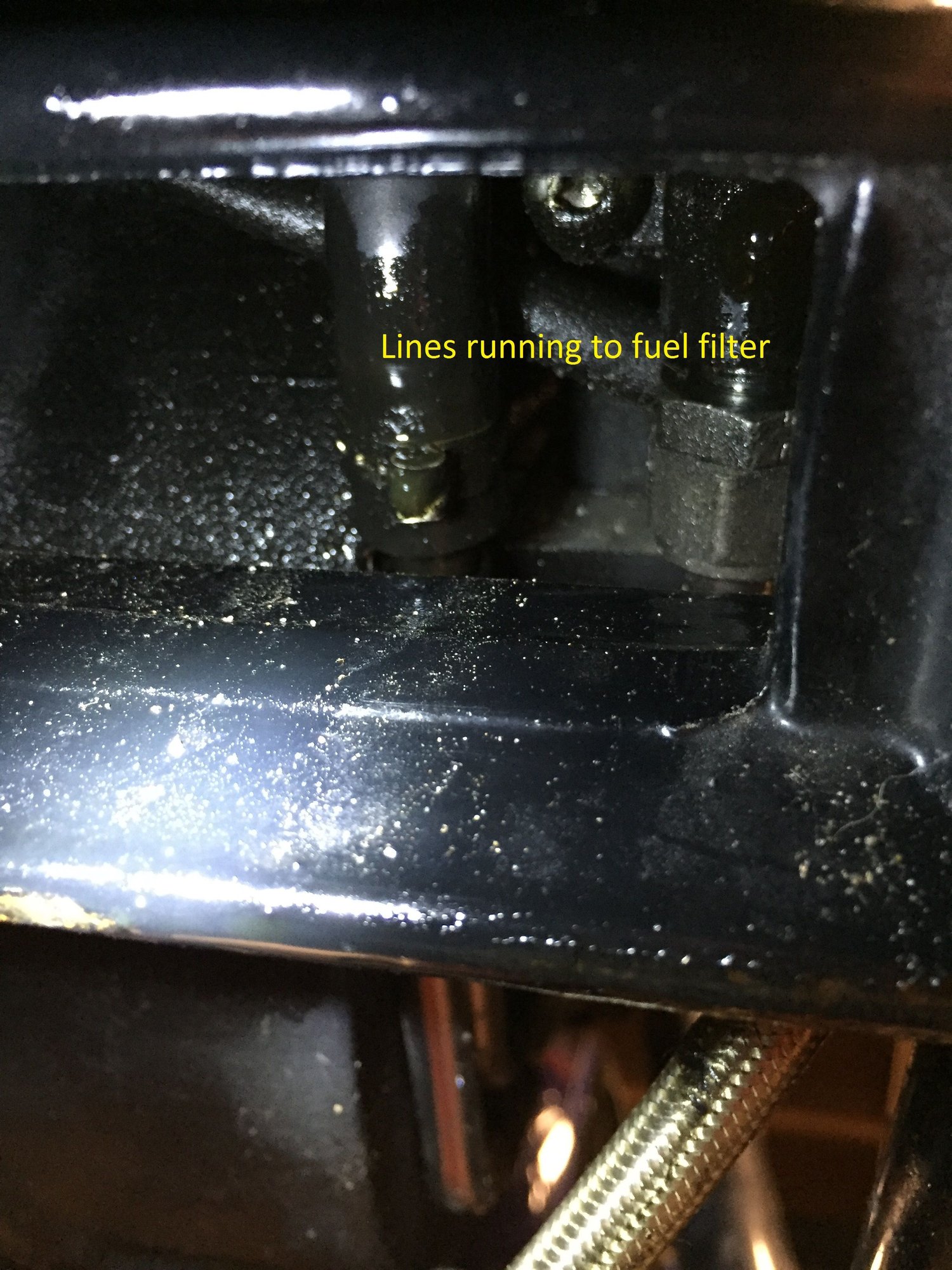

Since everything was cleaned up from the rebuild, I went back through and started looking again. I found oil that almost looks like it's coming out from under the pushrod covers, leaking down the the side of the engine where the lines from the oil filter just happen to touch the engine, and take that path to the bottom of the bike.
Is it possible for oil to leak from these covers? I'm getting probably a tablespoon of oil leaking every time I park after a ride.
**These are the lines running to the oil filter, not fuel filter....**

FWIW, my front lifter block worked its way loose a while back. Leaked like the devil.
Snugged up the bolts (both blocks) and discovered three of the bolts were seriously loose. One took a good half turn to get to spec, the other two a good quarter turn+. Been fine since.
Yes.
Look for the highest and most forward wet spot and that is most likely your leak.
Or you can do as Beemervet said and be sure about where the leak is coming from.

It's either the lower pushrods seal or the lifter block gasket from the look of your pics

Thanks all! I think for sure that's where my leakis, I'm not doing the job twice so I'm going to go ahead and replace the blocks themselves, plus I want to replace those cheasy chrome covers.
