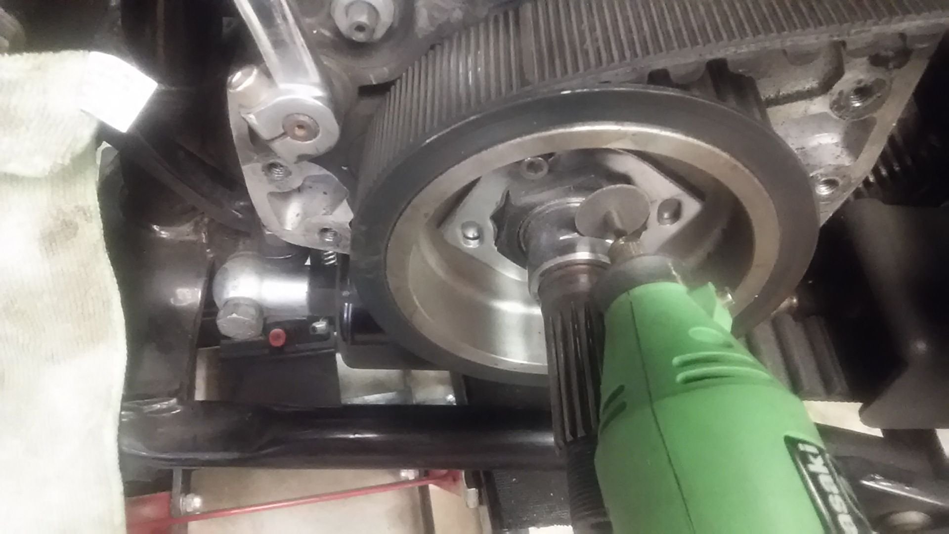

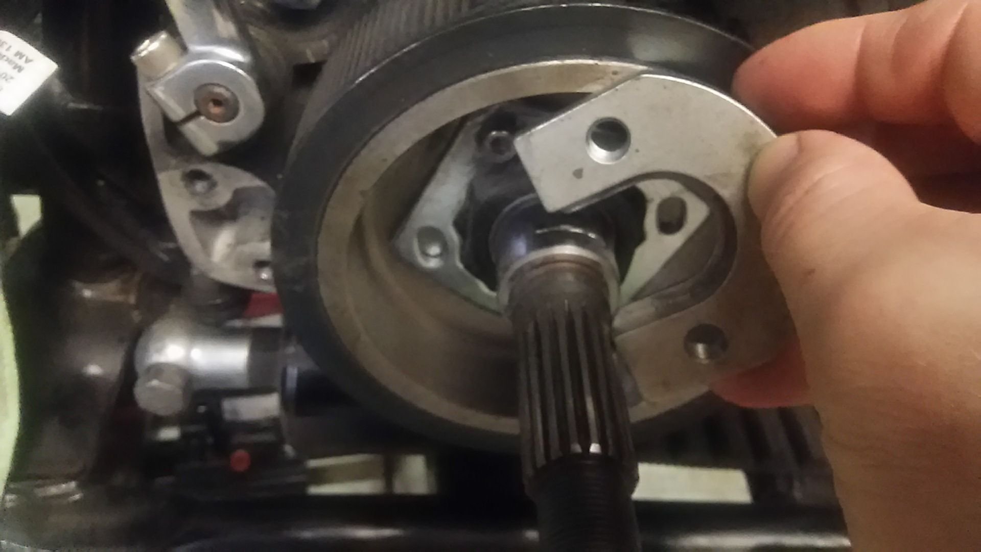

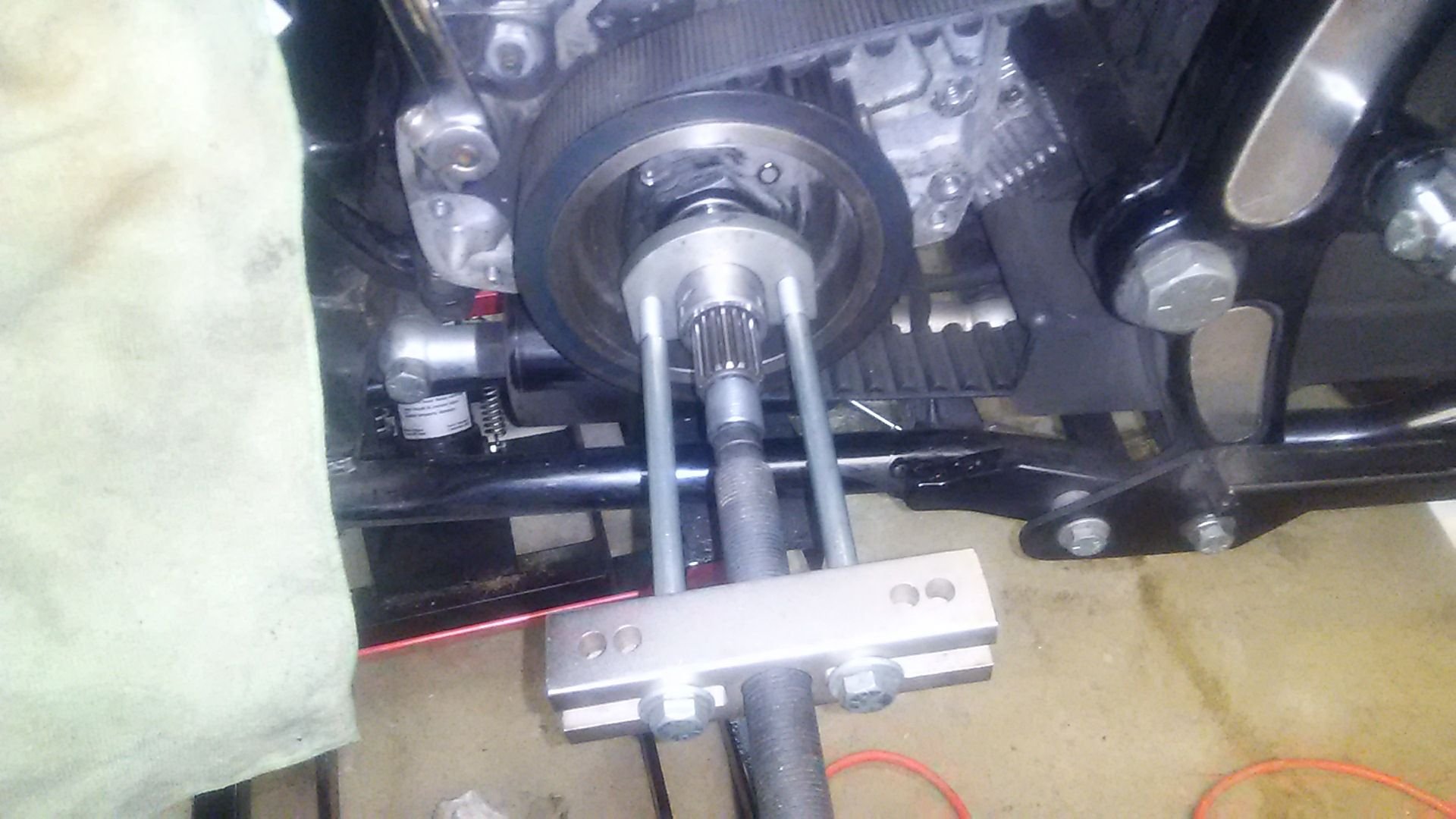

I just grooved it and used my puller, worked fine, and definitely better than pounding on it even though that sounded fun haha

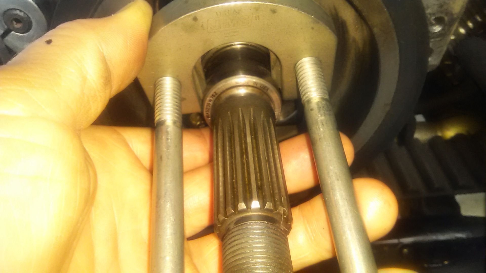

held it in place in the grooves I cut, and just slowly backed it out enough to get behind it. I sprayed it with lube to help it slide easier

It came off easy at this point
That's the way I was trying to tell you the harley Mechanic (and yes he was a mechanic and not a tech!!!) did mine.

Nice work Panheader, a steady hand beats a hammer every time.
