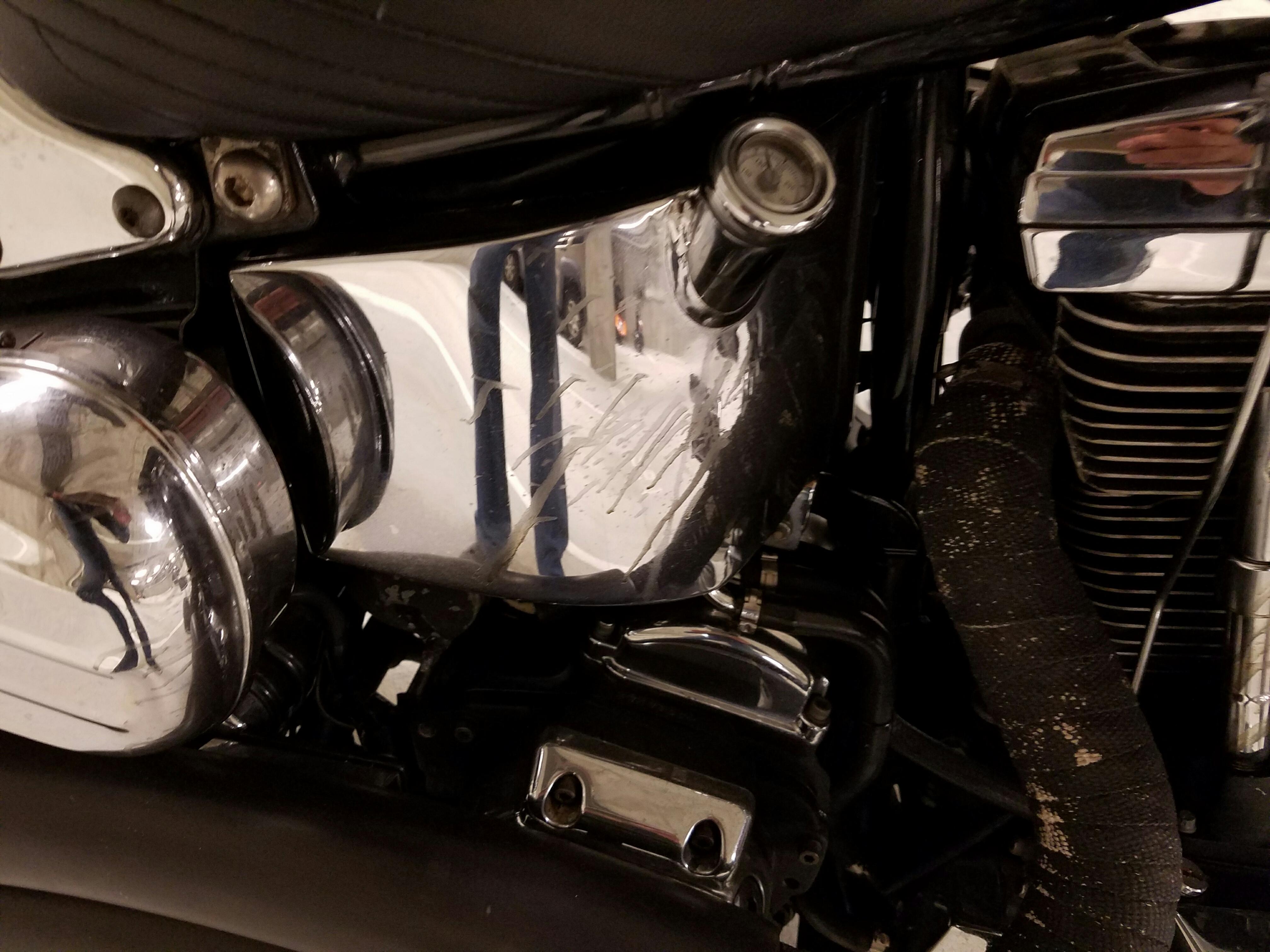

I'm glad you posted this, I was riding and parked at work and I noticed some oil on the tank. Looked at my pant leg and it was dry. Hmmmmm
I will check the heads and their breather bolts. I have a super-E and just run a 3/8" gas line to the ground. I'm a Flippin rebel!
Sorry this don't help you, OP, but it gives me an idea what to check.
Tom
